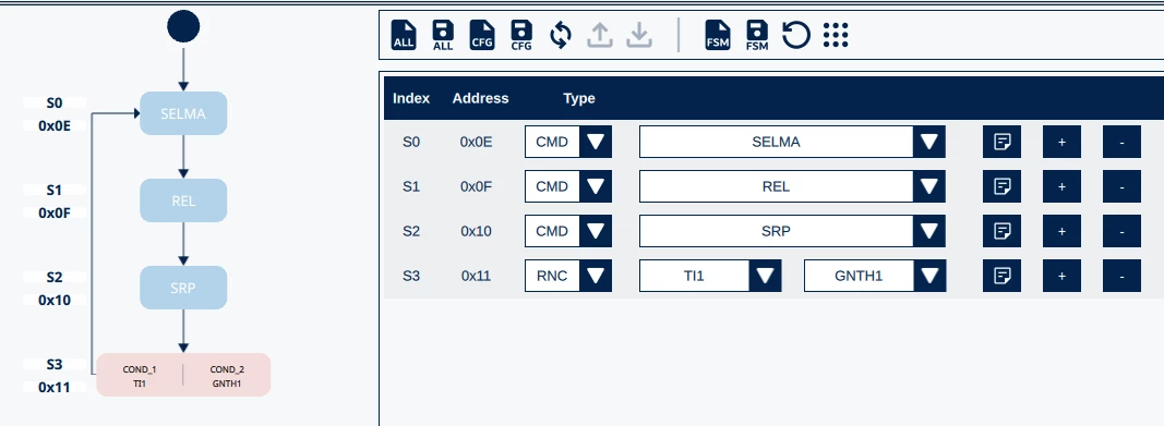

I'm working on project with LSM6DSO and I use FSM.
For easier programming I use the FSM Feature in MEMS studio, but it looks like it's buggy:
1 - SRP doesn't change the graphical diagram of FSM. It always point to start of the program on RNC.
Example: image.png

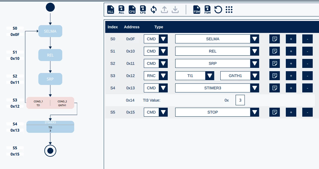

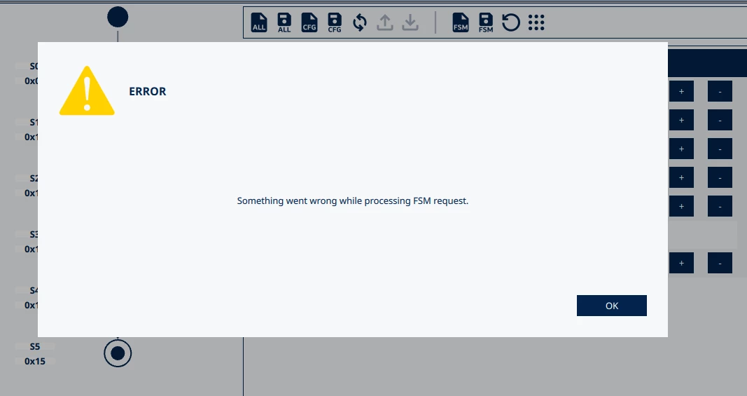

2 - Adding STIMER3/4 lead to error when I try to export the register config (save device configuration as):
There are also missing settings from the Fixed Data section (CONFIG_A, CONFIG_B, SETTINGS) which could be important.

Hi @Bennny ,
SRP is updated at runtime therefore the only way to see reset pointer updating is performing FSM debug using a log.
We identified an issue in FSM configuration, we will fix it in next release. We will provide visibility of fixed data parameters in next version.
