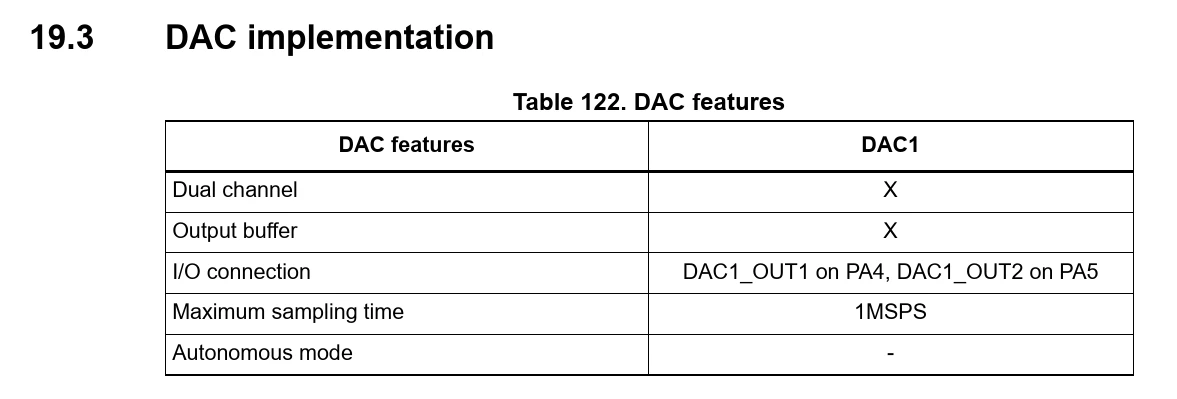

Ok, no audio-dac , but you have also the on chip dac , 2 x 12 bit.
I would try this to test the audio signal.
here:
on "Arduino connector" :
To use it, you have to modify the xx.ioc file, set PA4 + 5 : unused, then activate dac.
Then can see on a scope, what signal you producing or connect an amp, to listen...

to send the sampels on uart (16k x 32bit ->) need 1Mbit serial...what you use now ?
to hear it, i would connect an dac, maybe a old audio dac like TDA1387, or send data to on chip dac, for a test is the most easy - and you can hear, what comes out. (I am not sure - but most stm cpu have a 12bit dac )
And check with a scope.

Thank you for your answer ! I don't have any audio dac around me so it's will be difficult. I've tried to find solutions related to the DAC but I'm still looking for a way. Do you have an easy or inexpensive solution or do I have to use an external module?
(And for the sample on UART, you are right, as the comment on Octave, i have one 230400 bauds. I think it's not the best solution).
