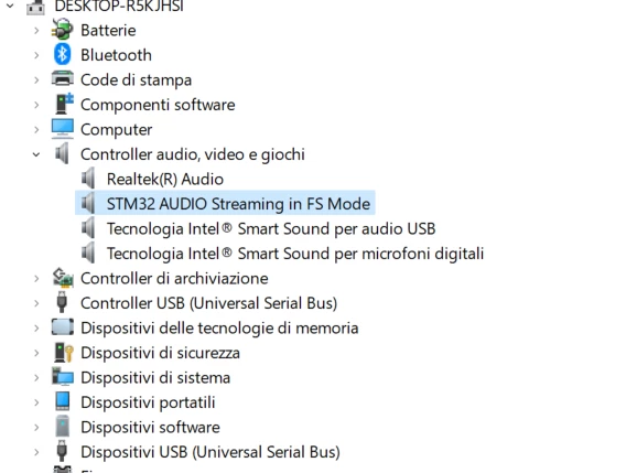

Thank you Eleon,
After uninstalling the driver, unplugging CCA02M2 board, restarting pc, and plugging it again, the driver is being installed and the board appears in the device list

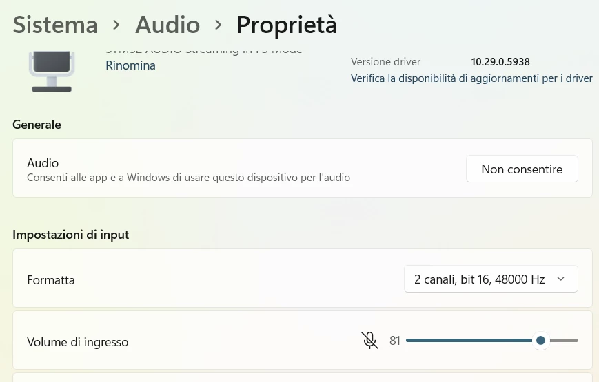

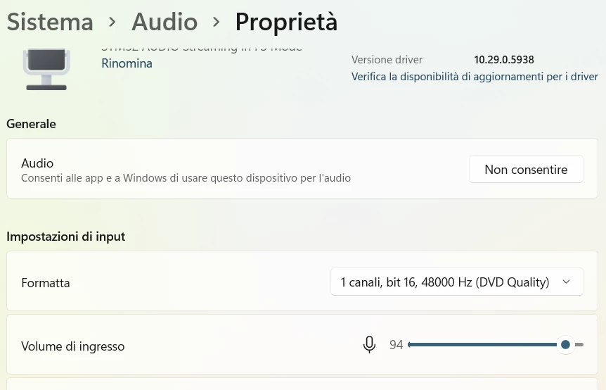

0693W00000GWyFEQA1.pngThe sound is not anyway acquired by Audacity until I do not enable the microphone into the System-Audio-Properties app
If I download into the board the F401RE_CCA02M2_1ch_48KHz.bin binary file and follow this procedure, no sound is acquired, even if the one-channel option appears in the properties down menu and I enable the sound menu.
It seems that works only using 2 channels.
0693W00000GWyMeQAL.pngI didn't change jumper settings on the board (paragraph 3.3.3.2 in UM 1901) in these two cases.

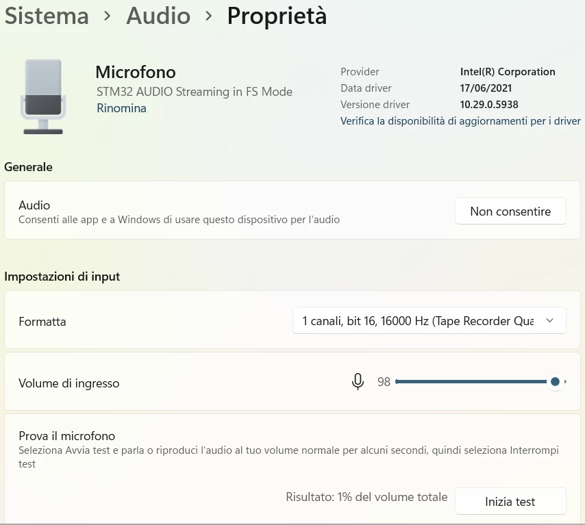

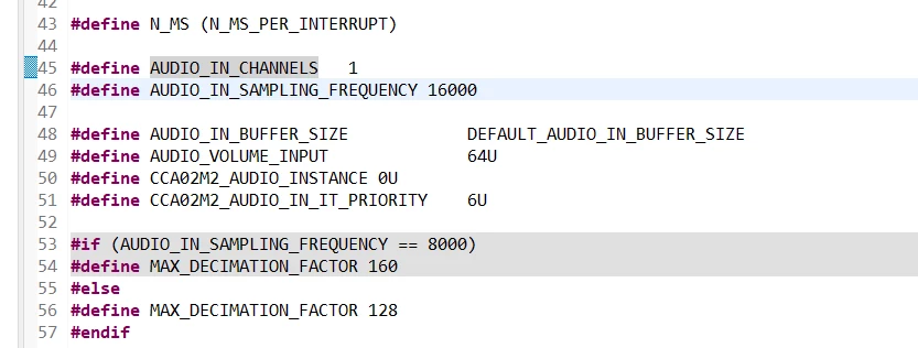

I am anyway much more worried about the malfunction of the board when I select just 1 channel.
I changed the #define in cca02m2_conf.h for streaming 1 channel at 16 kHz
and after the "manual" procedure, building and downloading, the channel is correctly recognized by Win 11
0693W00000GX8jTQAT.pngNonetheless, no sound may be acquired by this Windows app nor by Audacity: no warning but no sound.
As I told you, I didn't change the jumper settings on the CCA02M2 board. It's the same setting I used for streaming two channels.
Marco

The modification to the #define is correct, even if once again windows should automatically enable sound acquisition.
