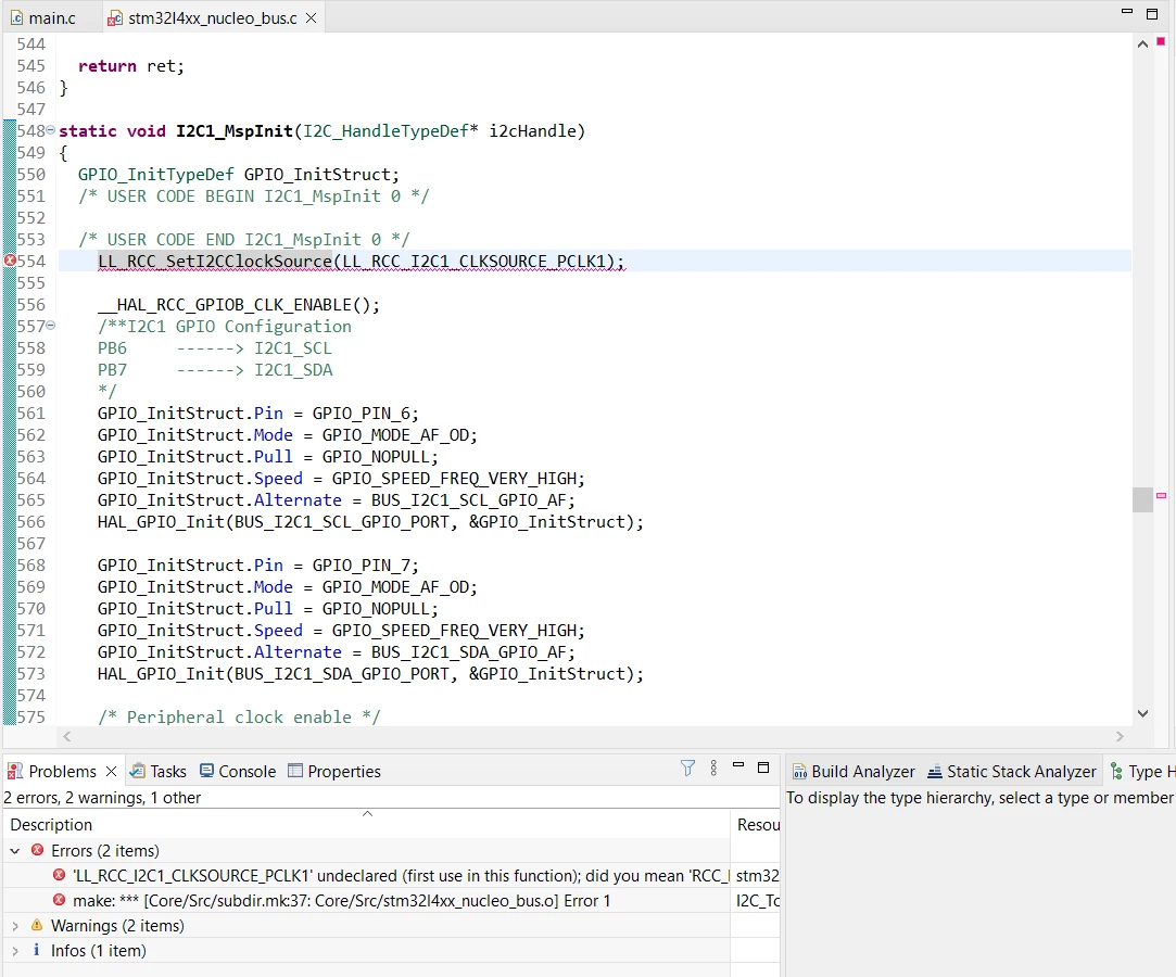

I have downloaded the X-Cube-ToF1 software and configured it for my board, specifying the I2C, GPIO and Interrupt pin.
I see that the generated code includes a way of reading the sensor.
So to check that the code generated correctly, I built the program to check.
Now I could be mistaken, but the example code does not contain this line. Commenting this line out does resolve the error, but I am unsure if it may cause other problems.
The code now successfully generates and I have uploaded it to my board.
Reading though the examples within the X-CUBE-ToF1 files, it seem to be very similar to what my code has generated, but I can not veiw anything from the USART output.

Very strange - I generated some code and it does not have that line.

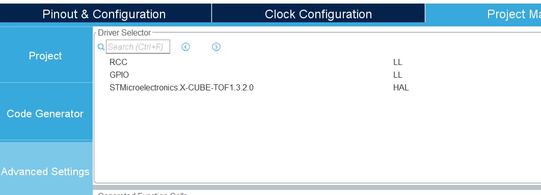

I believe I have found what causes that specific line of code to be generated.
I was changing the configurations to LL, as that is what I am required to code in for the moment.
Changing everything to HAL resolved the issue.
0693W00000aIcqPQAS.pngIs it possible to still achieve the same result with LL?

I have no idea. I'm an expert with the ToF board, but really kind of a rookie with the STM32 tools.
That ppt presentation was kind of my first attempt.
Might want to pose that question to the STM32 community.
