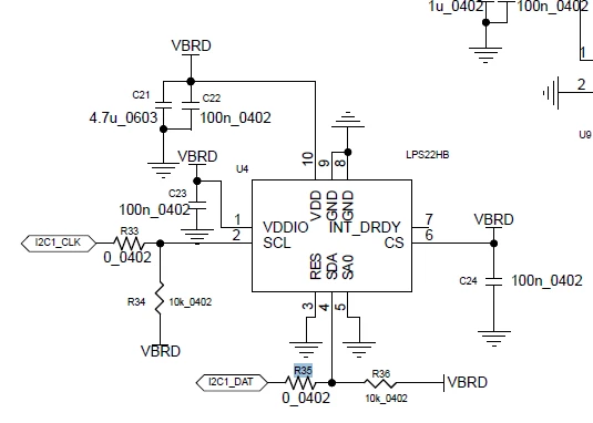

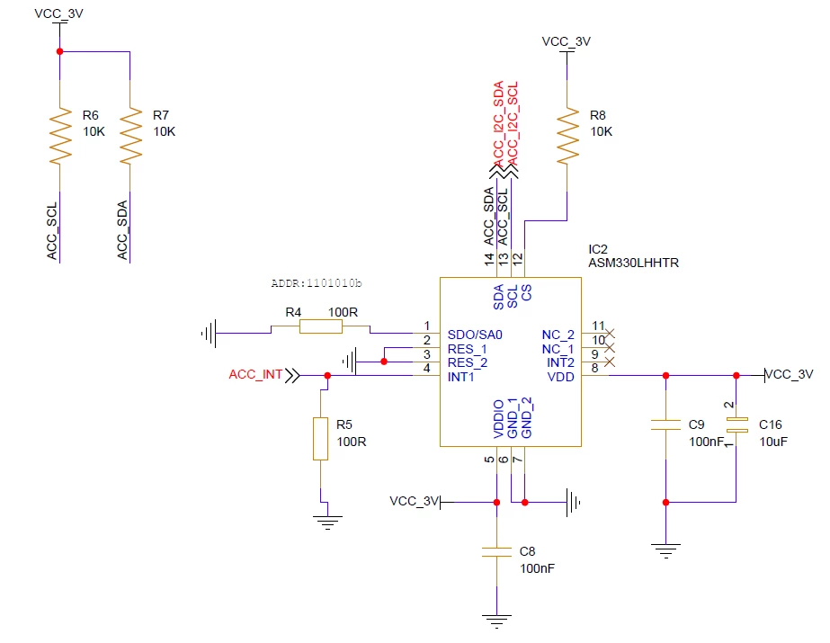

ASM330LHH didn't work in I2C with BLUENRG-LP
Here I used BLUENRG-LP SoC with ​ASM330LHH. We have the same schematic design in steval-IBD11V2A, like the first image. The second one is our schematic design.

I don't know what's the problem. My guess is the set timing is wrong. Because I tried many times with different value.

Finally, I figured out where the problem is. I changed the codes: (in both BSP_I2C_Write and BSP_I2C_Read)
From:
LL_I2C_TransmitData8(BSP_I2C, (Reg | 0x80));
To:
LL_I2C_TransmitData8(BSP_I2C, Reg);
Here raised a new question: Why we sometimes need Reg | 0x80, sometimes not?
