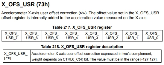

Yes exactly, flipping the chip you should get the same value changed by sign. This in theory, on the unsoldered sample, because the production calibration is performed to minimize the offset. However, you could encounter a residual offset that may be caused by the soldering process or a planar misalignment at application level. In this case, you can record the (average) offset value and store it changed by sign in dedicated registers (X_OFS_USR (73h), X_OFS_USR (74h), X_OFS_USR (75h), see the datasheet, p.95). Regards
