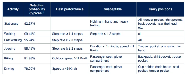

    Eleon BORLINI
    June 28, 2019
    Here below a table describing the algorithm performances:
