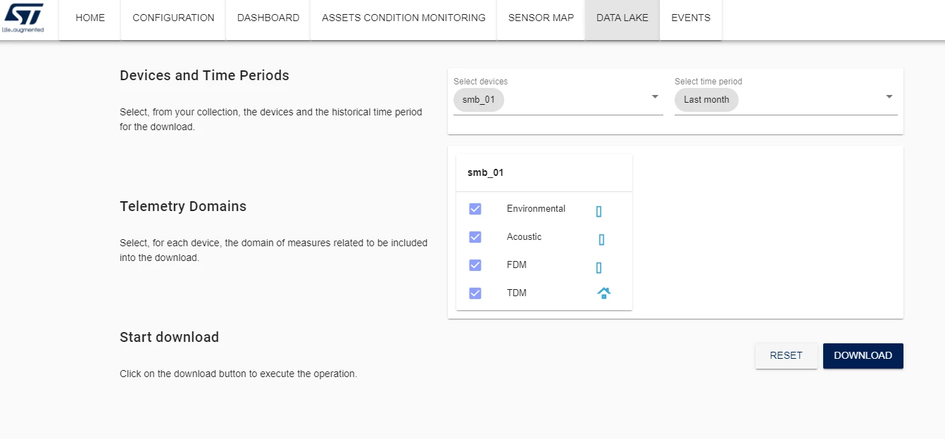

I dowloaded the DATA LAKE file trying to know if in that file I could know how much the sensor consumed, but the file is empty.

Yes, I'm trying to download the DATALAKE file from the dashboard but it is empty. I don't know where I could get that information then. Do you know why? or where could I get the number of bytes from the sensors?

 I have not been able to know how much data I have recorded because when I download the file with the dashboard records, the zip folder is empty.

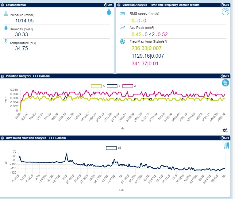

Attached the dashboard screenshot showing what we are sensing with the STWIN. (Vibration, humidity, temperature and preassure ) and we expect to track it 24/7.

niccolò
September 29, 2020
Hi Gabriela @a123​ ,
maybe the problem lies in the time interval you downloaded, try to confirm you chose the right one.
Also, how much time have you been logging these data?
Maybe the file is too short. Having 24 hours of sample log can help by knowing the amount of data: from the file dimension you should multiply for the number of devices you want to use to know the amount of data per day you need.

There are three interval options: last month, last 3 months and last 6 months.
When I try to download the records, the interval I select is last month

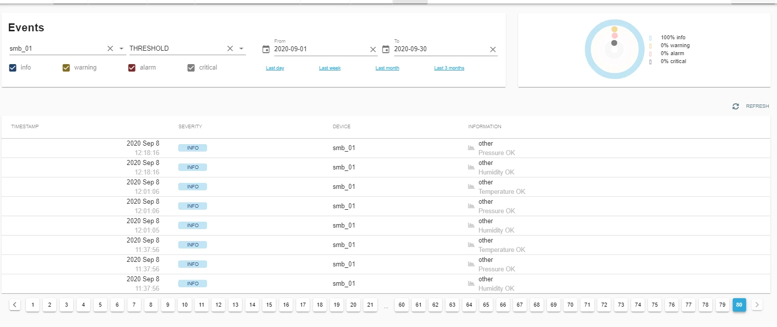

In attach, you can see the logged data showed in the dashboard . ( from 09/09/2020 to today)
Thanks

Hello, the dashboard just already give me the data!!
