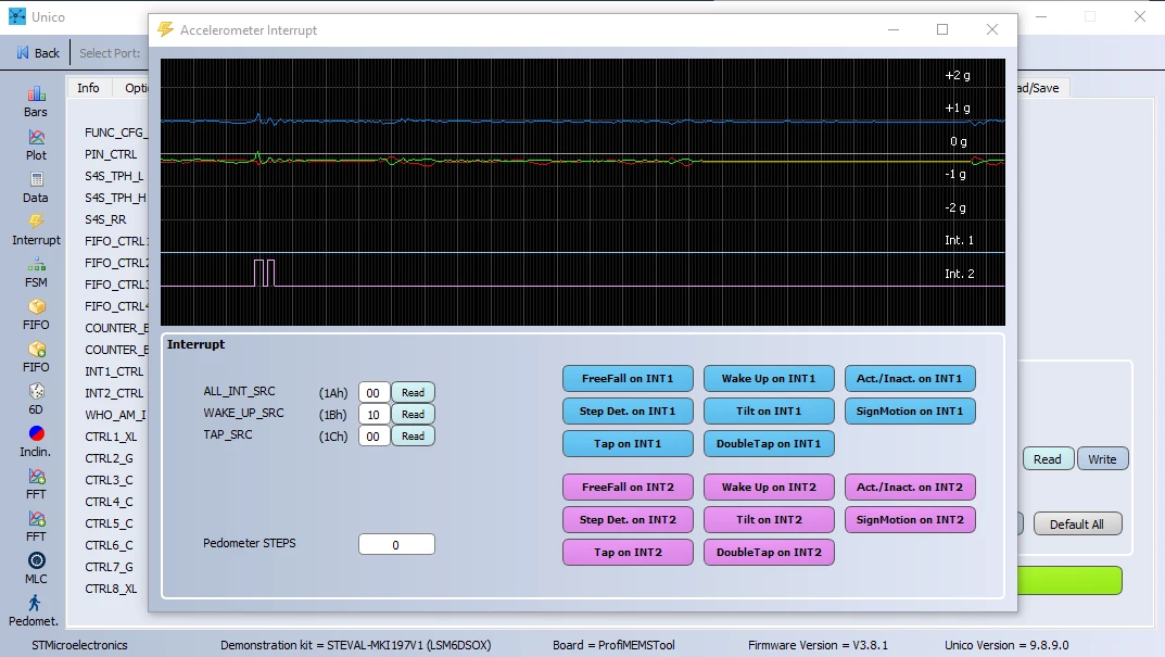

I'm trying to get maximum data rate (ODR=6.66KHZ) of the LSM6DSR with using STEVALMKI109v3 and my own code running on windows 10 laptop. Unfortunately, I couldn't get reached to the speed. it was about 6.56KHZ. The RX buffer on laptop side is good in shape and well enough. And there's no overflow events according to the buffer monitoring.
Are there any way to detect the overflow events or read/check the FIFO status of STEVAL-MKI109v3 ?

Just a question for understanding if it is not a communication speed related issue: if you run the LSM6DSR ad ODR 3.33kHz, do you face the same problem?
About the overflow event, you can detect it by reading (in polling mode) the FIFO_ OVR_IA bit FIFO_STATUS2 (3Bh), Otherwise, It is possible to route for example the FIFO_WTM_IA flag of FIFO_CTRL2 (08h) to the INT1 pin by writing in register INT1_CTRL (0Dh)(INT1_FIFO_TH) = '1' or to the INT2 pin by writing in register INT2_CTRL (0Eh)(INT2_FIFO_TH) = '1'. Then you can plot it on the Unico-GUI interrupt panel.

Here's the result of my experiment. I'm still facing same problem in various conditions as below.
Now, I'm wondering this number is within possible internal oscillators timing accuracy.. just my guess, not sure.
What do you think about it?
For the interruption of FIFO OVF or FULL, none of pin interruption at both INT1 and INT2 were observed.
I might be wrong. Please kindly review below instruction at (2). I sent those command before sending '*start' command to the board.

Eleon BORLINI
October 29, 2020
Hi @晃次 浅�?​ ,
>> Now, I'm wondering this number is within possible internal oscillators timing accuracy... just my guess, not sure. What do you think about it?
I confirm that the values of the actual ODRs you are measuring are ok and are expected to be in a range of variation of +-1% for low ODRs and of +-3% at higher ODRs, although this value is not specified in the datasheet.
>> For the interruption of FIFO OVF or FULL, none of pin interruption at both INT1 and INT2 were observed. I might be wrong. Please kindly review below instruction at (2). I sent those command before sending '*start' command to the board.
I would suggest you to set the interrupt pins after the FIFO mode setting. Then you can try to read the FIFO_OVR_LATCHED bit of the FIFO_STATUS2 register before starting a new FIFO reading, to check if you are not just missing the INT1_FIFO_OVR for some reason.
You can also check the C file multi_read_fifo_simple.c for a complete overview on the register settings for the FIFO configuration of the LSM6DSR.
-Eleon
