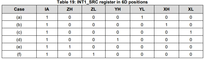

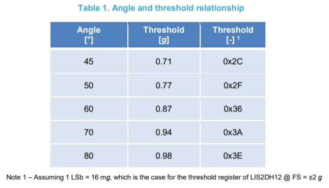

Best answer by Eleon BORLINI
Hi @ilg​ ,
Calculations looks good from my side.
In a 6D orientation detection, 45° is the discriminant between an orientation and another one, since 44° along x are 46° along -x.
So I believe you should get an interrupt in any case, but with different flags risen in the INT1_SRC register.
For the 6D orientation, the INT1_THS is set to 0x21 (see app note AN5005, p.28).
0693W00000FC5F0QAL.pngCheck also this design tip note: Setting up 6D orientation detection with ST’s MEMS accelerometers.
0693W00000FC6efQAD.png0693W00000FC6emQAD.pngThe tilt detection is limited to 45° for symmetry.
-Eleon
