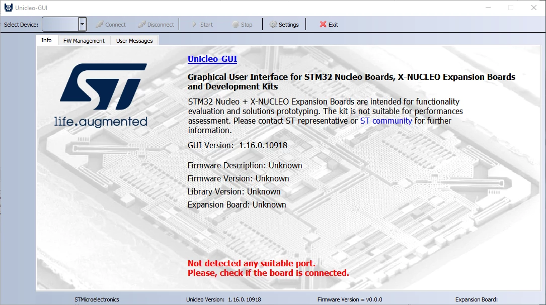

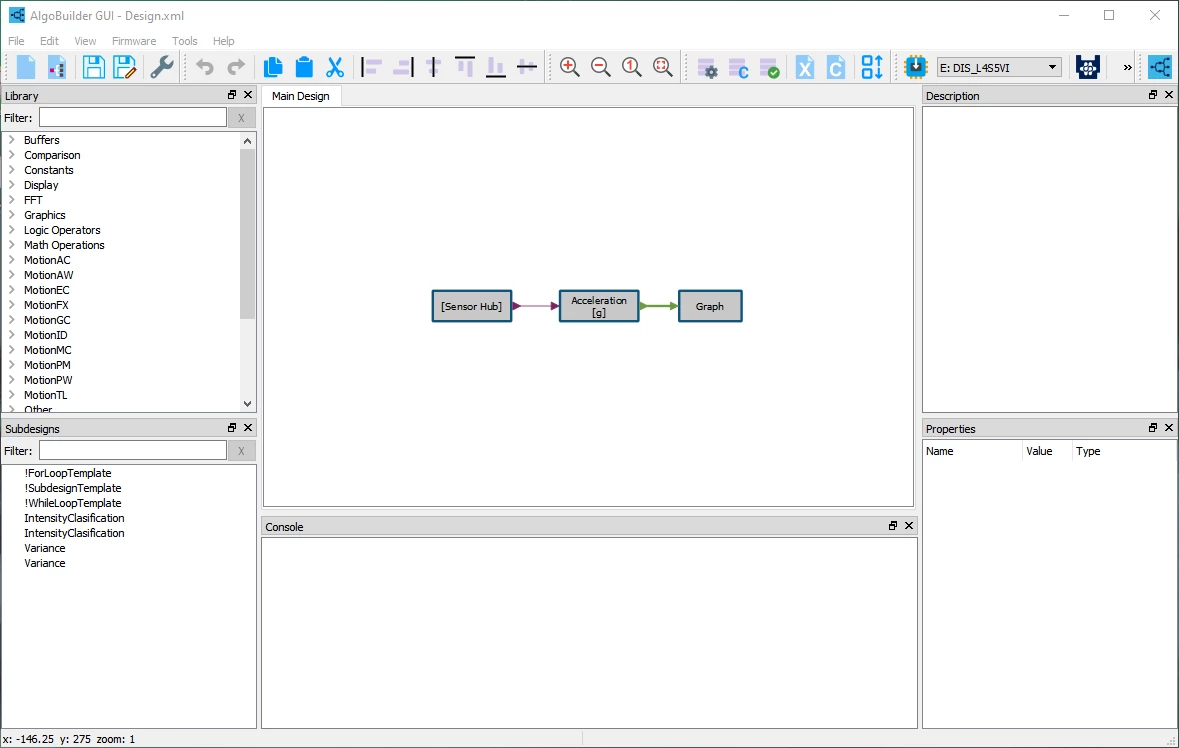

AlgoBuild and MEMS1 for a custom board (B-L4S5I-IOT01A)

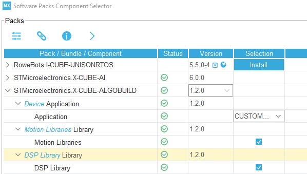

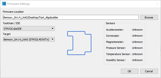

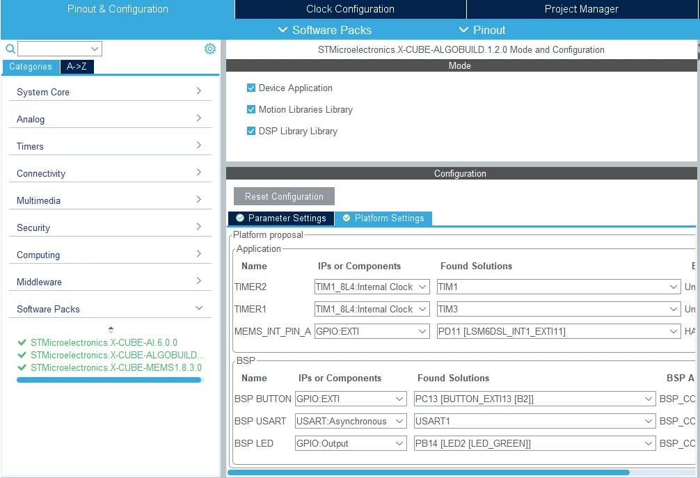

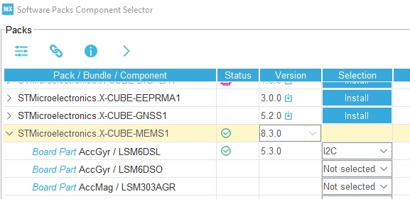

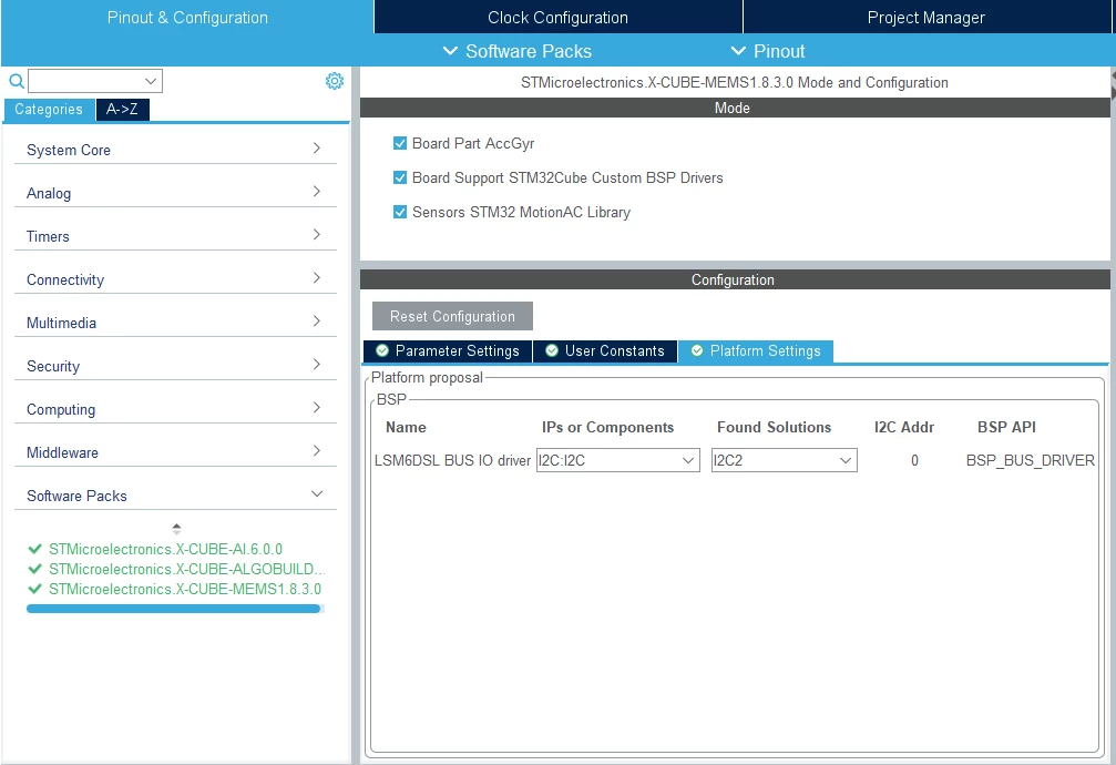

I'm having trouble setting correctly AlgoBuild and MEMS1 in STM32CubeIDE, in order to use Algobuilder, Unicleo, and Unico to recover data via the accelerometer and create IA algos.
Here are my Algobuild and MEMS1 settings.
0693W000008zyObQAI.png0693W000008zyOgQAI.png0693W000008zyPKQAY.png0693W000008zyORQAY.png
When I compile the project, there are some minor errors, that can be easily resolved by manually including the missing files.
Then, I copy the repertory where my project is, in Users\user\STMicroelectronics\AlgoBuilder\FirmwareTemplate so my firmware is recognized by AlgoBuilder.

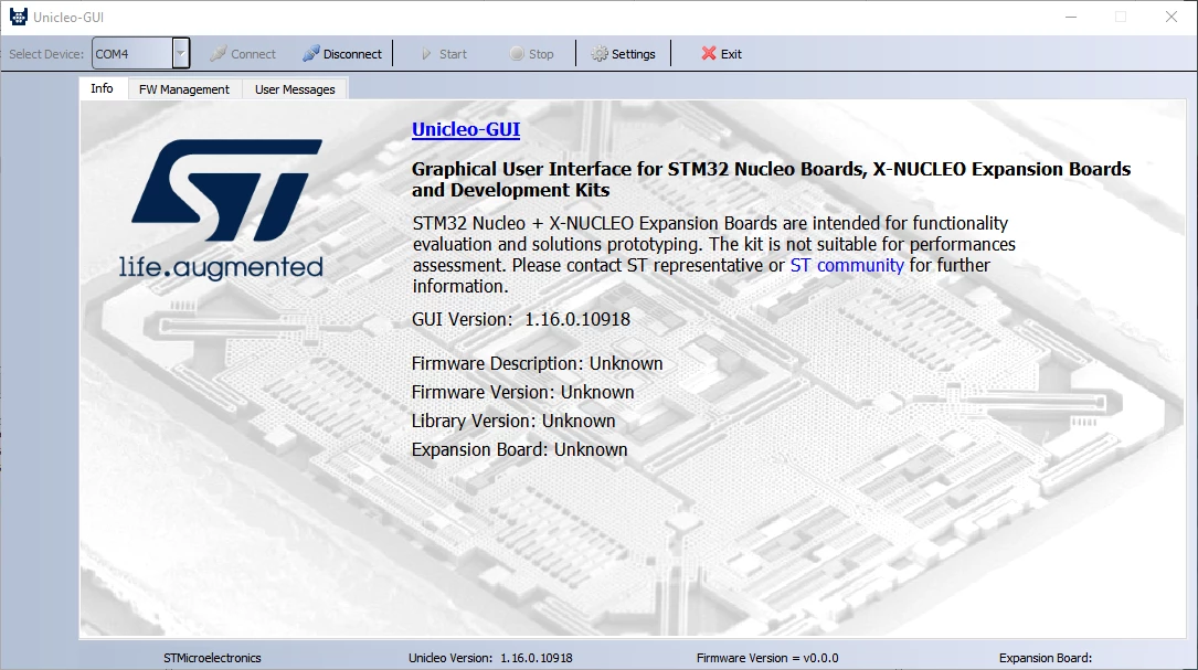

Generating and compiling the Firmware gives no error, neither when I program the MCU. My main problem arrives when I try to use Unicleo, it tells me that it can't recognize any boards connected to my computer. I have checked the setting option to list all COM ports, but that doesn't resolve anything; I can now see the COM port where my board is, but when I select connect, the option to Start doesn't become available.
Does anyone have an idea where I made a mistake? Or if I'm missing a step somewhere?

    EAvinaBest answer
    Jul 30, 2021 7:22 AM UTC
    Hi Miroslav,
    Thank you for your quick reply.
    I finally did it work. I indeed put it on a high priority task, one that is called each 200 ms, but since AlgoBuilder uses the UART that I was using to send debug info to my computer, it didn't work. I think that they can't coexist since the resources must be available to be used by Unicleo that is why it couldn't recognize my "custom" board. But after commenting all my prints, it worked.
    Another thing that I noticed is that when you include your firmware into the AlgoBuilder path
    (C:\Users\user\STMicroelectronics\AlgoBuilder\FirmwareTemplate) with also a folder called METADATA (originating from the STM32CubeIDE build), AlgoBuilder will not rebuild your Firmware and take into account your design (.xml/algo_builder.c), it will still use the "design" (algo_builder.c) generated by the STM32CubeMX.

    I checked with out experts, and they told me that the firmware generated by AlgoBuilder use the proper communication protocol so the Unicleo-GUI doesn’t need to know the board.
    The problem could be in the so called firmware template generated in STM32CubeMX (using X-CUBE-ALGOBUILD and X-CUBE-MEMS1). Can you please share this firmware template for a check? Maybe some settings is not correct.

    Thank you for your reply. Here are the screenshots of the configurations that I use in CubeMX and the generated files as well. Please let me know if you need anything more.
     0693W00000AM58xQAD.png0693W00000AM58iQAD.pngEli A.
    Apr 22, 2021 7:55 AM UTC
    thank you for sharing the files but I would need the complete directory or the ioc file to be able check your configuration.
