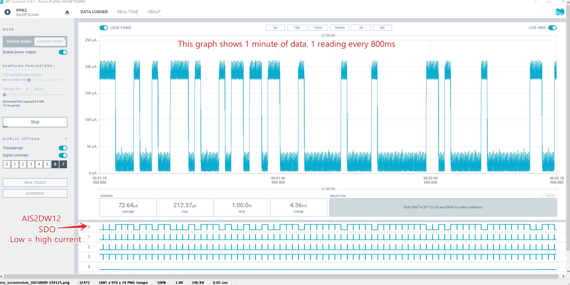

When I read the FIFO with SPI the SDO pin is sometimes left LOW. This causes a current leak through the internal pull-up. See pic attached showing 1 minute of readings every 800ms. As you can see the current is high every time the SDO pin is low. I assume the internal pull-up is causing the current.
I've read the data sheet and the application note AN5326 but I cannot see why this happens.
I'm using ODR 25HZ with Power mode 4, +2G range and continuous FIFO. SPI 4-wire. NRF52840. I have tested the NRF52840 current draw and determined that the accelerometer is drawing the current.
To hack it lower before sleeping, I've set -1 (oxFF) to my Z_OFS_REG and I read from the Y_OFS_REG (this register precedes Z_OFS_REG). This results in the trailing SDO bit always being high at the end of the SPI read. This leaves the SDO line HIGH which avoids the problem. I would like to know if there's a more conventional way of fixing this.
I've tried all 4 SPI modes and I've tried SPI frequencies 125khz, 4Mhz and 8Mhz.
My accelerometer is the STEVAL-MKI206V1 breadboarded with an nrf52840 dongle. 4 wires from accelerometer to dongle. no additional components.
Any help is greatly appreciated.

Hi @JasonRrrr​ ,
I understand the problem. Do you see this issue only using FIFO, and not in bypass mode?
A possible "solution" could be use the 3 wires SPI instead of 4 Wires, so that you can avoid to use the SDO/SA0 pin.
3 wires SPI is a little more complex that 4 wires one, but the NRF52840 dongle should implement it.
Your patch is valuable, indeed, and if it doesn't impact on your code you can implement it too.

Hi Eleon, Unfortunately the nrf52840 cannot receive data using 3 wire SPI (I think it might be possible if I connect the MOSI to MISO with a 10k resistor and reducing the frequency, but I want to have 8M frequency to minimise power usage)
I've not tested bypass mode and I cannot test this today. I must use FIFO in my application though.
I could try toggling bypass mode to see if it resets the SPI MISO pin. I will try this the next time I have the breadboard setup
