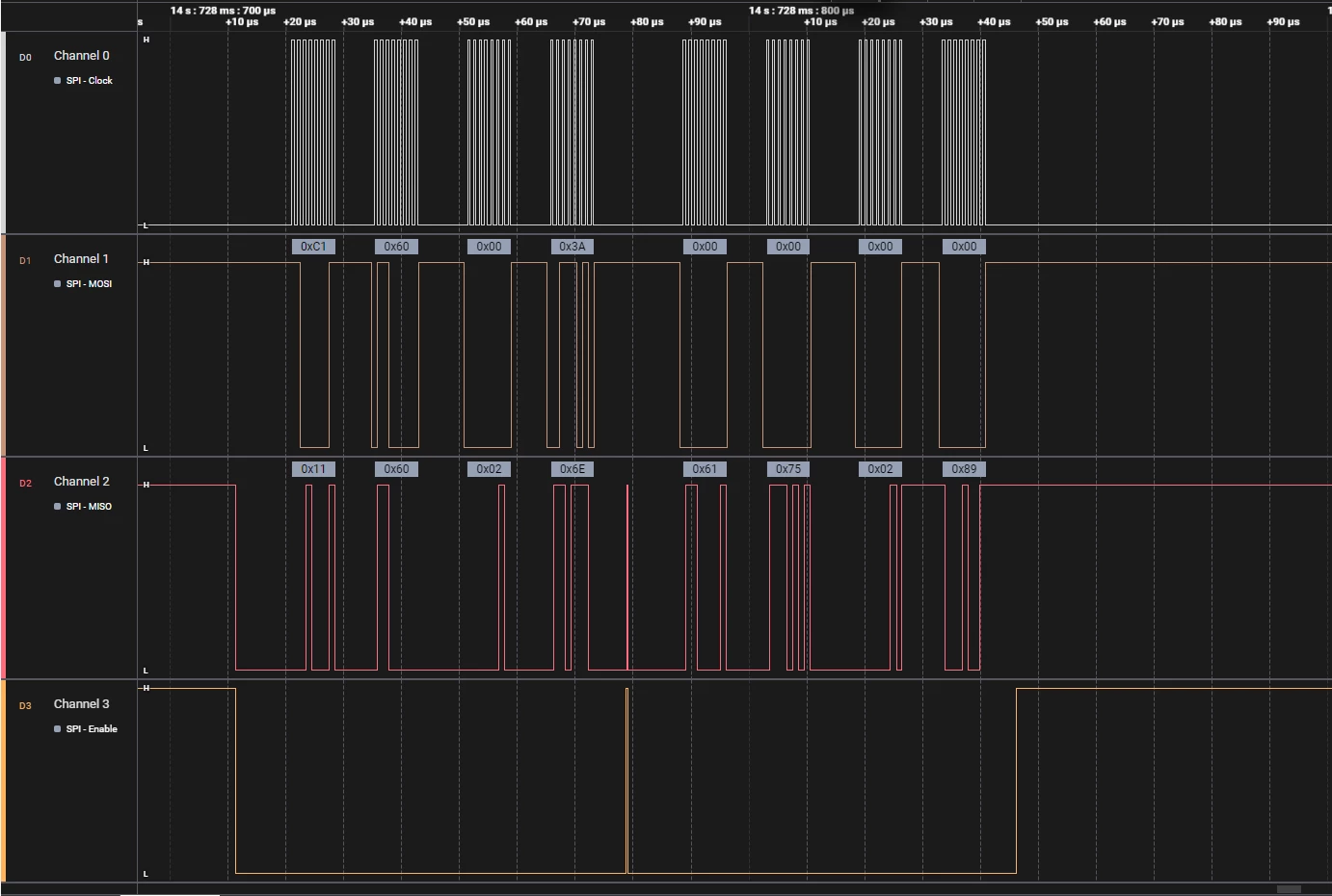

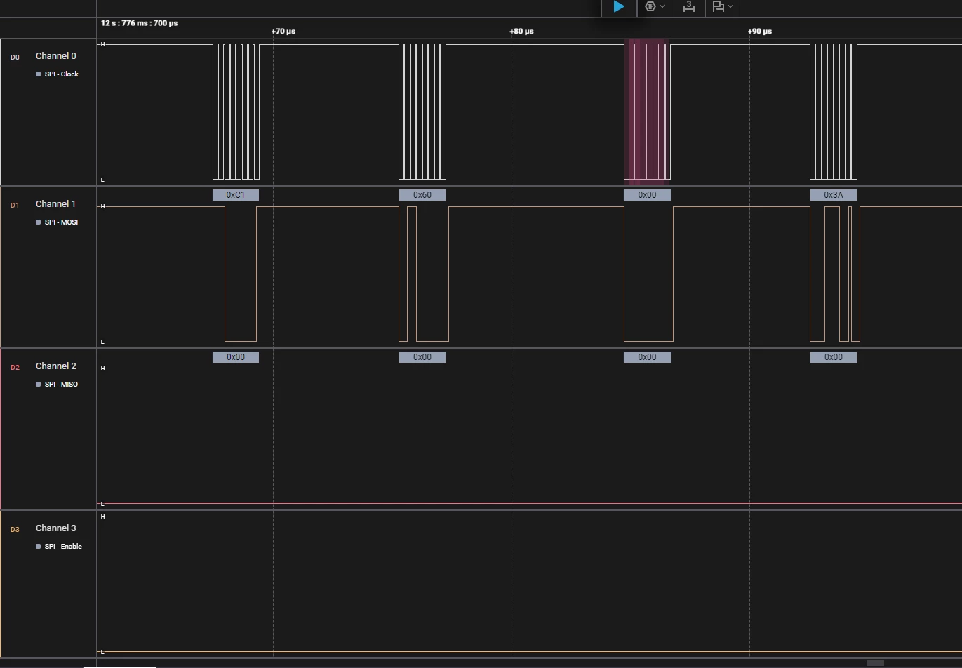

I always get zero in response from AIS2120 sensor, anyone can help please
June 26, 2025

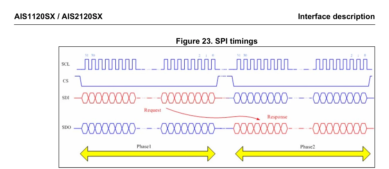

The chip expects 32-bit messages and you're sending 8-bit messages.
June 27, 2025
actually i also tried with 32 bit messages, you can see trace below
June 27, 2025
Show two valid 32-bit transactions back to back as it does in the example, with proper CS line handling.
June 27, 2025
June 27, 2025
Looks like it's working to me.
Long wires are not going to be amenable to high data rates.
