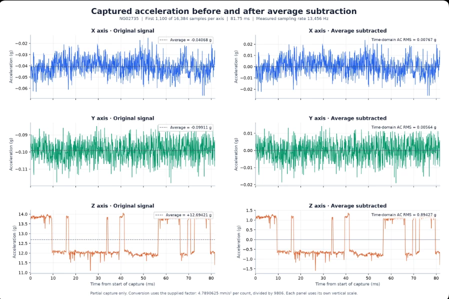

Hello, I would like some support in understanding an issue that occurred with a product incorporating the IIS3DWB component.
The IoT sensor transmits global data with constant acceleration values ​​subtracted. These global measurements should not be reflecting gravity. Upon examining the raw “spectral” data—prior to any processing—it becomes clear that the value of ~1g is merely a coincidence. In reality, we are dealing with a faulty accelerometer.
What could be causing this failure, even when the sensor is stationary on a table?
I would like support from a specialized engineer.
Thanks.

Hi Anaportela,
I am not a specialised Accelerometer Engineer however allow me to ask you a few questions to better frame the question for when the right person comes along! I have a moderate amount of experience with Accelerometers but I have alot of experience designing PCBs and housing to withstand different resonances as well as the processing of high frequency domains.
  1. Can you describe the enviroment this sensor is in?
  2. What full-scale range is the sensor set to?
  3. Are there any fans, motors, or vibrating machine running on or near the mounted location?
  4. Is there a DC-DC switching power supply or a wireless antenna really close to the Accelerometer on the PCB?
  5. Is the PCB inside housing?
  6. Does the Z-axis stepping stop if you pick the sensor up in your hand or place it on a foam pad?
I appreciate that is alot of questions but understanding the enviroment is incredibly useful!

Hello ozammo,
In response to your questions:
1 - Our sensors are installed on assets in industrial environments, such as motors, pumps, gearboxes, compressors, steam turbines, and generators.
2 - The value is 16g (acceleration due to gravity).
3 - This issue occurred with a geared motor at a client’s site, which is a very noisy environment. When the unit was returned for replacement, the fault persisted even while it was sitting on an office desk.
4 - Yes. The circuit uses a u-blox NINA module for wireless (Bluetooth) communication, which is positioned directly above the accelerometer on the PCB.
5 - Yes, it is enclosed in a polyacetal housing.
6 - I left it sitting on a sponge for several hours, but the issue did not disappear; it persists.

Interesting, it does sound like an event has caused permenant damage to the sensor. Here is some ideas:
  1. Does the error persist if the NINA module is removed or disabled?
  2. Is the product vibration tested to relevant standards to ensure resonance frequencies does not impede functionality?
  3. Are you certain that none of the maximum limits of the sensor has been breached? While the 10,000g max allowable limit sounds high, I would not be suprised if the housing amplified the motors movements and breached the limit.

Hello, here are the answers to your questions:
1- Currently, the accelerometer sampling routine is mutually exclusive with the radio: the NINA (Bluetooth) module is explicitly deactivated/turned off before data acquisition begins and only resumes operation after data collection is complete. Therefore, the radio is not active during measurements. In other words, the error persists nonetheless.​​​​​​
2- What are these standards? Could you provide some examples? To provide context for our validation process, we conduct a functional test using a vibration device equipped with a calibrated piezoelectric element, which serves as a reference. The accelerometer is subjected to vibrations along three axes (X, Y, and Z), and we compare its readings against those of the piezoelectric reference. A deviation of up to 5% relative to the reference is considered acceptable.
3- 4 - I’m not certain, and I don’t believe there’s any way for us to know if a machine is resonating. Is there any way to find out? The machines belong to our clients.
Oct 26, 2026 7:29 PM UTC
If the accelerometer reports 13.6g while sitting on a table, it is faulty or damaged or you have some bug with interpreting the values. Damage could have occurred due to a mechanical incident, such as a impact event, or a steady state stress on the component.

Hi ​@anaportela
Could you please share:
  • The raw X/Y/Z samples before processing or conversion to g
  • The sensor configuration register dump and the acquisition method used, either direct register reading or FIFO
  • How many devices show this issue out of the total tested, and whether they initially operated correctly or was the issue present from the first use?
  • Photos of the setup
