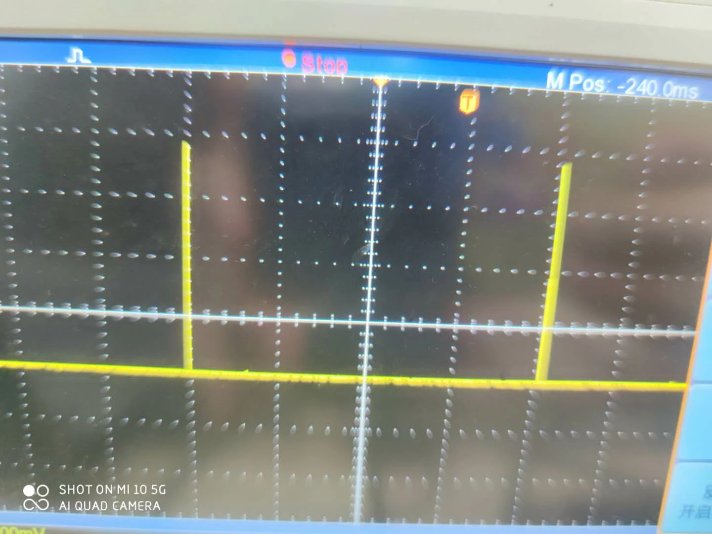

The cycle of interrupt1 is not 1s but 1.016s.
The code is as follows:
uint8_t reg_data;
 reg_data = 0;
 lsm6dso_ic_write_register(NULL, LSM6DSO_WAKE_UP_DUR, &reg_data, 1);
 reg_data = 2;
 lsm6dso_ic_write_register(NULL, LSM6DSO_WAKE_UP_THS, &reg_data, 1);
 reg_data = 0x51;
 lsm6dso_ic_write_register(NULL, LSM6DSO_TAP_CFG0, &reg_data, 1);
 reg_data = 0x80;
 lsm6dso_ic_write_register(NULL, LSM6DSO_TAP_CFG2, &reg_data, 1);
 reg_data = 0x70;
 lsm6dso_ic_write_register(NULL, LSM6DSO_CTRL1_XL, &reg_data, 1);
 nrf_delay_ms(4);
 reg_data = 0x10;
 reg_data = 0x20;
 lsm6dso_ic_write_register(NULL, LSM6DSO_MD1_CFG, &reg_data, 1);0693W000003QekTQAS.jpg
