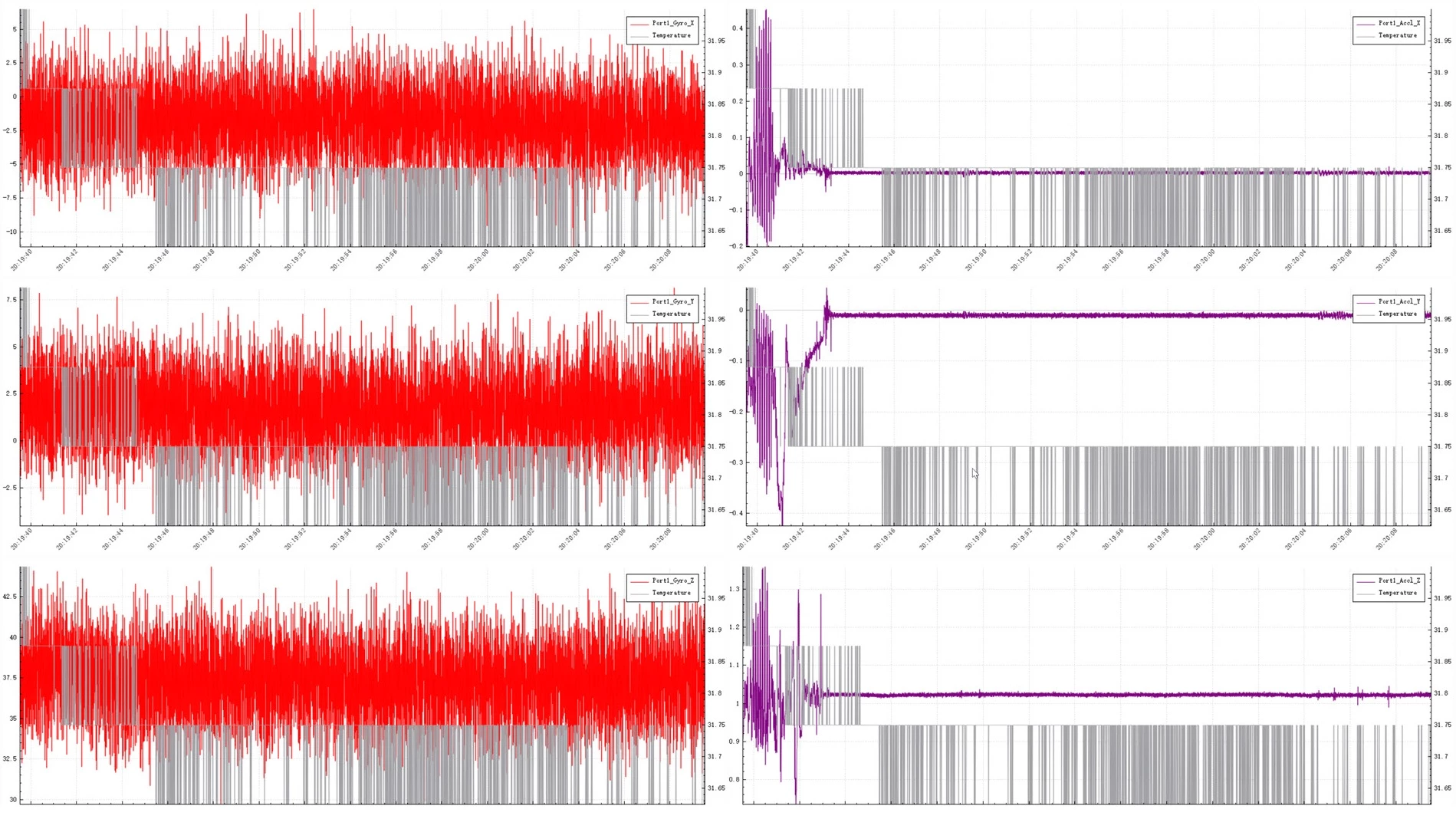

Abnormal output value from ASM330LHH gyroscope. Gygroscopoe no feedback when I move, vibrate or knock the product, but the output data have noise (may show the sensor is not damaged?)
  • July 3, 2021
  • 1604 views
I got a gyroscope problem when i use asm330lhh to develop a new product, and need your help.
Gyroscope of ASM330LHH got abnormal output value, detail as follow.
1) gyroscope zero offset is much bigger than usual.
2) gyroscope noise is much bigger than usual.
3) no any feedback, when i move/ vibrate/ knock the sensor.
4) I read the STATUS_REG (0x1E), the value of the reg is 0X0F, and normal should be 0x07.
follow is the sensor data monitor picture as below:
(the red curve shows the gyroscope data, and the purple curve shows the accel data)

additional info:gyroscope fs is setted as 250dps​

Hi @Teni CC​ ,
we can continue the discussion via message, please check that flow.
