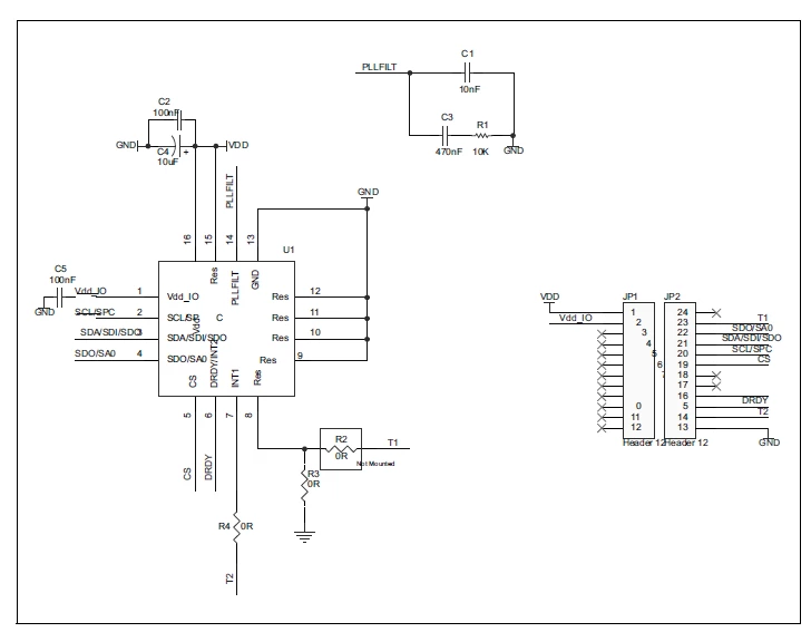

    gist
    Visitor II
    January 27, 2015
    Posted on January 27, 2015 at 16:41
    Our problem was that the phase locked loop circuit on pin PLLFILT. We had a short between two points so that it didn't work. This caused the issues with only able to read 1 sensor value, then they stayed the same.
    For reference, my CTRL regs was:
    CTRL1 = 0x0F
    CTRL5 = 0x02
    CTRL[2,4] = 0x0

    June 18, 2018
    Posted on June 18, 2018 at 12:12
    zuoshengting
    ‌ what exactly is your problem? Can you share your schematic?

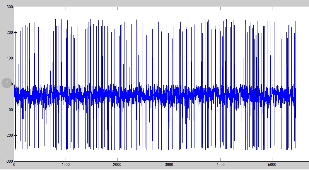

    zuo shengting
    June 29, 2018
    Posted on June 29, 2018 at 03:25
    thank you for your reply.
    I bought the steval-MKI125V1, and the schematic is here:
    Now, I am able to read the angular rate of X,Y,Z, but there is a lot of noise. Here is Z axis data:
    I really confused. Do I use the wrong way of getting those data? Or these noise is exist truly?
