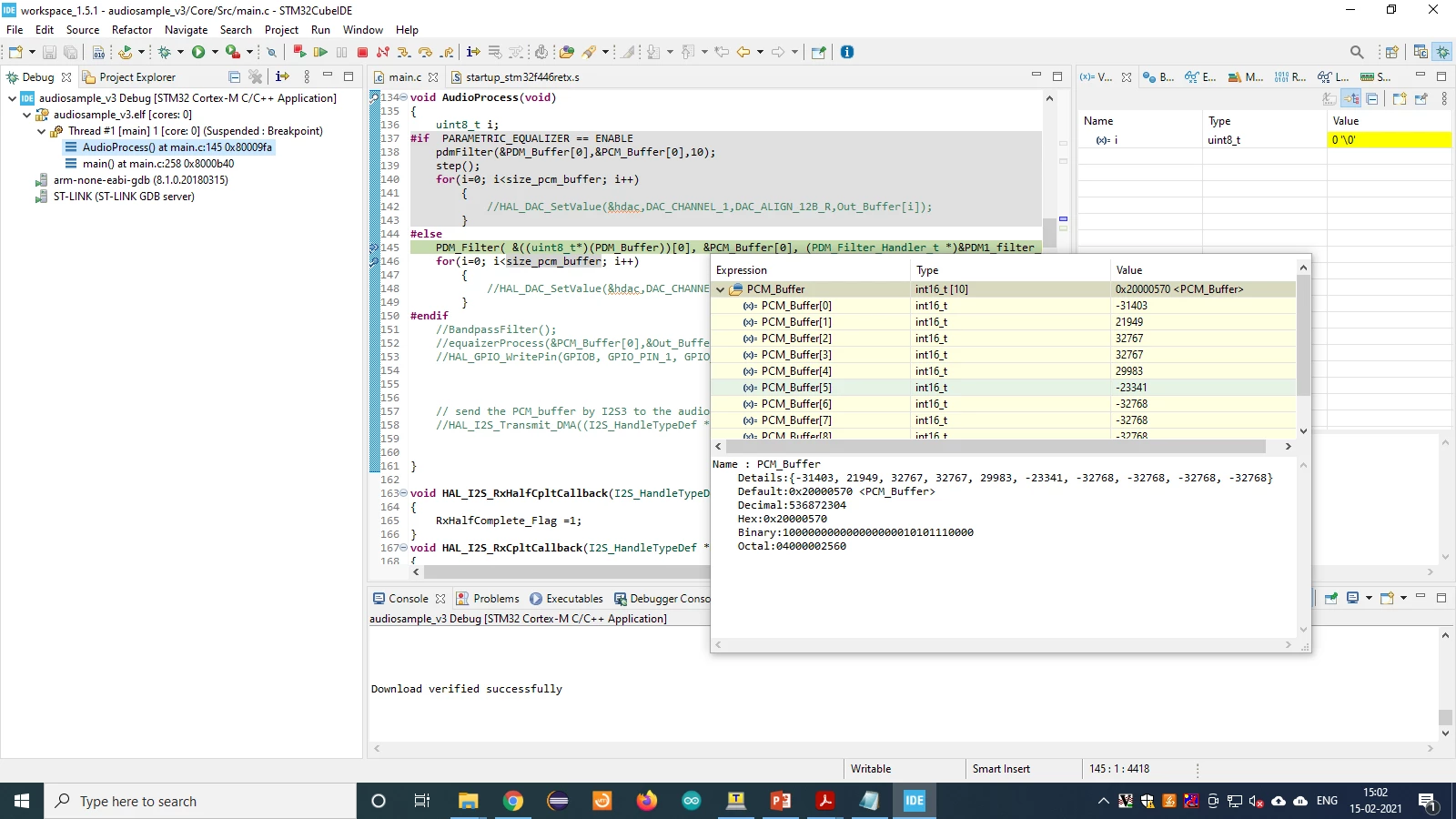

Hi Eleon ,
Thank you for the help once again ,yes I checked the usage of PDM2PCM and the use of STM32CubeMX for the hardware. I have interfaced the MEMS mic tdk ics43432 with STM32F466re nucleo board and generated a PDM_out for a Serial clock of 1.024MHz with decimation of 64 and below is the PCM _out I have got it and attached it for the view. I am not sure how to validate is this accurate one.
Well my further query is ,these PCM values in a buffer I got to capture them for a certain time lets say 5 seconds print them on an UART.
well again this data captured for that certain time has to be converted into a dB SPL value and print serially again for every 1 second.
this serving as the study case for real time project containing an threshold value set for an acoustic sensor with stm32 cortex M7series MCUs.

Hi @Community member​ ,
maybe the application in \Projects\BlueCoin\Applications\AudioLoop of the STSW-BCNKT01 could be closer to your purpose...
But let me try to find some internal help for your query.
