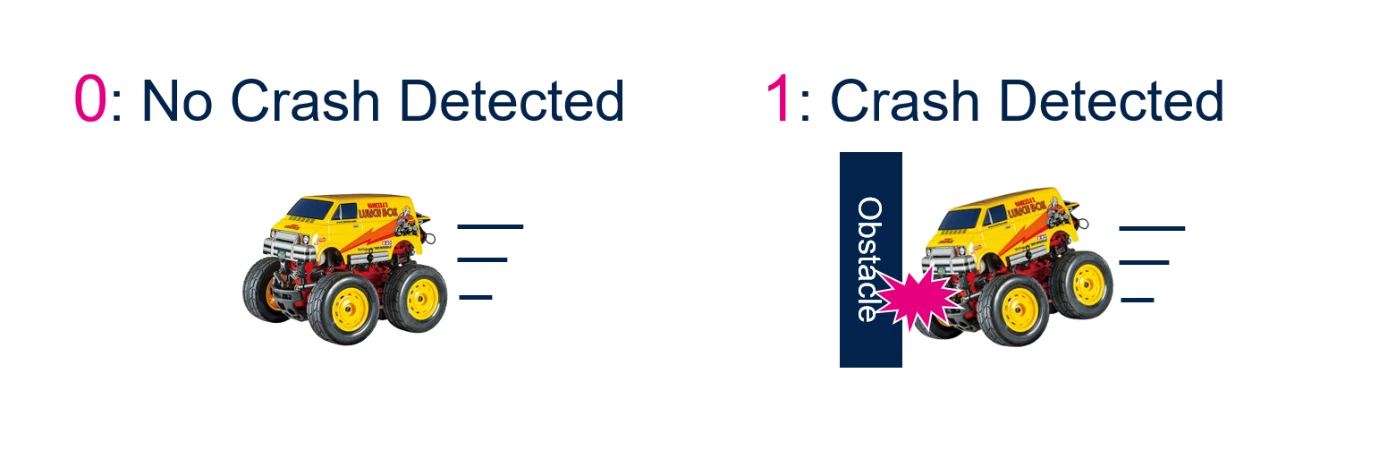

In addition to the MLC, we programmed the FSM to recognize if the car has crashed. The crash raises a flag when the RC car hits something from the front (front-end collision).
  • Crash 0: No crash is detected.
  • Crash 1: Front-end collision is detected.

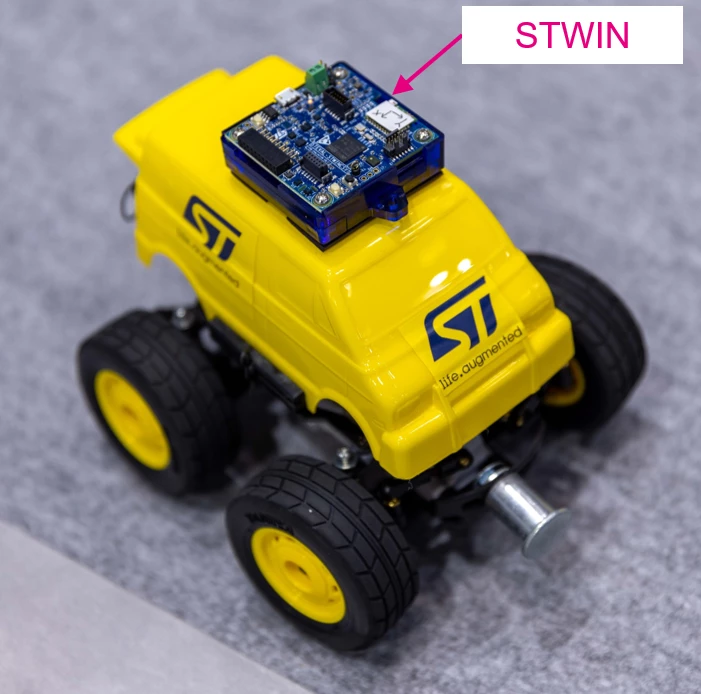

The hardware setup is very simple. We are just using an STWIN kit (STEVAL-STWINKT1B) by fixing it on top of the commercial remote-control car as shown in the picture below.
The device used in this demo is ISM330DHCX, which is an industrial grade 6-axis IMU present inside the STWIN kit. An automotive-grade 6-axis MEMS sensor is the ASM330LHHX, but for demonstration purposes, we used the STWIN kit due to the similarity in functionality.
For data transmission to the PC, wireless communication by Bluetooth® Low Energy is used. So, it does not need any cables.

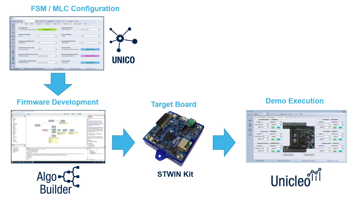

The software used is Unico-GUI, Unicleo-GUI and AlgoBuilder:
  • Unico-GUI is used to make a configuration file of the MLC and FSM for ISM330DHCX.
  • AlgoBuilder is used to develop the firmware for the STM32L4R9 host MCU of the STWIN kit. This firmware configures ISM330DHCX, reads the outputs of the MLC / FSM, and passes them to Unicleo-GUI via the Bluetooth® Low Energy component.
  • Unicleo-GUI graphically displays the results of sensor fusion, vehicle status by the MLC, and crash detection by the FSM.

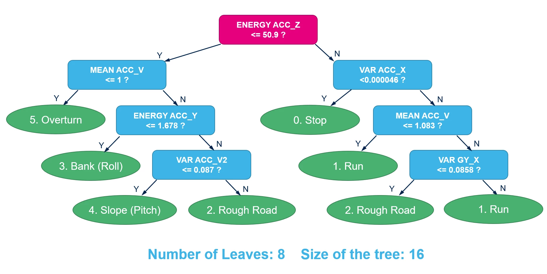

The resulting decision tree is shown in the figure below.
To obtain this decision tree, we have referred to the guidelines described in DT0139. In other words, we did a data check, a cleaning to eliminate error data and a visual check manually. But no optimization, such as pruning, is carried out due to time and resource constraints.

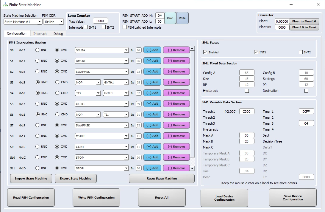

4.Configuring the FSM for crash detection
We also implemented accident detection on the front-end of the RC car in the FSM, because the FSM is better suited to detect short-term events such as accidents than the MLC.
This figure shows the accident detection parameters we defined for the demo using Unico-GUI for the FSM.
The axis to be detected is only +Y, and the threshold is set to -2[g], whose value was determined by trial and error.
To automatically clear the output register of the FSM after a few seconds, the firmware has some additional command and timer settings in addition to the main part for shock detection.

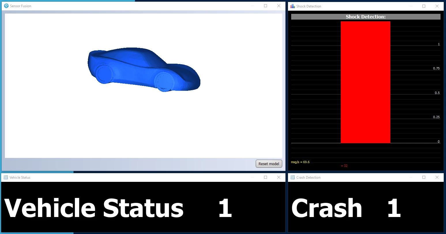

The firmware generated by AlgoBuilder is uploaded to the STWIN kit as described above, so that the output can be seen in Unicleo-GUI as shown in the figure below.
The 3D graphics of the blue car show the result of 9-axis sensor fusion computed by the STM32 library. The number appearing in the “Vehicle Status” box shows the output of the MLC described in Section 3, while the red bar and the number appearing in the “Crash” box displays the output of the FSM described in Section 4.

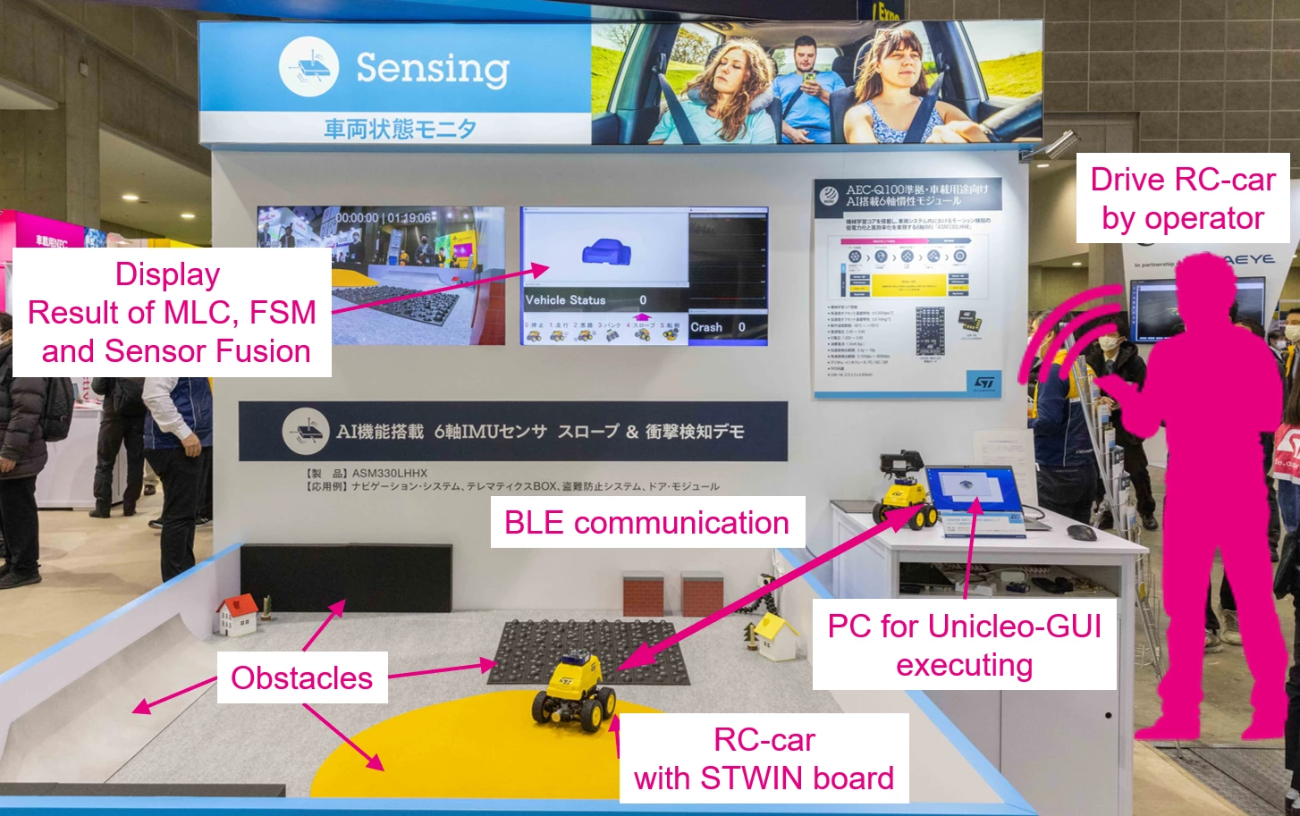

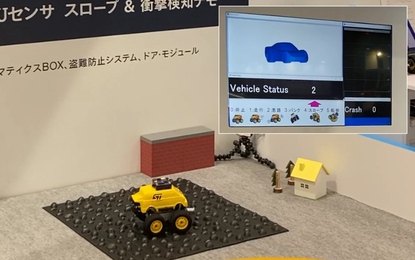

6. Demonstration at the automotive exhibition
The prepared demonstration system is shown in the picture below:
The STWIN kit sends the calculated data and detected status of the RC car in real time via Bluetooth® to the PC Unicleo-GUI. Then the Unicleo-GUI displays the received data/status graphically.
The RC car was remotely controlled by us in a 2m x 2m area, where there were some obstacles such as slopes, banks, walls, and rough surfaces.
Let us see together how this demo kit worked at the exhibition.

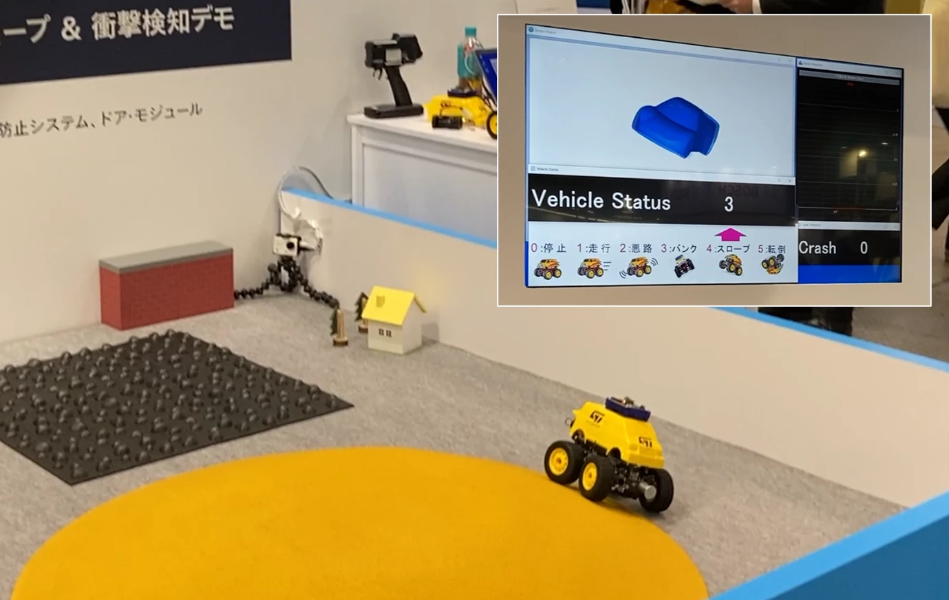

The following pictures show some cases of the RC car’s position and the outputs of the demo firmware, which were recognized by the MLC and FSM.
When the RC car is piloted over the bumped area, then the “Vehicle status” shows “2” (i.e. rough road status) on the screen as defined in Section 1.
If the RC car is tilted to the left (or right), then “Vehicle status” shows “3” (i.e. on bank status) correctly on Unicleo-GUI.

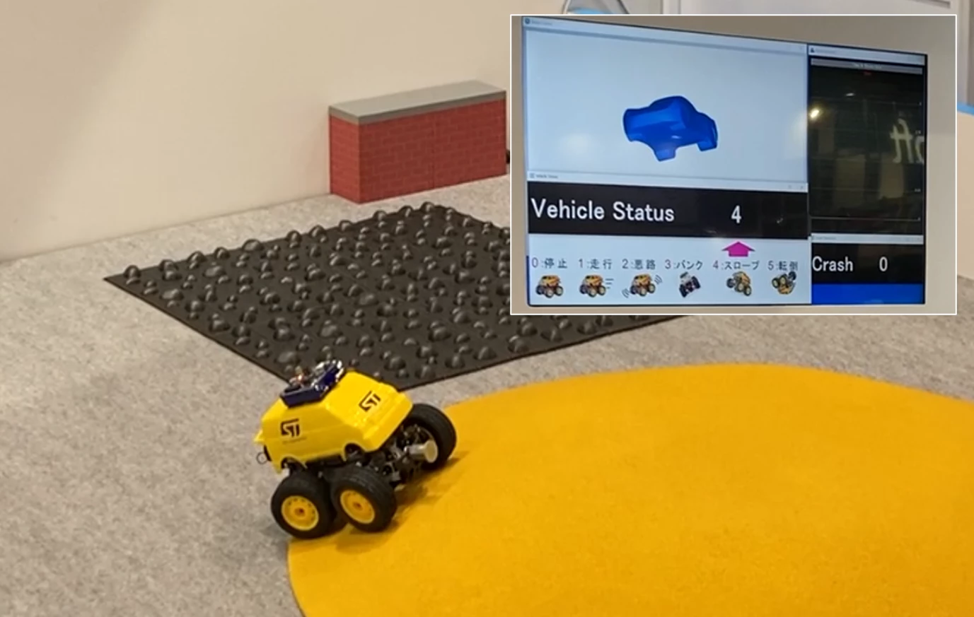

When the RC car is climbing or descending the slope, then “Vehicle status” shows “4” (i.e. on a slope) correctly (same for the rear-end of the car).

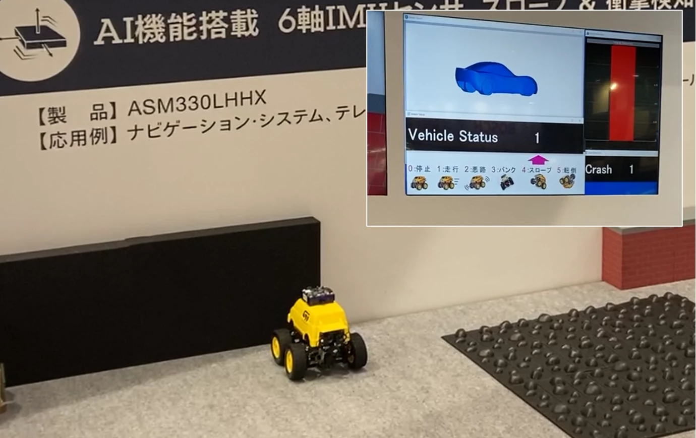

If the RC car hits the wall from the front-end, then Unicleo-GUI shows a red bar and the status of “Crash” becomes “1” (i.e. stop status) detected by the FSM.
The demo worked successfully during the show and proved to be effective. In fact, many visitors stopped to watch it and asked many questions, also providing feedback.
