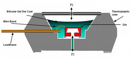

Figure 1 illustrates the physical internal structure of a pressure sensor. To help you understand how pressure sensors and pressure measurement work, it is a cross-section of a standard pressure sensor.
Figure 1: Internal structure of a pressure sensor (cross-section).Figure 1: Internal structure of a pressure sensor (cross-section).
In figure 1, the positions of ports P1 and P2 are indicated. The importance of these ports and their positions for pressure measurement is explained in the following sections.
The die and wire bonds are protected with silicone gel. This gel can be damaged, leaving the die and wire bonds exposed to the media, if the sensor is used with media other than dry, clean air.

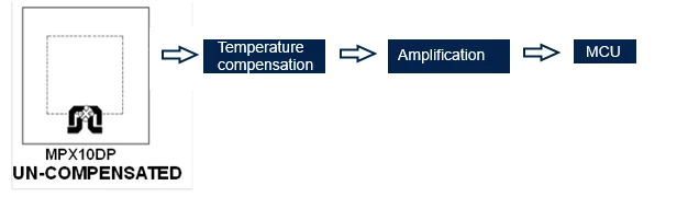

  • Uncompensated pressure sensors are the most basic type. They provide a differential output in the millivolt range, which requires external temperature compensation and amplification before being sent to the microcontroller unit (MCU) analog-to-digital converter (ADC).
Figure 6: Uncompensated pressure sensors.Figure 6: Uncompensated pressure sensors.

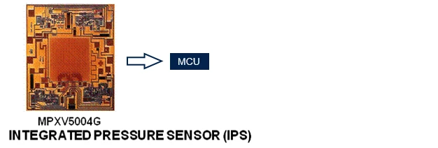

  • Integrated pressure sensors (IPS) provide a complete solution in a single package. The output signal is internally temperature compensated and amplified (the output range is typically 0 to 3 V or 0 to 5 V, depending on the part number). Only decoupling capacitors may be required, and the signal can be sent directly to the MCU ADC.
Figure 8: Integrated pressure sensors.Figure 8: Integrated pressure sensors.
