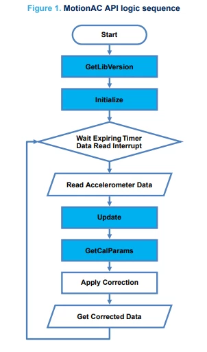

The central function that performs the calibration is this one:
void MotionAC_Update (MAC_input_t *data_in, uint8_t *is_calibrated)
*data_in parameter is a pointer to a structure with input data + timestamp, while *is_calibrated parameter is a pointer to a value which returns 1 if calibration is done.

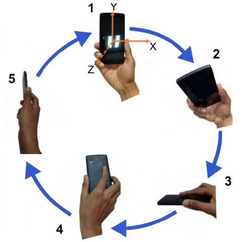

This calibration algorithm uses the normal motion of the three orthogonal axes of a stationary accelerometer sensor exposed to Earth’s gravitation field.
  • Step 1. Hold the device firmly as shown in position 1.
  • Step 2. Gently rotate the device by 180° around the YZ plane such that in position 4, the device is flipped to its back side.
  • Step 3. Rotate the device by 180° in a clockwise fashion around the XZ plane to reach position 1.
