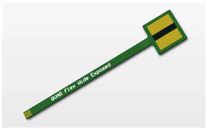

The electrode used in this application is shown in the figure below, it uses Q+ and GND pins to detect the charge variation and enables the INT2 interrupt to rise when Qvar detects the presence of the human body in contact with the electrode. It is printed on a flex board with the contact surfaces (in copper) exposed. In this way, in order to detect a touch gesture, it can be put in the area of the device that should be touched by the user. The goal of the design is to let the user touch both the Q+ and GND area at the same time. For this reason, many different designs are possible. The exposed copper areas at the tip of the board are the actual electrodes. When both of these electrodes are pressed, the sensor measures a high charge variation and the output signal is almost saturated. This saturated signal is comparable to the press of a button.

It is well known that electrode features such as size, shape and material are important factors that may produce different Qvar channel results. For instance, it exists a linear relationship between sensitivity and the electrode area. The sensitivity of the sensor is asymptotically increased with the area of the electrode. It is also well known that electrode features such as size, shape and material are important factors that may produce different Qvar channel results. For instance, it exists a linear relationship between sensitivity and the electrode area. The sensitivity of the sensor is asymptotically increased with the area of the electrode.The electrode used in this application is shown in the figure below, it uses Q+ and GND pins to detect the charge variation and enables the INT2 interrupt to rise when Qvar detects the presence of the human body in contact with the electrode. It is printed on a flex board with the contact surfaces (in copper) exposed. In this way, in order to detect a touch gesture, it can be put in the area of the device that should be touched by the user. The goal of the design is to let the user touch both the Q+ and GND area at the same time. For this reason, many different designs are possible. The exposed copper areas at the tip of the board are the actual electrodes. When both of these electrodes are pressed, the sensor measures a high charge variation and the output signal is almost saturated. This saturated signal is comparable to the press of a button.

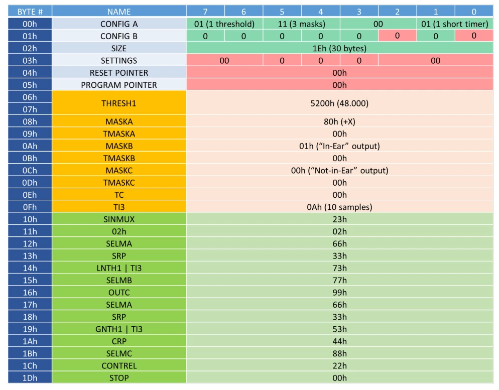

The in-ear detection state machine configuration the LSM6DSV16X is described in the following table.
In particular, the instruction for 10h to 1Dh are further explained here below:
- PP = 10h SINMUX command with argument 02h is performed without without needing a sample set. It is used to select the “external sensor” as input of the state machine. Since the QVAR_EN bit of the CTRL7 (16h) register is set to 1, the Qvar sensor is selected. In this case, the Qvar data is available as +X axis of the external sensor. PP = PP + 2.
- PP = 12h SELMA command is performed without without needing a sample set. The MASKA (80h) is selected. PP = PP + 1.
- PP = 13h SRP command is performed without without needing a sample set. The RESET POINTER is set to the next state, 14h. PP = PP + 1.
- PP = 14h LNTH1 | TI3 condition is performed with the need for a sample set. If Qvar data is lower than or equal to THRESH1, then PP = RP. If Qvar data is greater than THRESH1 for 10 consecutive samples, then the PP is increased (PP = PP + 1).
- PP = 15h SELMB command is performed without needing a sample set. MASKB (01h) is selected. PP = PP + 1.
- PP = 16h OUTC command is performed without without needing a sample set. An interrupt is generated, and the OUTS register is updated according to the selected temporary mask (01h). PP = PP + 1.
- PP = 17h SELMA command is performed without needing a sample set. MASKA (80h) is selected. PP = PP + 1. AN5755 Register configuration for FSM usage AN5755 - Rev 1 page 13/21.
- PP = 18h SRP command is performed without needing a sample set. The RESET POINTER is set to the next state, 19h. PP = PP + 1.
- PP = 19h GNTH1 | TI3 condition is performed with the need for a sample set. If Qvar data is greater than THRESH1, then PP = RP. If Qvar data is lower than or equal to THRESH1 for 10 consecutive samples, then the PP is increased (PP = PP + 1).
- PP = 1Ah CRP command is performed without needing a sample set. The RESET POINTER is cleared to its default value, 10h. PP = PP + 1.
- PP = 1Bh SELMC command is performed without needing a sample set. MASKC (00h) is selected. PP = PP + 1.
- PP = 1Ch CONTREL command is performed without needing a sample set. An interrupt is generated, and the OUTS register is updated according to the selected temporary mask (00h). PP = RP.

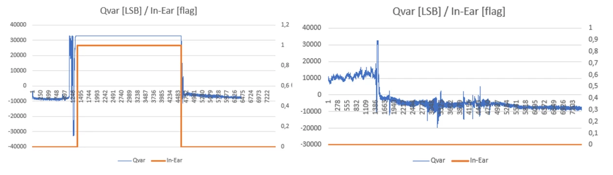

The following plots are examples of a signal response when the device is plugged in and removed from the ear (on the left) and when the device is just picked up from a desk (on the right). On the left side, the signal saturates when the device is in contact with the skin inside the ear, and the FSM returns 1 until the electrodes are removed from the ear, while on the right side the signal fluctuates when the device is handled but it does not saturate, so the FSM output does not rise.
