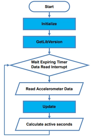

The central functionthat executes the AT algorithm is the following one:
void MotionAT_Update(MAT_input_t *data_in, MAT_output_t *data_out)
where *data_in parameter is a pointer to a structure with input data of type MAT_input_t (including AccX which is the accelerometer sensor value in X axis in g; AccY which is the accelerometer sensor value in Y axis in g and AccZ which is the accelerometer sensor value in Z axis in g); *data_out parameter is a pointer to a structure with output data (that is active equal to 1 if the user was active during the last algorithm run, otherwise it is equal to 0)

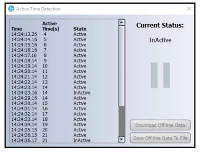

See below an example of the output of MotionAT library in Unicleo-GUI framework :fast_down_button:
