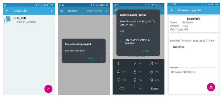

ST.box is on track with the most recent software solutions also in the field of Over-the-Air programming: firmware can be updated in a secure way on the ST.box. But let's see in which way.

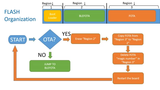

The BLEFOTA firmware can be updated Over-The-Air (FOTA) through an Android/iOS device via Bluetooth using the STBLESensor application: in more detail, the app sends the update and associated cyclic redundancy check (CRC) value, which the BLEFOTA checks against the hardware cyclic redundancy check calculation unit on the STM32L4 processor to ensure integrity. If the CRC calculation matches the STBLESensor CRC value, the new firmware is written at the beginning of the third Flash region. A “magic number” signals to the STBLESensor that a firmware update has been received and checked, and is ready to replace the current BLEFOTA firmware.
The BootLoader checks whether the "magic number" is present and, if the case, the BootLoader replaces the content of Region 2 (previous BLEFOTA firmware) with the content of Region 3 (new BLEFOTA firmware), then deletes the "magic number" present on Region 3 and restarts itself. If the magic number is not present, the BootLoader jumps to running the actual BLEFOTA firmware present on Region 2.

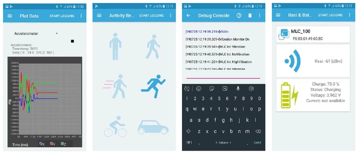

  • BLELowPower application: besides explaining how to use FreeRTOS and low power techniques to send the data to STBLESensor via Bluetooth, this application shows how to enable the capability of LSM6DSOX accelerometer to detect events like FreeFall, Single/Double Tap, WakeUp, Tilt and 6D orientation, also sending them to STBLESensor.
  • BLEMLC application, on the other hand, directly shows how to program the LSM6DSOX machine learning core. In particular, this sample programs the accelerometer to run an activity recognition algorithm or a vibration monitoring algorithm and to send the results to application. To enable the activity recognition algorithm on the MLC, you have to select the STBLESensor [Activity Recognition] tab. You can also work in debug mode using the STBLESensor debug console and writing the commands VibOn to initialize the vibration monitor algorithm, and VibOff to switch the vibration monitor algorithm off.
For debug purposes, as side feature, note also that both BLELowPower and BLEMLC applications enables the USB Virtual Com Port (VCP) to visualize printf to a Terminal (for example Tera Term) to control the initialization and connection phases and, at the boot, to define the name the STEVAL-MKSBOX1V1 will use for Bluetooth advertising. To enable the VCP, it is necessary to recompile the code, enabling the compilation define called STBOX1_ENABLE_PRINTF at the beginning of the BLELowPower/Inc/STBOX1_config.h or the BLEMLC/Inc/STBOX1_config.h file.

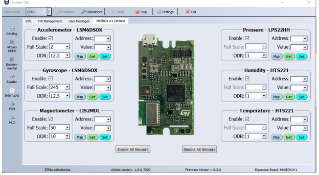

6. Pro-mode (Mode 3) expanded - merging ST.box and Unicleo-GUI

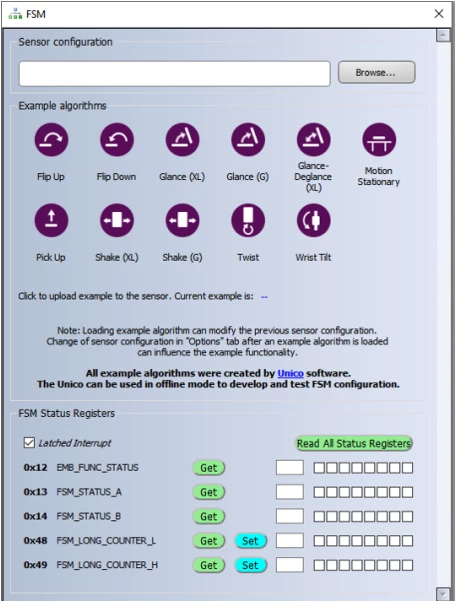

This paragraph presents the DataLogExtended sample application. This pro-mode firmware pack implements the dialog (via USBD Virtual Com Port) with the Unicleo-GUI running on a PC connected via USB to the ST.box eval board, visualizing all the sensor data streamed from the board.
In these way all the Unicleo-GUI features described in this past post apply also to SensorTile.box platforms, allowing the user to go deep to ST.box feature. For example, it is possible to exploit all the DSOX features such as the FSM and the MLC digital features.
