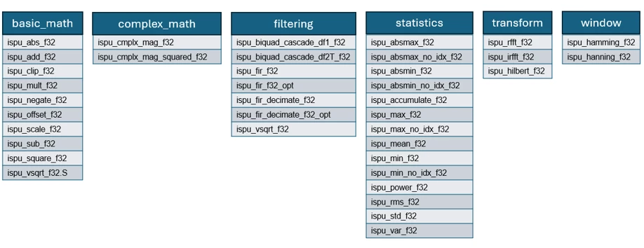

The intelligent sensor processing unit (ISPU) 2.0 DSP package provides a solid set of ready-to-use signal processing functions. The library is divided into six modules that cover the most common needs in embedded applications, as shown in the image below.
All these functions are implemented in assembly and use the hardware acceleration features described later. In practice, these algorithms are more efficient in power consumption and processing speed than standard raw C versions.
These functions are also easy to use in a typical application. In the st-mems-ispu repository, a wide range of examples shows how to use these functions on the ISPU 2.0.
To use these functions, add the ispu_dsp folder to the project root and include the ispu_dsp.h header file. This approach provides access to these functions without requiring knowledge of their assembly implementation. The application can call them as standard C functions declared in the header file.

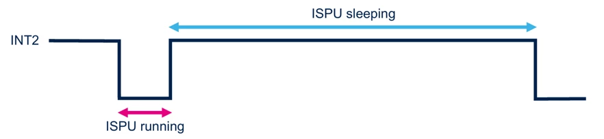

}When an ISPU program runs on the IIS3DWB10IS sensor, the execution time of a given algorithm can be measured. To do this, first enable the ISPU sleep signal with the following command in conf.txt:
ispu_sleep_int2 enableAfter that, the INT2 pin of the IIS3DWB10IS sensor reflects the current state of the ISPU: running or sleeping. Because the default value of INT_ACTIVE_LEVEL is 0, a digital level HIGH level indicates that the ISPU is sleeping. A digital level LOW indicates that the ISPU is running, as shown in the image below.
The execution time can be estimated by using a logic analyzer, an oscilloscope, or a timer on an external microcontroller to measure the duration of the LOW pulse on the INT2 pin.

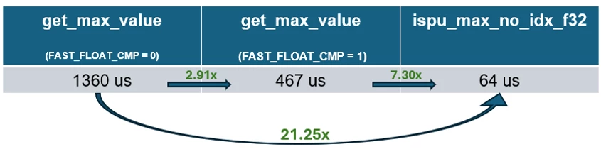

The baseline time measurement for the execution of the get_max_value() function on a vector of 250 floats is 1360 us.
The first optimization to improve the performance, is to enable a compiler flag in the Makefile. The ISPU-Toolchain includes the FAST_FLOAT_CMP flag, which speeds up comparisons between two floats by using dedicated instructions in the instruction set. This optimization is important because get_max_value() performs many comparisons between floating-point values: the array elements are compared with the current maximum value. When the FAST_FLOAT_CMP flag is set to 1, benchmarking of the ISPU program already shows a significant improvement: the execution time decreases from 1360 us to 467 us, which makes the program approximately three times faster.
The real optimization and improvement, however, comes when the dedicated ISPU DSP functions are used. These functions exploit not only the optimized instruction set but also other hardware accelerators.
In the GitHub examples for the IIS3DWB10IS, one example shows the use of the ispu_max_no_idx_f32(). This function behaves exactly like the get_max_value() described above, but it uses optimized assembly instructions and hardware accelerators. The ispu_max_f32() function can also be used. In addition to the maximum value, it returns the position, or index, in the array. For simplicity, the following text uses the ispu_max_no_idx_f32() function, which returns only the maximum value.

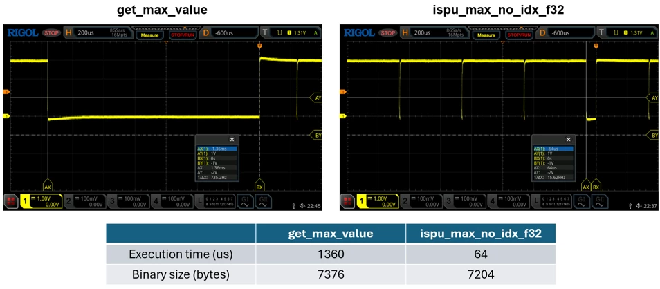

When the recommended ispu_max_no_idx_f32() function is called, the execution time drops dramatically. The ISPU now takes 64 us to execute this algorithm, which makes it approximately 21.25x faster.
The figure shows the INT2 trace captured with an oscilloscope when an array of 250 floating-point values is processed by standard C code (left) or by the dedicated function in the ISPU DSP package (right). INT2 low indicates the ISPU runtime.
The short pulses, with a duration of 4.5 µs, correspond to the ISPU capturing the accelerometer samples and storing them in the array. The long pulse corresponds to the execution time of the function that computes the maximum value. This function is called only after the array is filled with 250 samples.
In addition to reducing the execution time by more than 21x, using the ISPU digital signal processing (DSP) function also reduces the overall binary size.

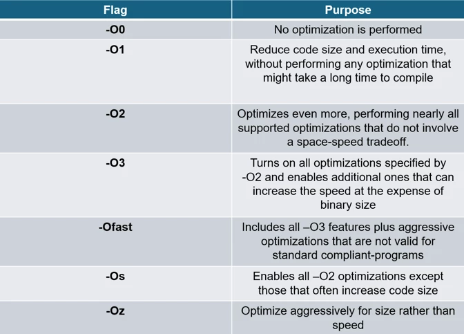

With the ISPU-Toolchain, the usual optimizers available in the GNU Compiler Collection (GCC) compiler can also be enabled by using the -O flags to balance execution speed and binary size. The table below summarizes the available optimization levels.
The recommended optimizer in the ISPU-Toolchain is the -O3 flag, which is set by default in all Makefile examples. The -Ofast flag does not ensure that the IEEE standard is respected. Therefore, use it only for experimental and testing purposes. To reduce binary size, use the -Os flag.
