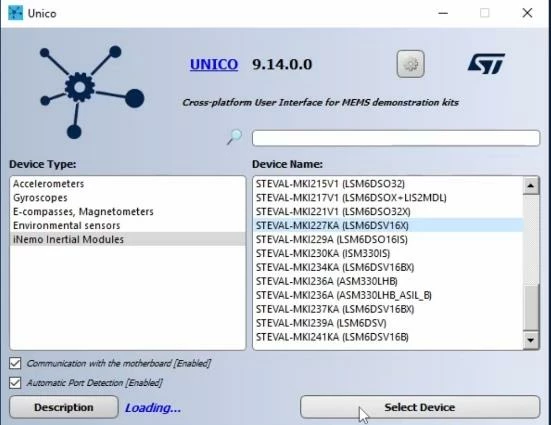

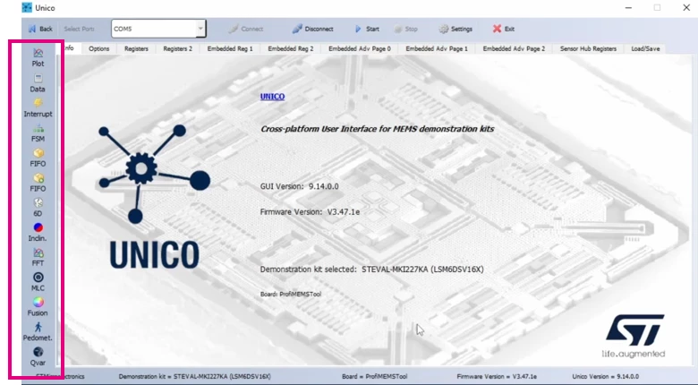

After opening Unico-GUI it is needed to select the device LSM6DSV16X with its adapter board, the STEVAL-MKI227KA.

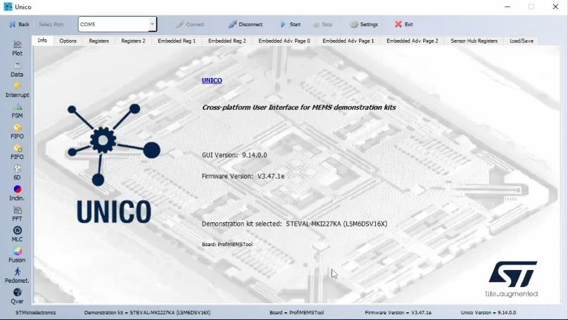

Once pressed on “Select Device” button, it is possible to see on the left hand side all the in the edge functionalities of the device: FSM, MLC, Pedometer, Sensor Fusion, Qvar.
Clicking on the Start button on the top bar we are enabling the communication between the STEVAL-MKI109V3 with the STEVAL-MKI227KA and our PC.

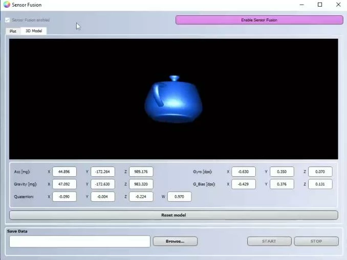

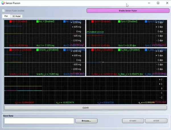

It is now needed to click on the fusion tool and then on “Enable sensor fusion” button.

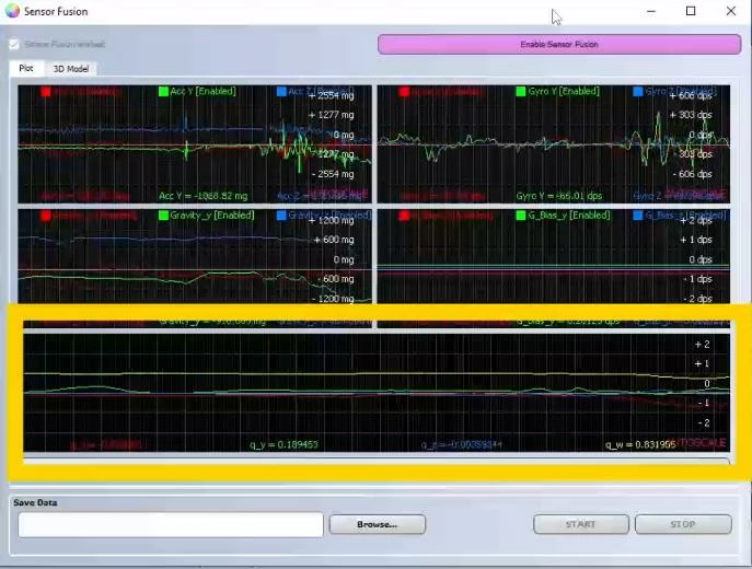

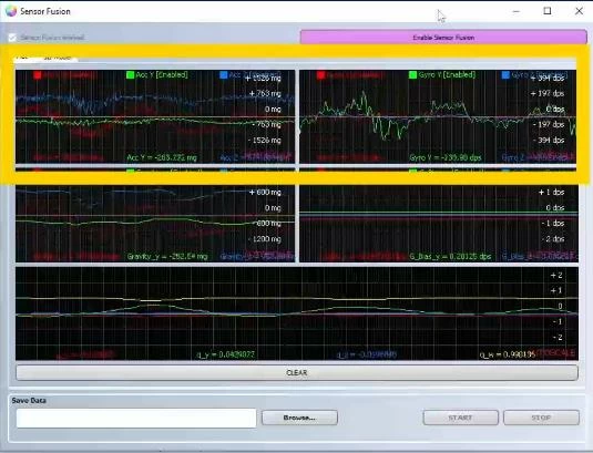

Data coming from the sensor in real time are now streaming and it is possible to see many graphs
On top we can see the accelerometer and gyroscope raw data plots in the top.

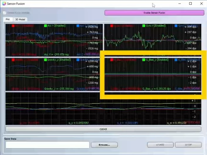

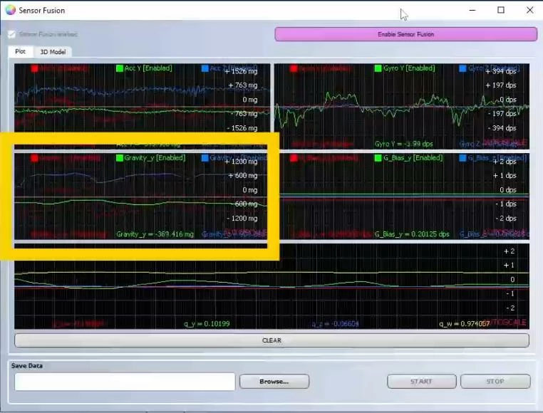

The gravity vector and the gyroscope bias plots in the middle. The first represents the gravity projection along the 3-axes of the device: it is computed by fusing the accelerometer and gyroscope data to generate a sort of acceleration signal that is not affected by linear accelerations, which is a mandatory requirement in tracking applications.
The second plot shows the computed gyroscope offsets which are subtracted by the gyroscope signal to avoid gyroscope drift in time.
Finally, the quaternion data is displayed at the bottom. Data can be converted in the roll, pitch and yaw angles representing the absolute orientation of the device in space.
Finally, by clicking on the 3D mode button it is possible to see real time a teapot moving in space.

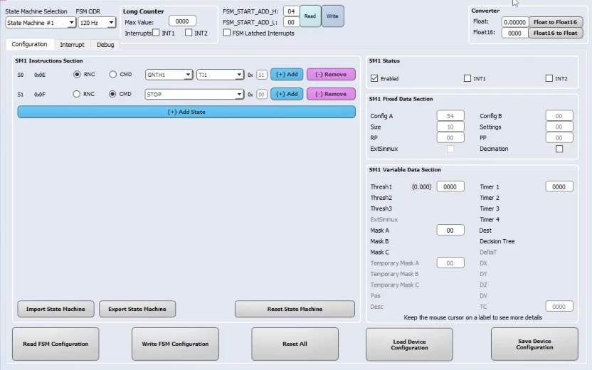

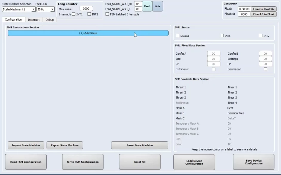

After clicking on the FSM button, the FSM screen will open

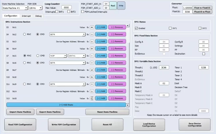

The first step is to align the FSM ODR to the sensors ODR, which is 120 Hz.

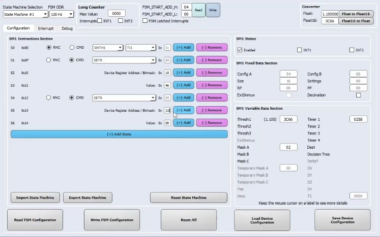

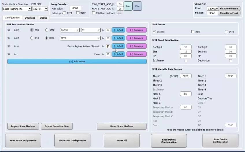

Now we can start building the program. Since the device starts in a wake state, where accelerometer and gyroscope sensors are in high-performance mode, we need the device to enter in a sleep state, meaning that only the accelerometer is kept on in low-power mode. The sleep state will be enabled when the device is kept stationary for a while, for example 5 seconds.
To enter the sleep state, the first instruction of the FSM will be a GNTH1 | TI1 condition. The configured threshold is 1.1 g applied on the accelerometer norm signal, and the timer is 600 samples (which means 5 seconds at 120 Hz). Anyway, you can refer to the AN5882 for getting more details about the FSM conditions.

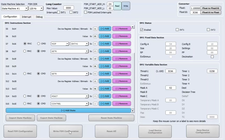

The next instruction will be reached when the device is stationary for 5 seconds. When it happens, we want to turn off the gyroscope and to set the accelerometer in low-power mode. For this purpose, two consecutives SETR commands are issued, one for changing the accelerometer power mode, and one for turning off the gyroscope.
Then, we need to configure a wake-up able to set the accelerometer and gyroscope sensors back to 120 Hz in high-performance mode. In this case, the wake-up condition will be a NOP | GNTH1, using the same threshold used before. Once the wakeup signal is detected, we need to configure other two consecutives SETR commands to change again the sensors configuration.
Finally, we need to reset the program by using the CONTREL command. To avoid generating an interrupt, the MSKIT command is issued before the CONTREL command.

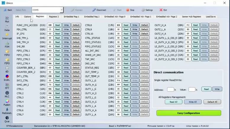

To allow the FSM writing the device registers using SETR commands (which means enabling the ASC feature), we need also the set the FSM_WR_CTRL_EN bit available in the FUNC_CFG_ACCESS register. Let's go to the Registers tab to set manually this bit to 1.
