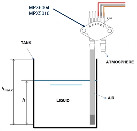

In the figure above, a differential pressure sensor is used to measure the height of water in a wash tub. The open end of a vertically oriented pressure sampling tube is positioned at the base of the tub. As the tub fills, pressure builds within the sampling tube. An air bubble or “air gap” in the sampling tube is intentional here. It prevents the direct contact of water with the MEMS pressure sensing element.
Note: Because air is compressible, the water enters upward at the base of the sensing tube to take up the space vacated by the compressed air. This means the "zero point" or the bottom of the air column shifts upward. This is a trivial error for most applications but can otherwise be characterized and calibrated out.
The pressure measured at the base of the tub is a function of the height of the water (the weight of the water) and the atmospheric pressure. In this case, the weight of our atmosphere pushing down on the surface of the water. By using a differential pressure sensor, with one port open to the atmosphere – the subtraction of the atmosphere’s contribution from the pressure measured at the base of the sampling tube is automatic. We end up with a pressure reading that is purely a function of the height of water in the tub.

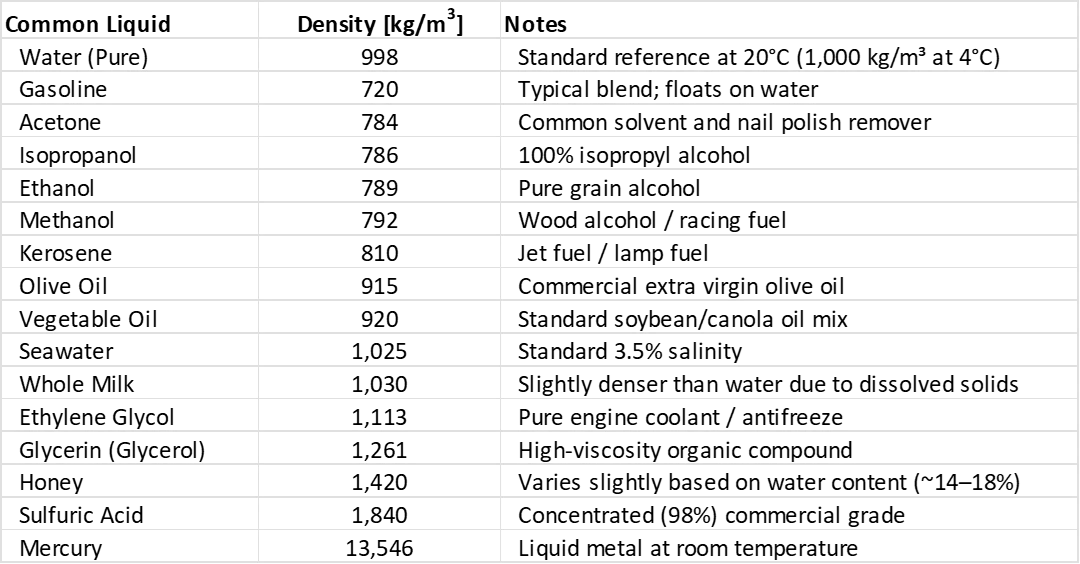

The physics holds for measuring the tank fill level of any liquid. Just be sure to plug in the correct density value for the liquid of interest. If ultimate accuracy matters in your application, then keep in mind that density varies with temperature for nearly all liquids. The volumetric thermal expansion coefficients are not conveyed in the table below. The effect is trivial for most applications.
Since atmospheric pressure is not a constant, it changes with altitude and weather conditions, we must null the effect out of the measurement. Using a differential pressure sensor can be a reasonable strategy. Referencing the image above, one port of a differential pressure sensor is exposed to the atmosphere, the other port exposed to the pressure in the vertical sensing tube. The reported pressure then is just the difference between these two pressures – just exactly what we are looking for. The pressure reading that we use for measuring the height of water is valid regardless of altitude or weather changes.

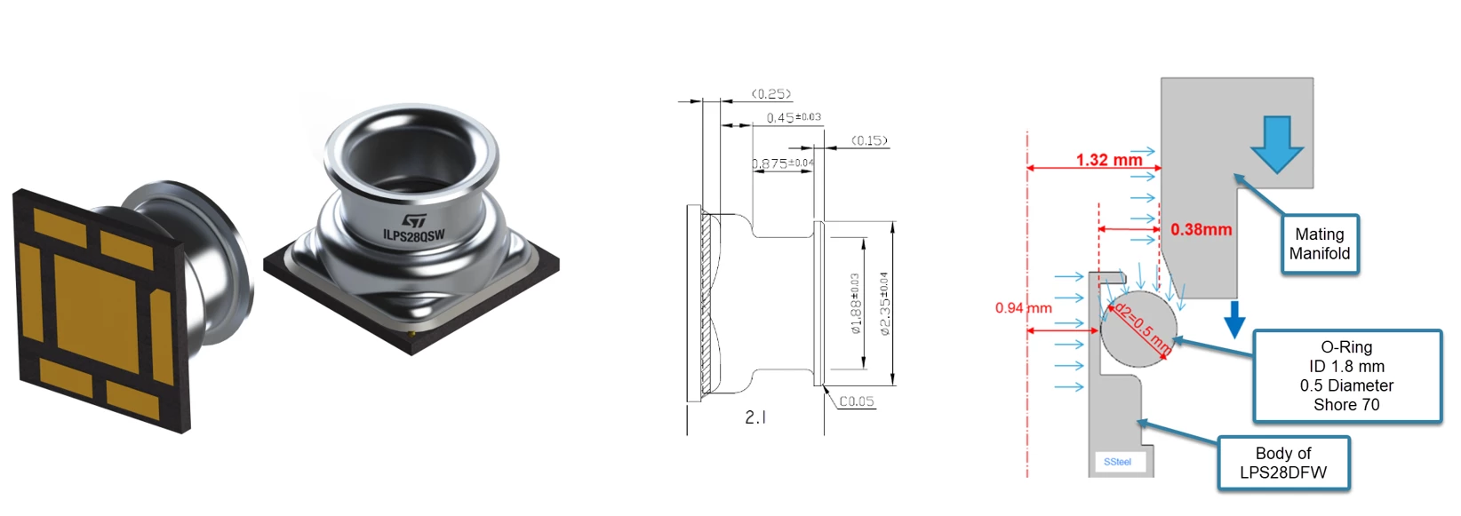

Most modern absolute pressure sensors on the market today have only a small orifice in the package lid. They do not include a nozzle or barbed nipple for the direct attach tubing. If the application requires the pressure signal to be conveyed by tubing, then it is up to the system designer to include a cap. The cap is typically glued to the PCB, providing a pressure chamber around the sensor. There are however a few modern sensors that do include mechanical accommodation for remote pressure conveyance. ILPS28QSW is one such device.
The figure above shows some of the mechanical and O-Ring details of the 2.8 x 2.8 mm 7-pin LGA package of ILPS28QSW. For more detailed applications information, refer to the following documentation:
