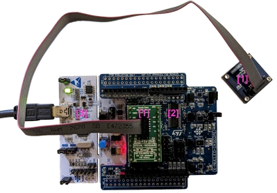

Hardware
The following hardware components are used:
[1] STEVAL-MKI230KA, which is the DIL24 adapter board for ISM330IS, the industrial IMU MEMS sensor with ISPU;
[2] The industrial motion MEMS sensor expansion board X-NUCLEO-IKS02A1;
[3] NUCLEO-F401RE, STM32 Nucleo development board.

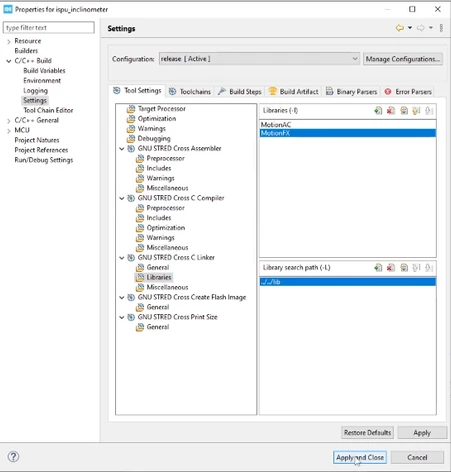

If you go back to STM32CubeIDE, right-click on the name of the ispu_inclinometer project inside the project explorer window: click on properties. Then click on settings inside the section C/C++ build and finally on libraries under the section GNU STRED Cross C Linker in settings inside the section C/C++ build. Now, click on the add button in the libraries section on the right-hand side of the properties window and call it MotionFX. To finalize this step, click on apply and close.

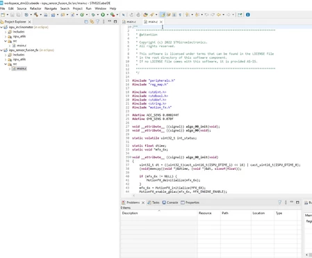

You can now modify the code. First of all, open the main.c file inside STM32CubeIDE. Then import the sensor fusion example (sensor_fusion_6x) in the project by selecting its Eclipse folder inside the x-cube-ispu folder. Open its main.c file.
Open the two main.c file (the one of ispu_inclinometer project and the one of ispu_sensor_fusion_6x project inside the project explorer section), side by side.
Start integrating by copying from the ispu_sensor_fusion_6x project to the ispu_inclinometer project the following lines of code:
