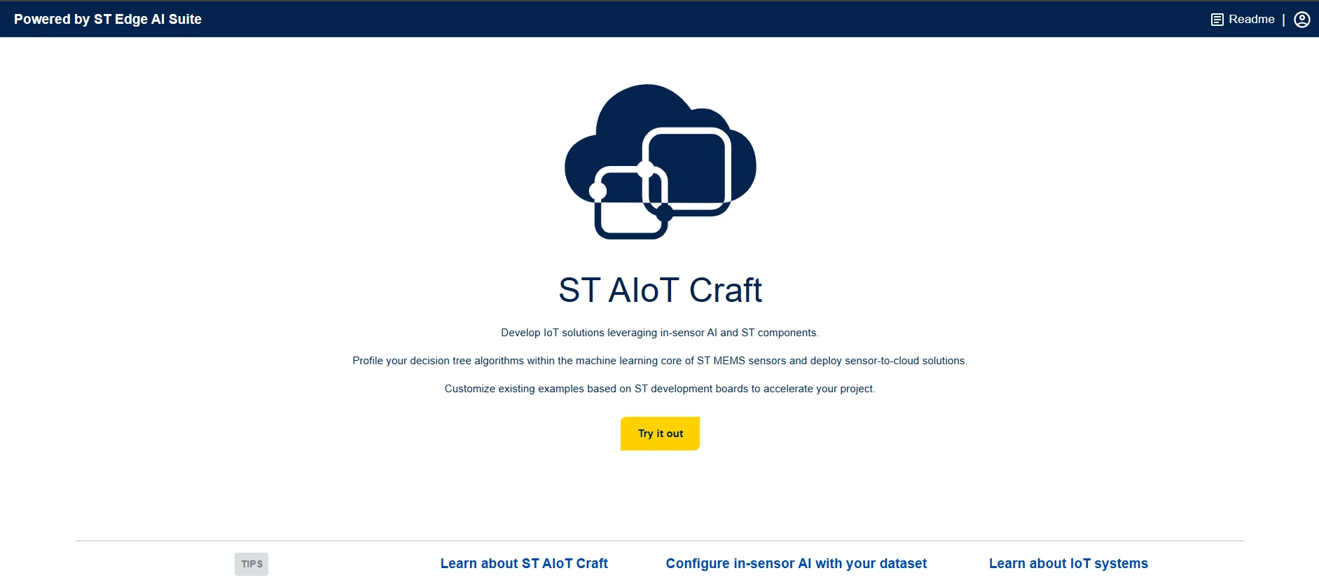

Access the tool by clicking on the following link: https://staiotcraft.st.com/index.html.
Figure 1. ST AIoT Craft home pageFigure 1. ST AIoT Craft home page
On the [Readme] button in the top-right corner you can access the ST AIoT Craft documentation pages. Here is a list of examples:
Coming back to the homepage, click on the [Try it out] button to enter into the tool, as shown in Figure 1.

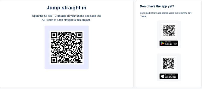

If you select the mobile app journey experience, some QR codes are displayed. In particular, on the right, you can find the installation QR code of the mobile app.
Figure 3. ST AIoT Craft mobile appFigure 3. ST AIoT Craft mobile app

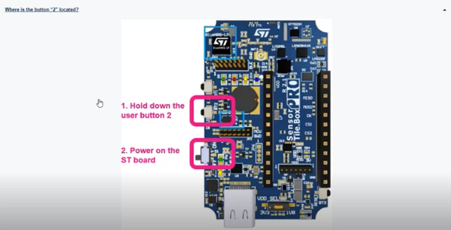

1. Connect the SensorTile.box PRO to the PC through a USB Type-C® cable.
2. Turn on the board in the DFU mode to flash the firmware.  Hold down the user button 2 and power on the ST board through the power switch of the SensorTile.box PRO, as shown in the figure below:
Figure 4. Entering DFU mode with SensorTile.box PROFigure 4. Entering DFU mode with SensorTile.box PRO

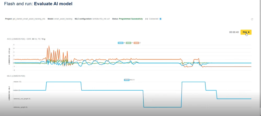

3. Start the evaluation phase
Click on the [Start] button.
The states are recognized based on the placement and movement of your SensorTile.box PRO.
  • If you shake the board, the shaking class is correctly recognized.
  • If you move the board, the motion class is recognized.
  • If you place the board in an upright stationary way on your desk, the stationary upright class is recognized.
  • If you place the board in a not upright stationary way on your desk, the stationary not upright class is recognized.
Figure 5. Evaluate AI modelFigure 5. Evaluate AI model
By clicking the [Stop] button, you terminate the evaluation of this AI model. The following view appears as shown below:

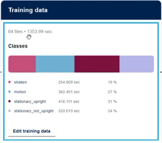

For the training process, we need to use data. Inside the left-most block "Training data" you can see 64 files of data for a total acquisition time of 1353.99 seconds, as shown in the figure below:
Figure 6. Training dataFigure 6. Training data
We have collected the data for these four classes and the dataset is well balanced.

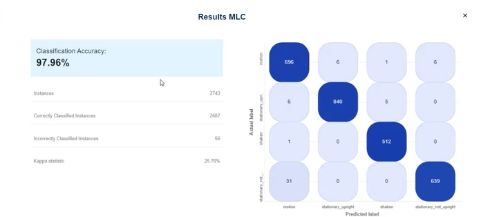

After training the AI model, it has a classification accuracy of 97.96%.
Figure 8. Classification AccuracyFigure 8. Classification Accuracy
You can download the results of the training process by clicking on the [Download configuration files] button. This initiates an .ucf file download which has been used to program the board. Additionally, a .h file that is useful to develop your own firmware application.
You can expand the results by clicking the white and blue button in the rightmost box [Results].
This allows you to check statistics like the confusion matrix and other metrics. Other metrics include instances, correctly classified instances, incorrectly classified instances, and the kappa statistic.
Figure 9. Results MLCFigure 9. Results MLC

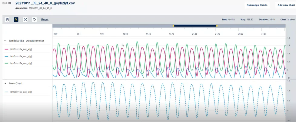

You can also view the files by selecting the tab called [Data logs].

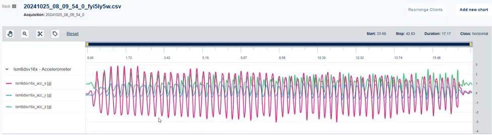

You can view a set of .csv files, one for each class. You can look at the data by clicking on the [Open data visualizer] on the right side, as shown below.
Figure 12. Open data visualizer button in correspondence to the shaken class rowFigure 12. Open data visualizer button in correspondence to the shaken class row
Click on [Start with default charts].
The file only contains accelerometer data and you can customize the view. For example, you can zoom in on the data and move the timescale.
You can add a new chart by clicking on the [Add new chart] button. A pop-up window appears. Here you can select [lsm6dsv16x - Accelerometer] as sensor and [x] as the dimension. For colors and styles, select [Blue color] as [Line Color] and [Dashed] as [Line Style]. Click [Save] to save these settings. The resulting charts are synchronized:

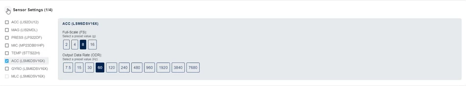

Configure the settings of your sensor by expanding the [Sensor Settings] menu. Select the accelerometer of the LSM6DSV16X IMU (FS = 8 g and ODR = 60 Hz).
Figure 14. My datasets - Log data to create a new datasetFigure 14. My datasets - Log data to create a new dataset

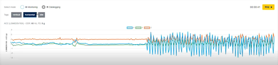

Now, you can start acquiring data which is stored temporarily in the local file system on your PC. Then, you can upload data to the cloud.
To proceed, click on the [Start] button. You need to select the folder where the data should be stored. Click on [View files, Save Changes] in the pop-up window. You can collect 20 seconds for each class, that is, idle, horizontal, and vertical classes.
Now, do not move SensorTile.box PRO while it is acquiring data for 20 seconds. After 20 seconds, click on the idle tag to stop the acquisition for this class.
Start with acquiring of the horizontal movements by clicking on the horizontal blue tag. While you acquire data for 20 seconds, perform horizontal movements by moving horizontally the board with your hand. Then stop the acquisition by clicking on the horizontal tag.
Figure 15. My datasets - datalogging the horizontal stateFigure 15. My datasets - datalogging the horizontal state

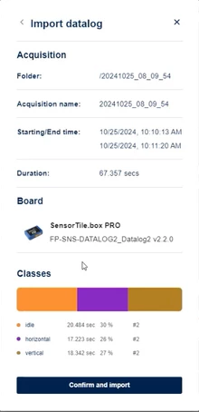

The summary of your acquisition pops up. As you can see in the lower section of the pop-up, you collected a balanced dataset among the three different classes idle, horizontal, and vertical.
Figure 16. Summary of your data acquisitionFigure 16. Summary of your data acquisition
Now, you can import your data. To do that, click on the blue button [Confirm and import].
The data has been uploaded and locally saved in binary format.
