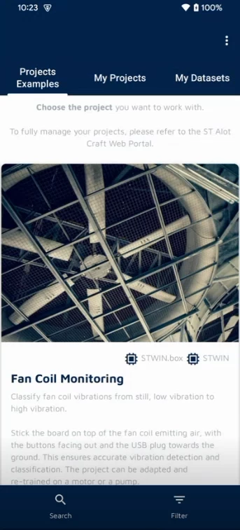

The following figure displays the main page of the app: in this view there are three main tabs, [Projects Examples], [My Projects], and [My Datasets].

Inside the [Projects Examples] tab there’s a list of projects coming from the web portal.
For each project, there’s a title, a project description, and tags where there are the labels of the AI model output (horizontal, vertical, idle board position). Additionally, the boards that are compatible with each project.
You can select a particular project, try the pretrained model, validate it, and customize it.

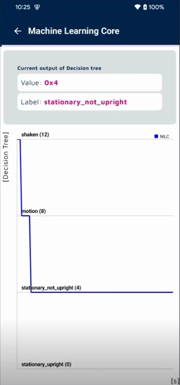

You can play with the model by checking the correct detection of the different classes, as shown in the following figure.
Figure 3: Machine Learning core: output of the decision tree

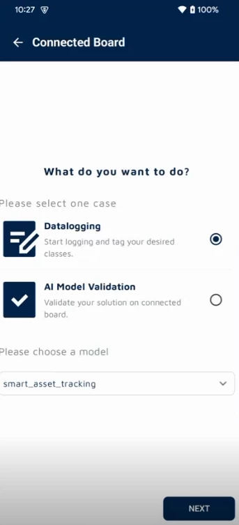

Select the asset tracking project, which has been cloned before and select your board, for example, your SensorTile.box PRO. In the following view you can select the [Datalogging] option, because we want to log new data. This new data will be uploaded to the dataset associated to that specific project to be able to retrain the project and revalidate the model.
Figure 4: Connected Board - Datalogging

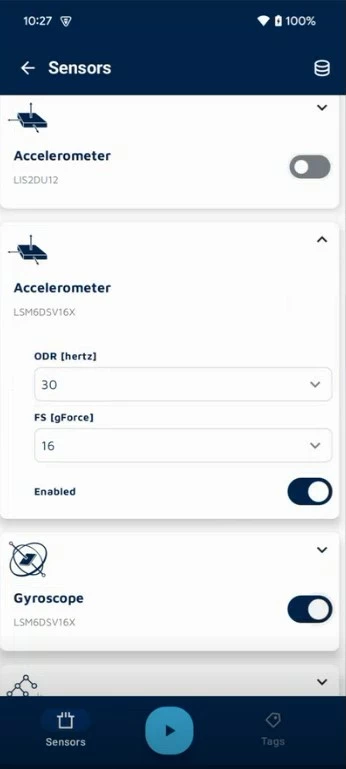

If you click on [Next], there’s a list of sensors placed on your board and for each sensor you can select a specific output data rate (ODR) and full scale (FS).
In this case, select the accelerometer of LSM6DSV16X with ODR = 30 Hz and FS = 16 g and the gyroscope of LSM6DSV16X. After that, press the [Play] button.
Figure 5: Enabling the Accelerometer and Gyroscope of LSM6DSV16X

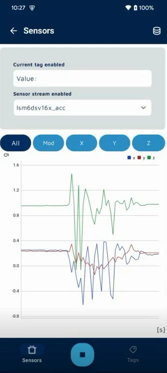

Now, the device is logging. If you select for example the accelerometer of LSM6DSV16X, lsm6dsv16x_acc, you can see the real-time data in a graphical way.
The plotted data is the accelerometer data coming from the board.
Figure 6: Plotting LSM6DSV16X accelerometer and gyroscope data with tagging enabled

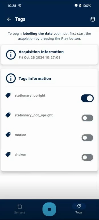

You can also select the [Tags] tab in the bottom right corner where you can tag your data.
For example, suppose that the board is still in stationary_upright state. You can flag the stationary_upright tag as shown in the following figure.
Figure 7: Labelling data
Similarly, if you move your board by shaking it, you can flag the shaken tag.

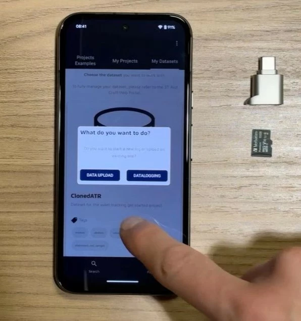

To put the data on the web portal, first you need to extract the microSD™ card from your SensorTile.box PRO and read its content using a microSD™ card reader, as shown in the following figure. By selecting the [My Datasets] tab, you can see ClonedATR that is the dataset associated to this project. Click on the pictogram of the silos, then on [Data Upload] in the pop-up window.
Figure 8: Data Upload

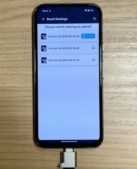

- Choose the datalog to be uploaded and upload it by clicking the uploading button near the datalog name. When the process is completed, a light-blue badge associated to that specific log appears near to the datalog name, as shown in the following figure.
Figure 9: Choose which datalog to upload
