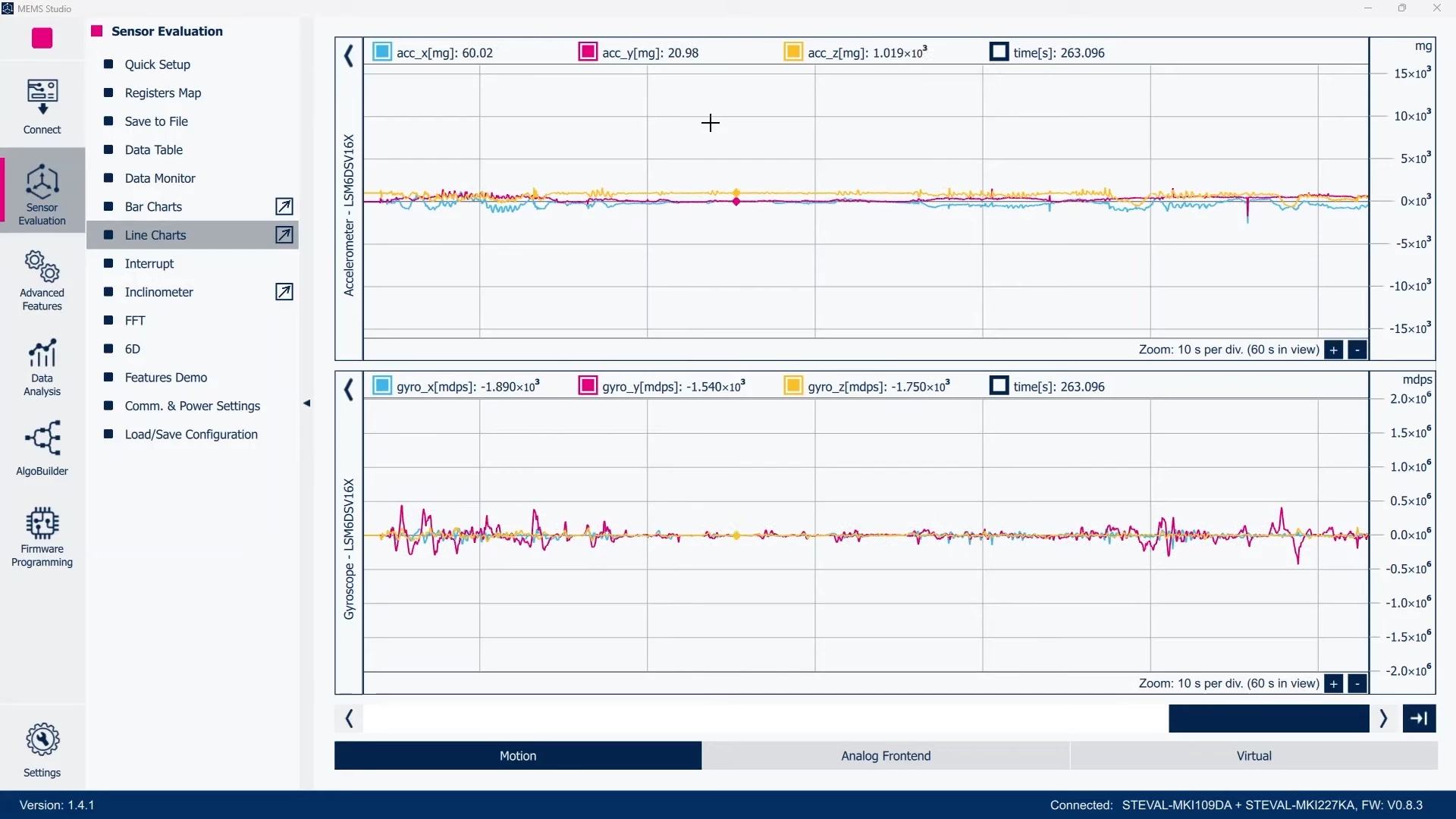

  • Showing sensor outputs in a graphical user interface, perform data logging and data analysis.
Figure 1: MEMS Studio - Sensor Evaluation, Line ChartsFigure 1: MEMS Studio - Sensor Evaluation, Line Charts

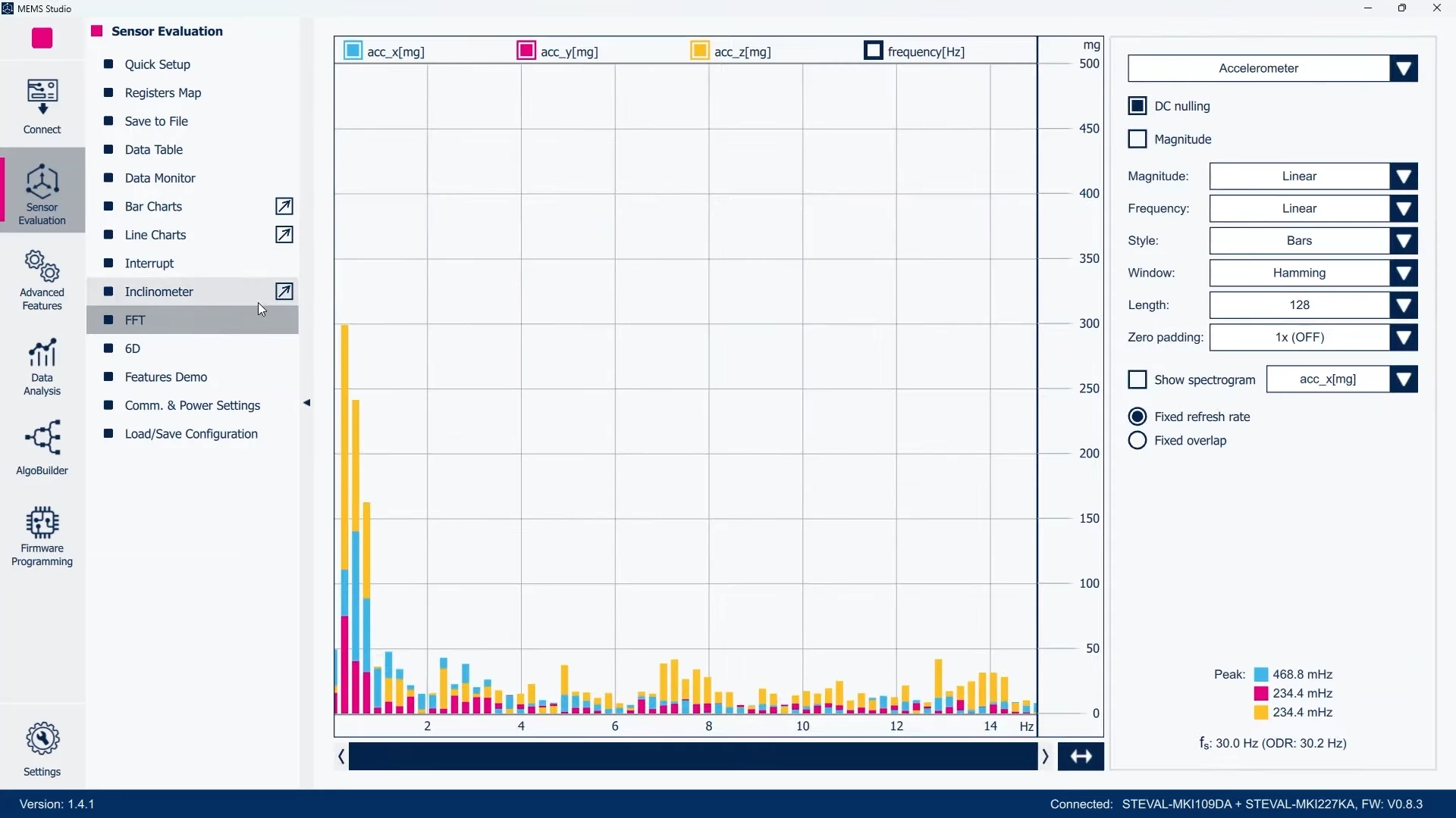

  • Setting up a sensor configuration, or configuring the advanced features available in the latest MEMS sensors.
Figure 2: MEMS Studio - Sensor Evaluation, FFTFigure 2: MEMS Studio - Sensor Evaluation, FFT

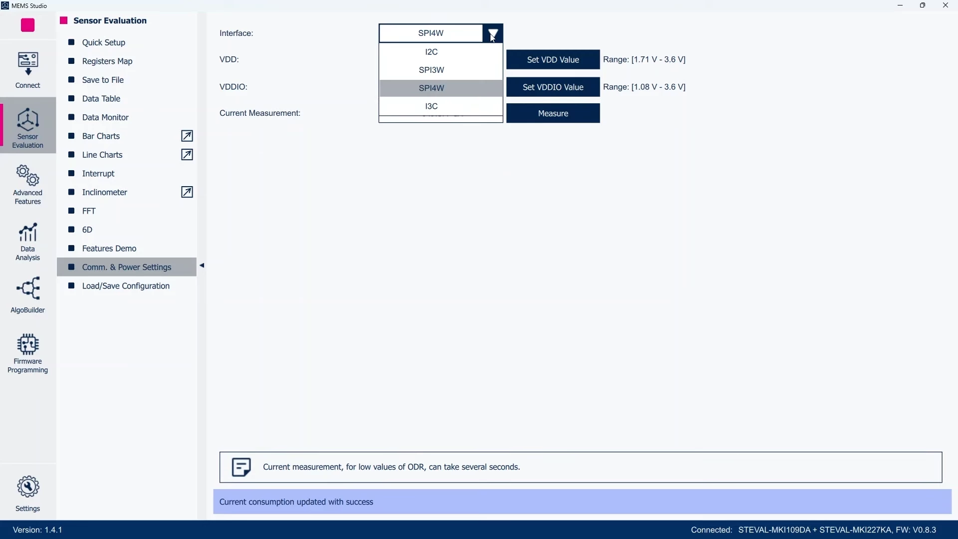

The STEVAL-MKI109D is the successor of the STEVAL-MKI109V3, and it continuously supports functionalities like:
  • A programmable voltage power supply.
  • An on-board dedicated circuitry for current measurement tests.
  • Communication protocol changes on the fly.
Figure 3: MEMS Studio - Sensor Evaluation, switch communication interfaceFigure 3: MEMS Studio - Sensor Evaluation, switch communication interface

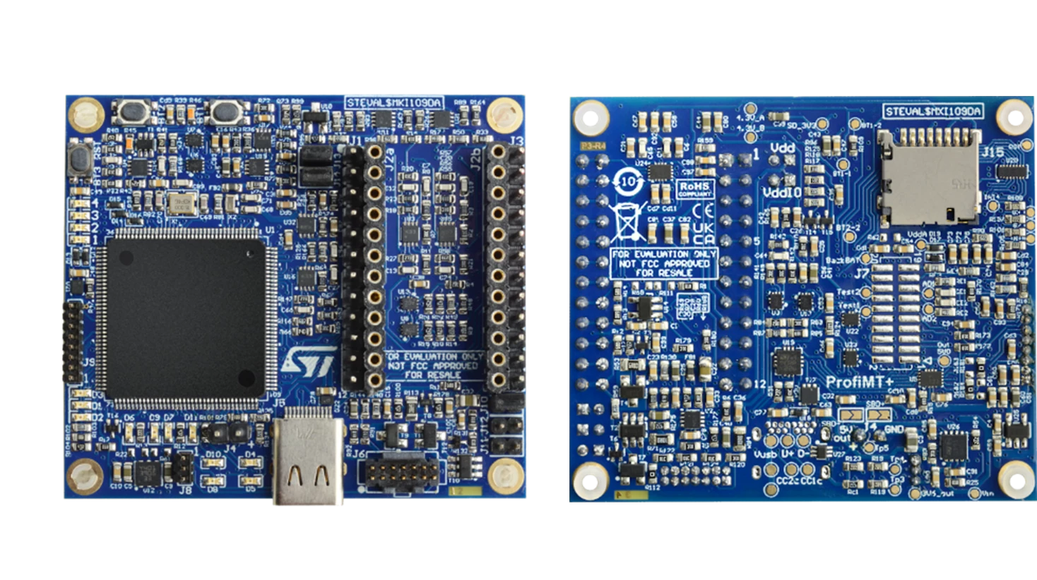

Compared to the previous STEVAL-MKI109D generation, some additional features are available:

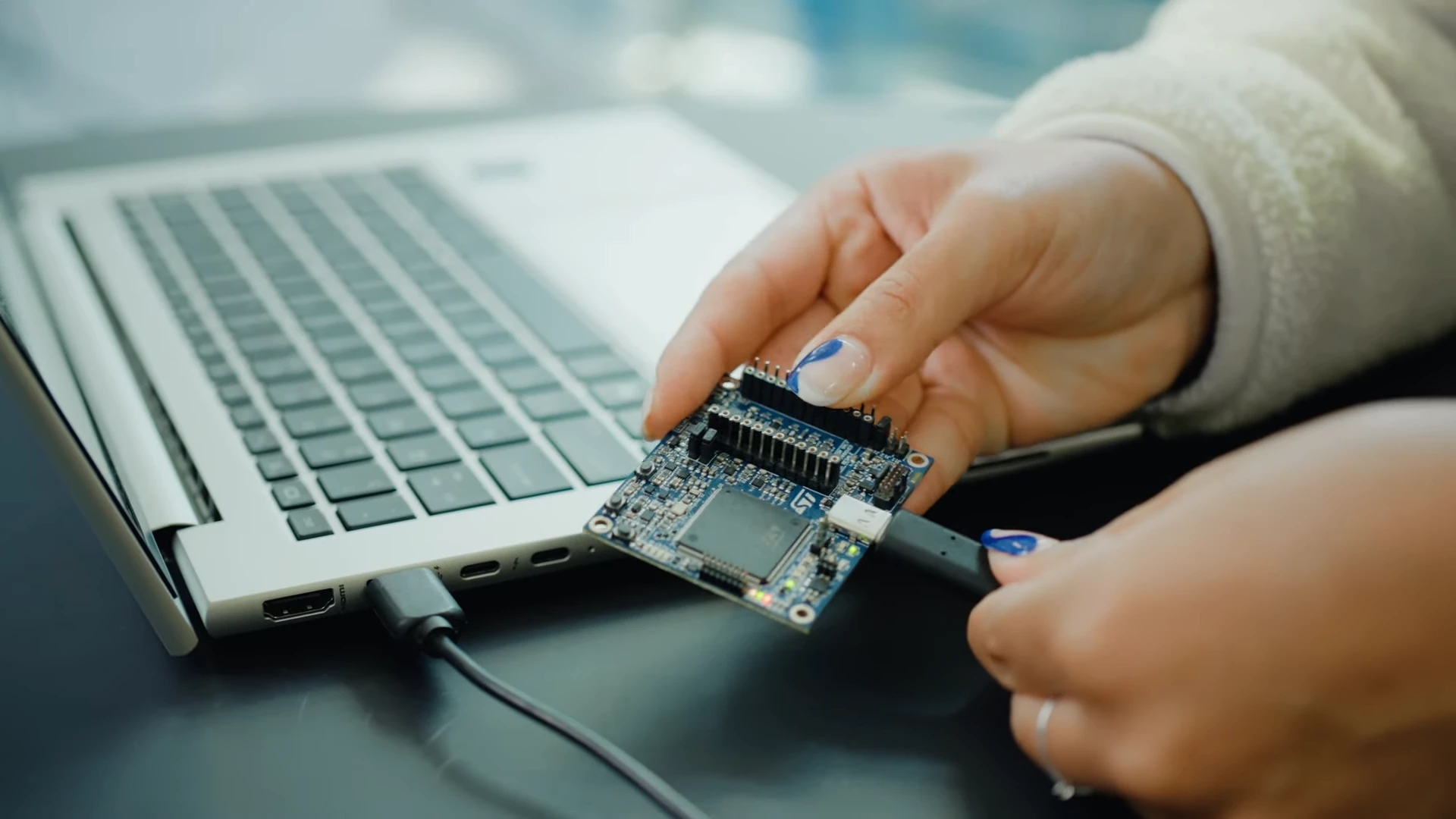

Figure 4: STEVAL-MKI109DFigure 4: STEVAL-MKI109D
  • A STM32H5 MCU controls the board.

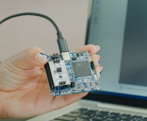

  • A USB Type-C® cable establishes a connection to the PC.
Figure 5: Connecting STEVAL-MKI109D to the PC through a USB type C cableFigure 5: Connecting STEVAL-MKI109D to the PC through a USB type C cable
  • STEVAL-MKI109D now supports I3C in addition to I²C, SPI, and TDM.

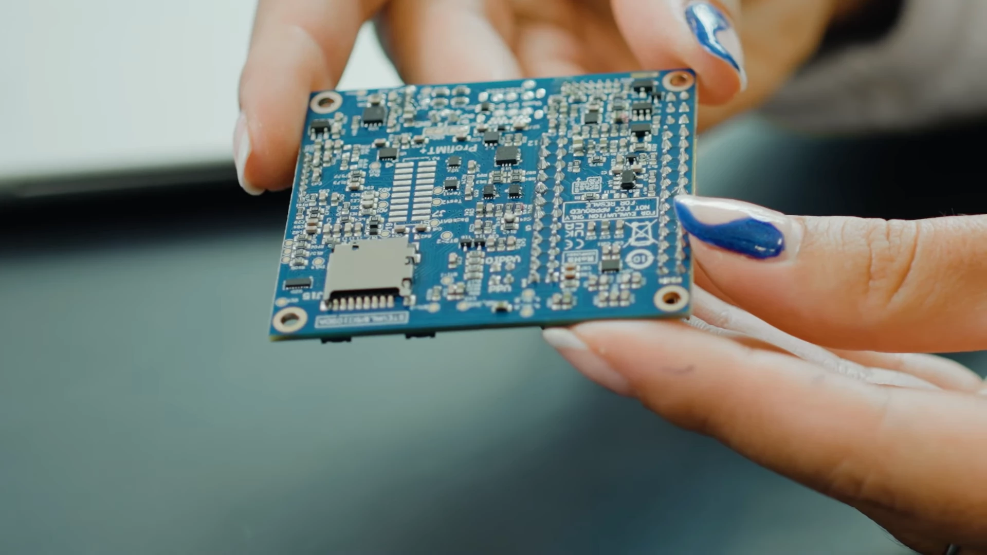

  • An SD card slot is available on the back side of the board.
Figure 6: An SD-card slot is available on STEVAL-MKI109DFigure 6: An SD-card slot is available on STEVAL-MKI109D
  • The board can be programmed with different tools like STM32CubeProgrammer or MEMS.

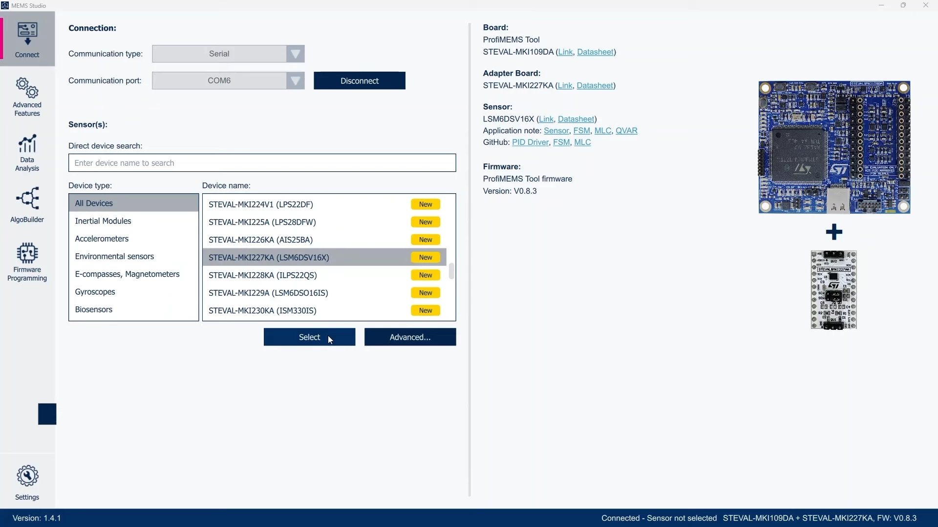

Now MEMS-Studio and select STEVAL-MKI227KA (LSM6DSV16X) as the device name, shown in the picture below:
Figure 8: MEMS Studio - ConnectFigure 8: MEMS Studio - Connect

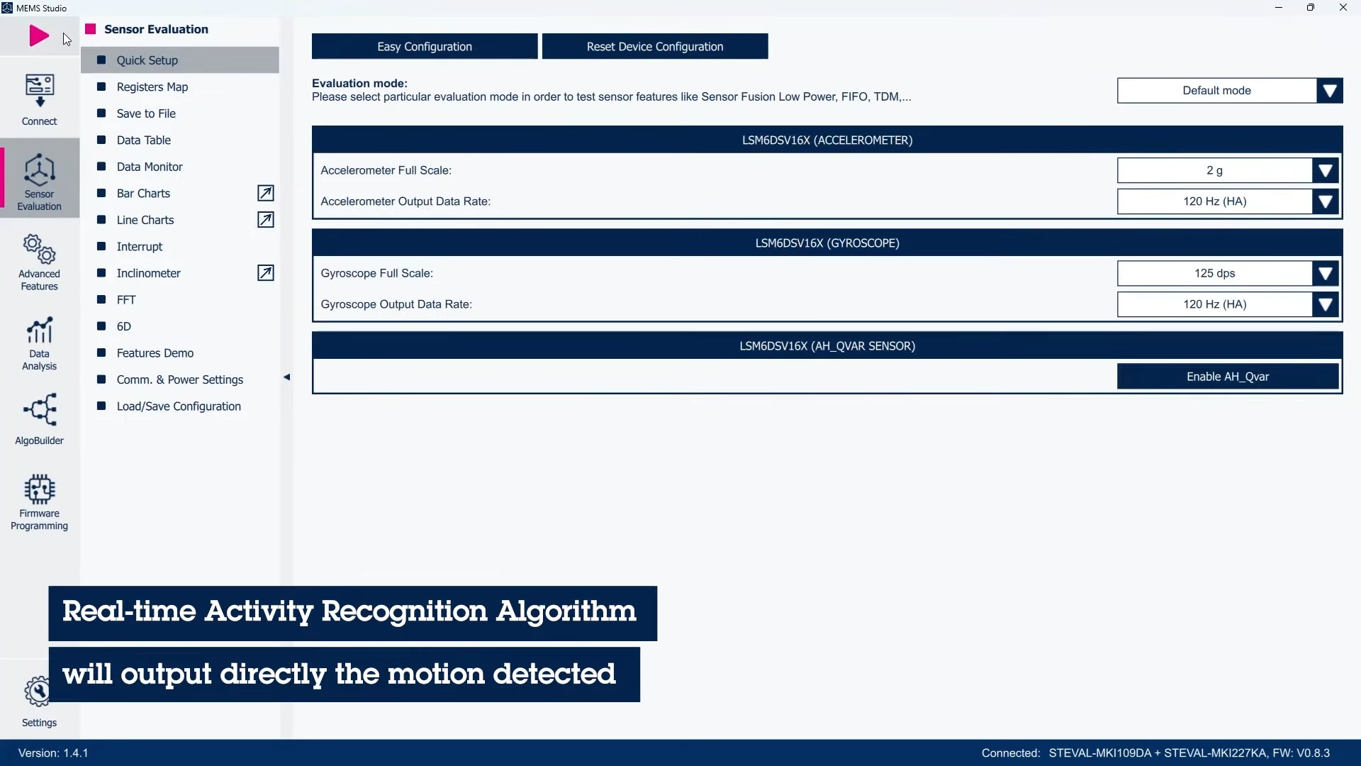

After selecting the device, click the start button to enable STEVAL-MKI109D to send data to the PC.
Figure 9: MEMS Studio - Sensor Evaluation, quick setupFigure 9: MEMS Studio - Sensor Evaluation, quick setup
You can see the sensor outputs as numerical data and plots in MEMS-Studio.
Figure 10: Data plotting in MEMS StudioFigure 10: Data plotting in MEMS Studio

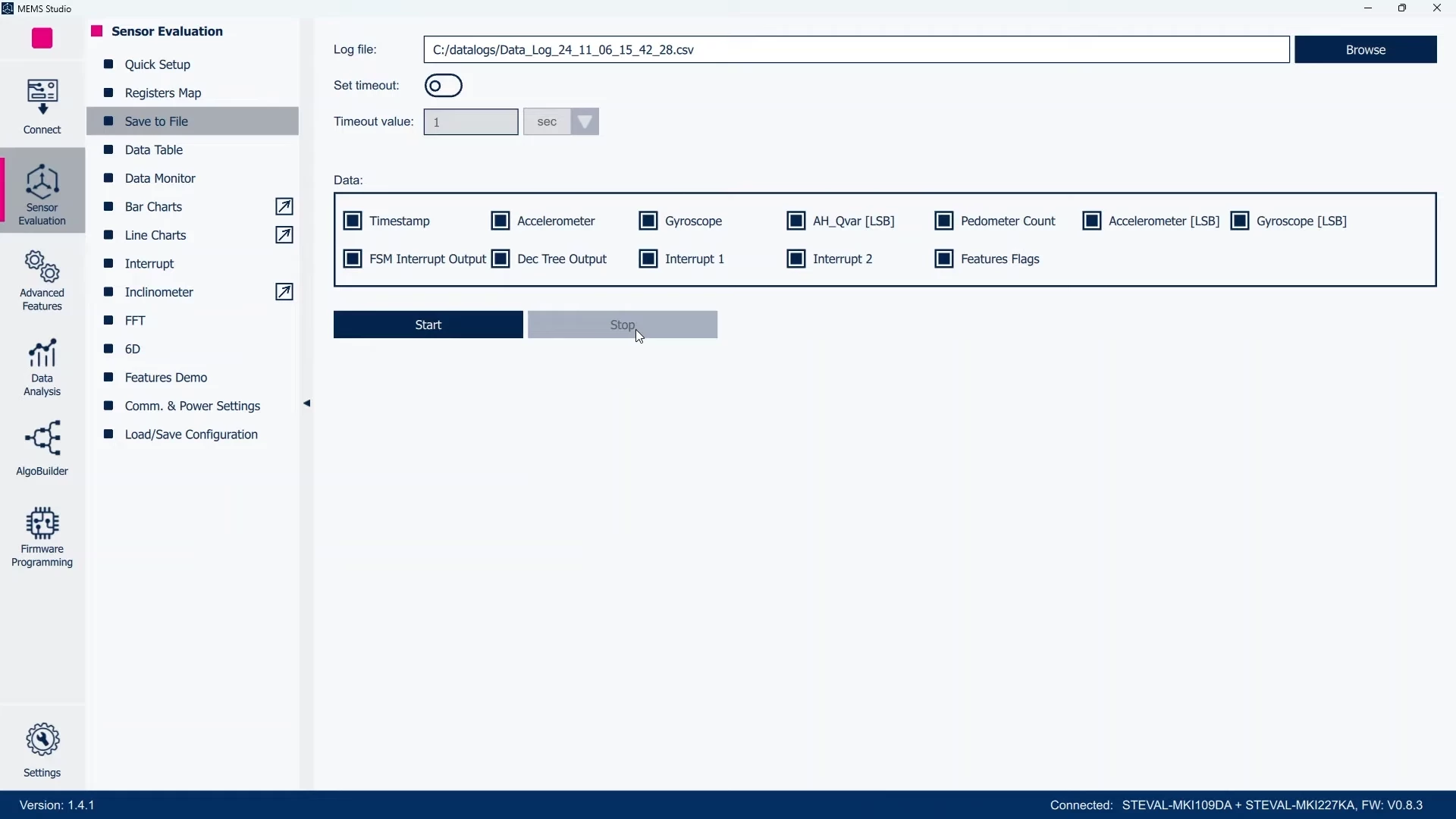

  • Perform data logging.
    Figure 11: MEMS Studio - Sensor Evaluation, Save to FileFigure 11: MEMS Studio - Sensor Evaluation, Save to File

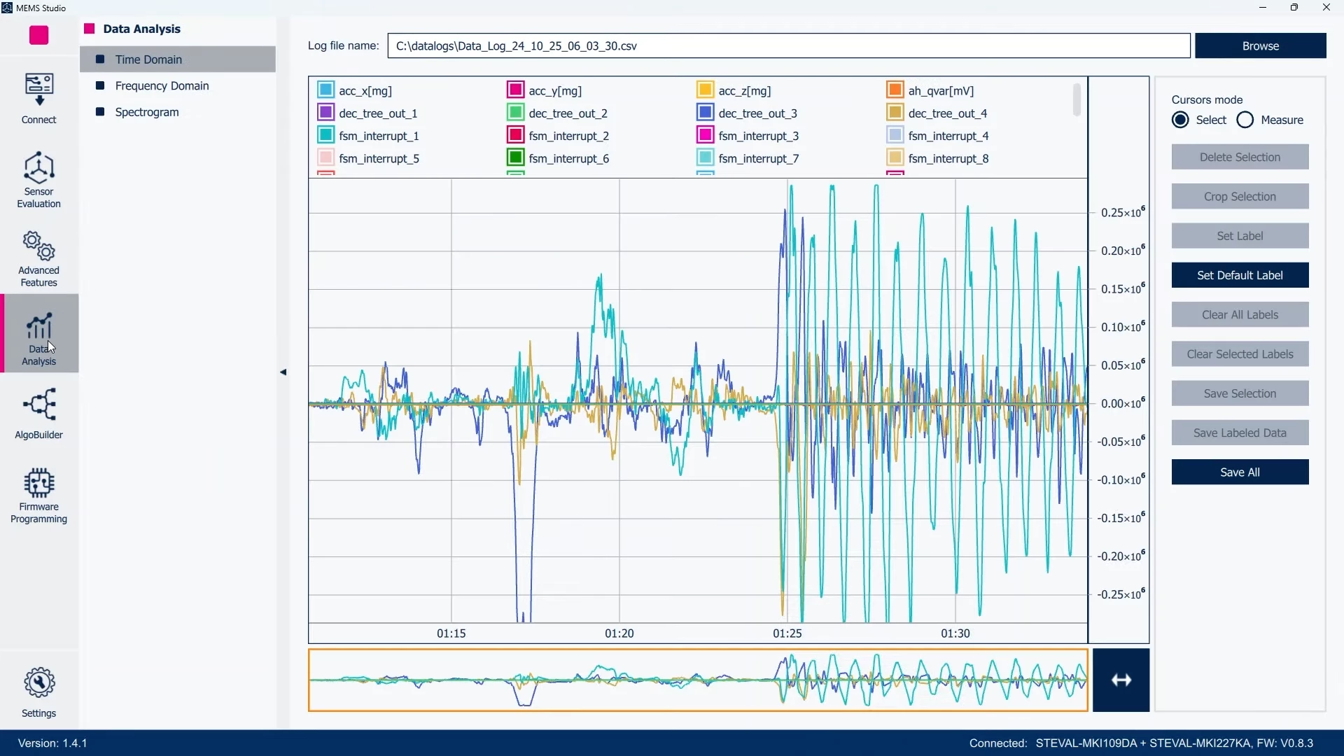

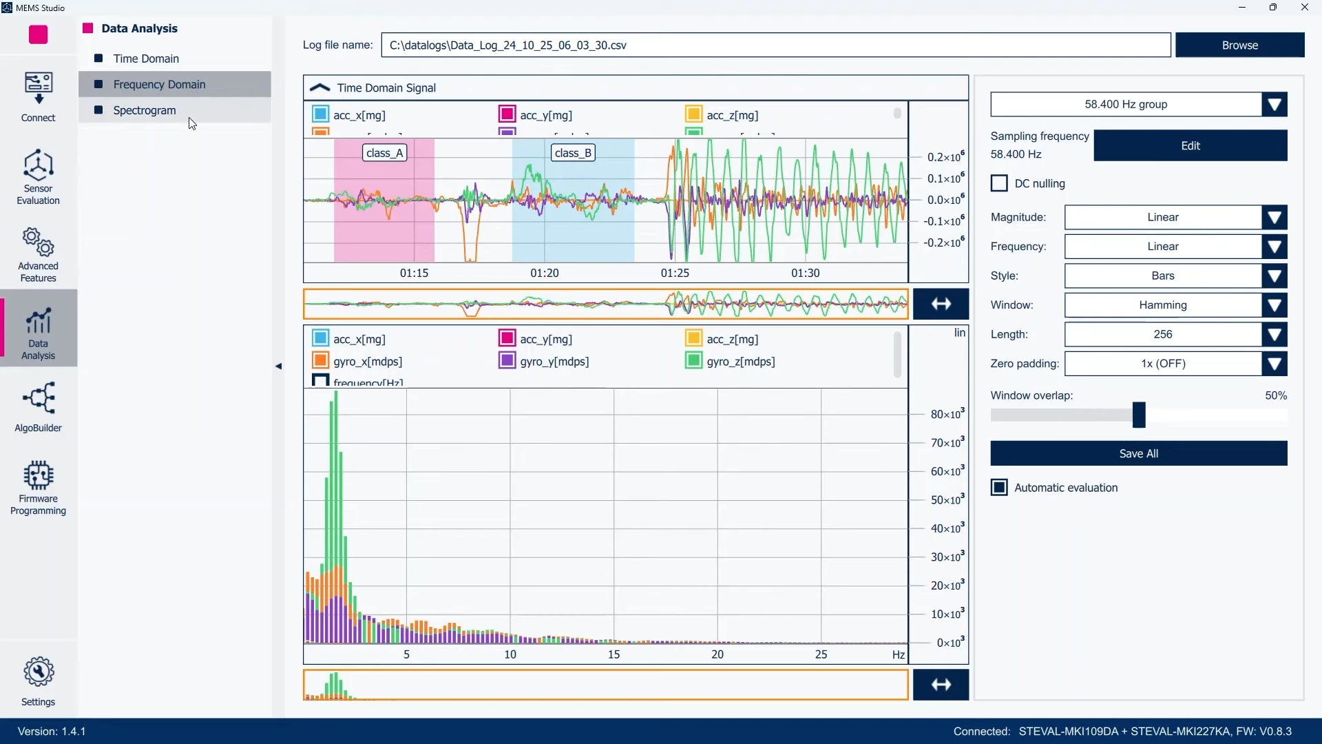

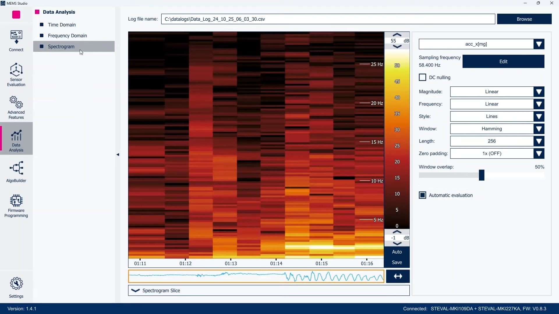

  • Analyze data in the time domain and in the frequency domain.
Figure 12: MEMS Studio - Data Analysis, Time DomainFigure 12: MEMS Studio - Data Analysis, Time Domain
Figure 13: MEMS Studio - Data Analysis, Frequency DomainFigure 13: MEMS Studio - Data Analysis, Frequency Domain
Figure 14: MEMS Studio - Data Analysis, SpectrogramFigure 14: MEMS Studio - Data Analysis, Spectrogram

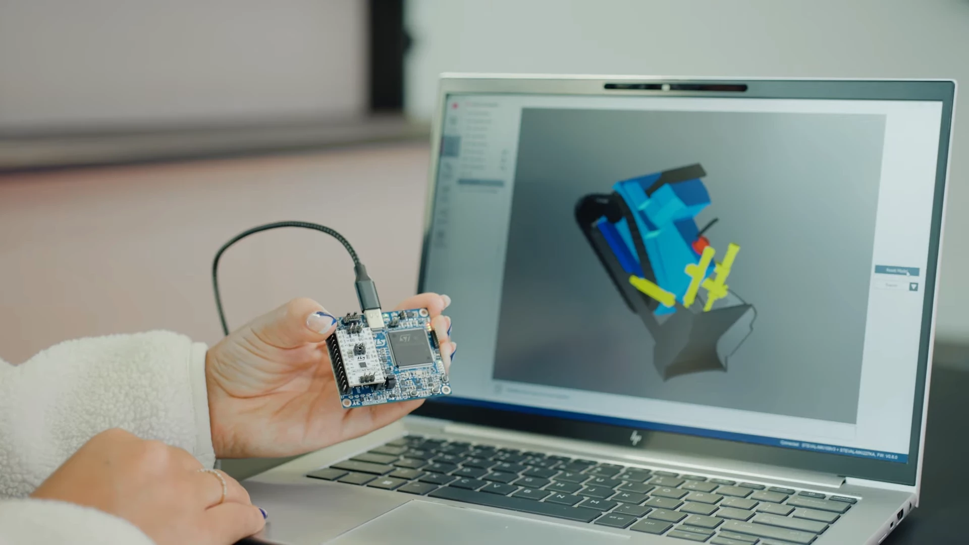

  • The possibility to evaluate the sensor fusion low power (SFLP).
Figure 15: Sensor Fusion Low Power (SFLP) with STEVAL-MKI109D, STEVAL-MKI227KA and MEMS StudioFigure 15: Sensor Fusion Low Power (SFLP) with STEVAL-MKI109D, STEVAL-MKI227KA and MEMS Studio

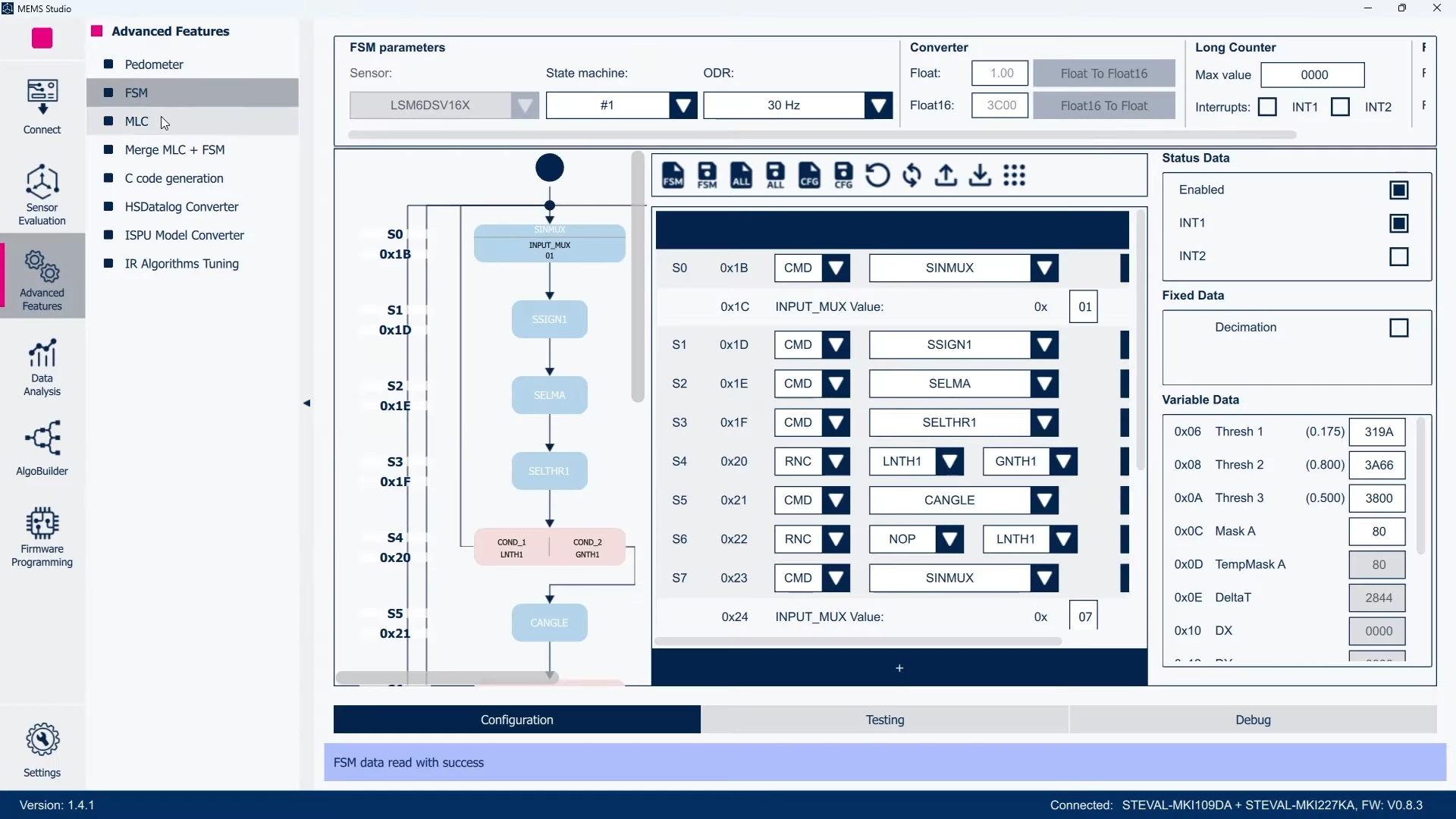

  • A programmable finite state machine (FSM), which can be debugged at real time.
Figure 16: MEMS Studio - Advanced Features, FSMFigure 16: MEMS Studio - Advanced Features, FSM

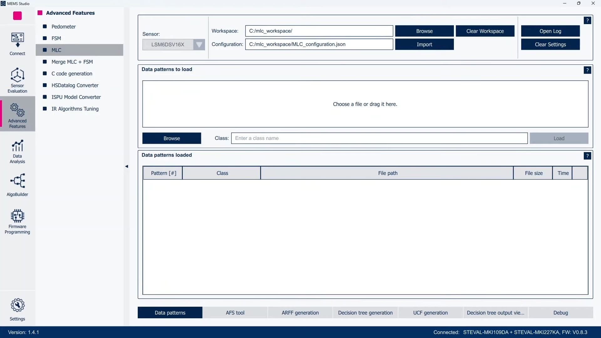

  • The machine learning core (MLC), enabling AI at the edge through decision tree based algorithms.
Figure 17: MEMS Studio - Advanced Features, MLCFigure 17: MEMS Studio - Advanced Features, MLC

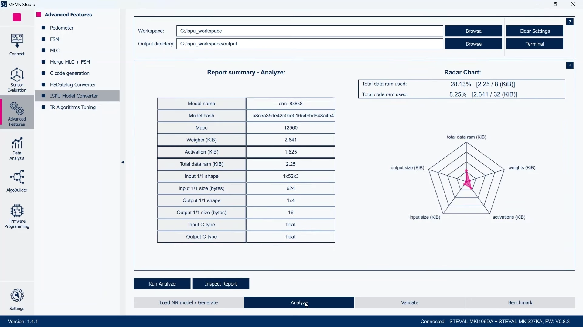

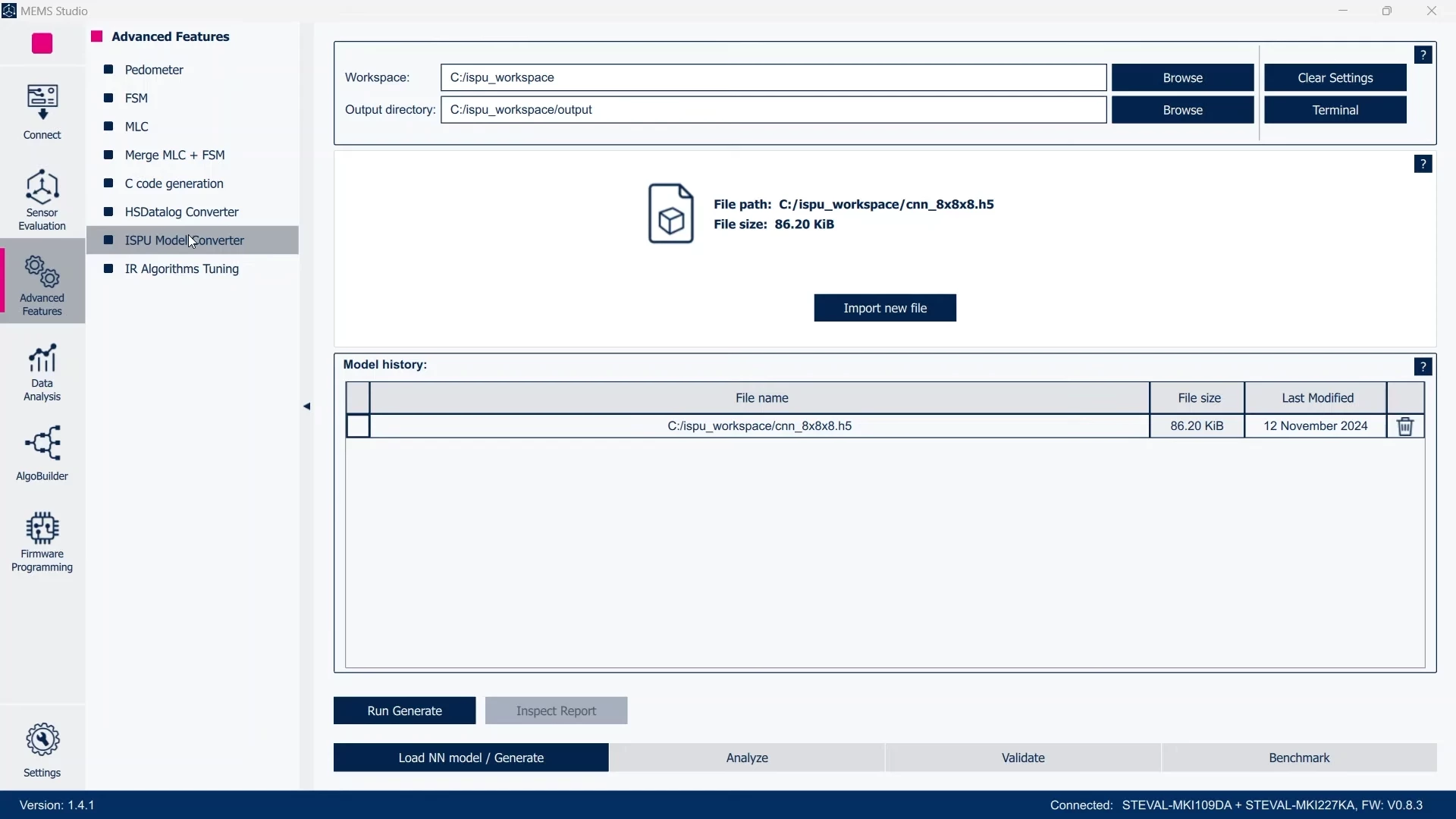

  • The intelligent sensor processing unit, which allows to embed more advanced AI models such as a neural network in the MEMS sensor.
Figure 18: MEMS Studio - Advanced Features, ISPU Model Converter, NN modelFigure 18: MEMS Studio - Advanced Features, ISPU Model Converter, NN model
Figure 19: MEMS Studio - Advanced Features, ISPU Model Converter, Radar ChartFigure 19: MEMS Studio - Advanced Features, ISPU Model Converter, Radar Chart
