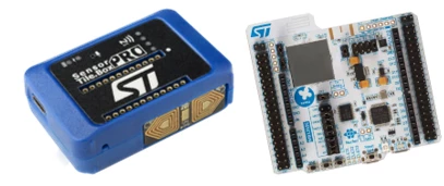

  • SensorTile.box PRO used as controller. The STEVAL-MKBOXPRO (SensorTile.box PRO) is a ready-to-use programmable wireless box kit for developing any IoT application based on remote data gathering and evaluation. Use the full kit potential by leveraging both motion and environmental data sensing, along with a digital microphone. Enhance the connectivity and smartness of whatever environment that you find yourself into.
  • P-NUCLEO-WB55 used as BLE to VCOM bridge. The P-NUCLEO-WB55 pack is a multiprotocol wireless and ultra-low-power device. Embedding a powerful and ultra-low-power radio compliant with the Bluetooth® Low Energy (BLE) SIG specification v5.0 and with IEEE 802.15.4-2011.
