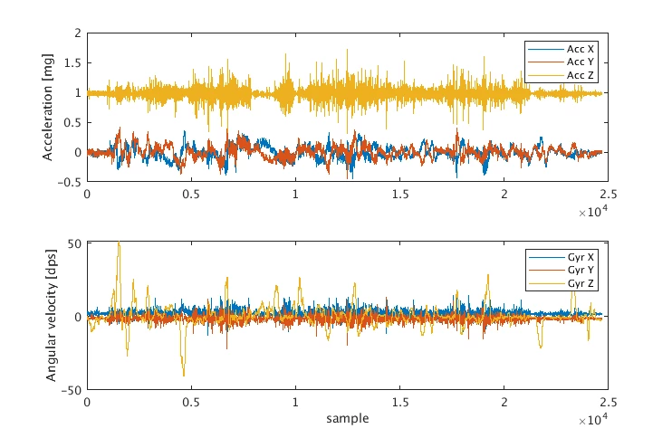

There are several options available to visualize the collected data. If we collect accelerometer data in [mg] and gyroscope data in [dps], we can use MATLAB/Python/Excel/R to generate plots as shown in the following example.
The analysis of the signal in time domain allows to:
  • Visually inspect any poor quality or outliers.
  • Understand if a pattern exists between different classes.
  • Select the informative features (mean, peak-to-peak, peak, etc.).

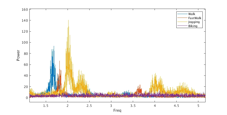

The frequency-domain analysis could be helpful to complement the time domain analysis. The same tools (MATLAB/Python/Excel/R) can be used to compute and produce FFT or spectrogram plots. Such plots can provide insights about applying filters on the signal before it is processed to compute features. Or they can be useful to evaluate if a specific recorded log is correctly referenced. For example, think about a data log for a “walking” use case. With an FFT plot it is possible to verify the dominant frequency associated with the processed signal. If this frequency is too high (e.g., 2.5 Hz), we can assume that the log should be referenced as “running” instead of “walking”.
The next picture shows the frequency spectrum for different human activities (walking, fast walking, jogging, biking) considered in a classification problem.
From the plot, each activity has a distinct dominating frequency component, thus appropriate filters can be applied to extract informative signals for each class. For example, if we apply a low-pass filter at 1.8 Hz, we can separate the walking and fast walking classes from jogging class, characterized by higher energy at higher frequencies.

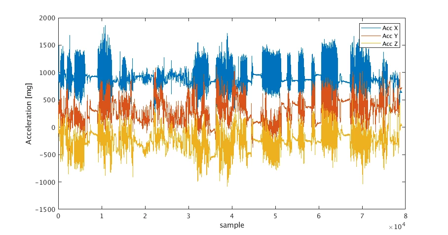

Consider again the example from activity recognition with a wrist device. The next plot shows the acceleration signal of motion pattern. Ideally the idea is to collect data for stationary, walking, and fast-walking classes. Unfortunately, it is clear that the recorded log is mixed with all the activities. The user should truncate the log and label correctly each sub-part to include the right information as a proper input of the model.

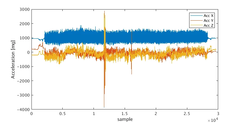

Another issue is shown below. A walking pattern is recorded, but at the start and at the end of the log stationary samples are present. In addition, in the middle of log recording there is evidence for a spike that is not classified. Annotations of recorded logs are suggested to avoid incorrect training data.
All these issues could affect the generated decision tree and the performance of the MLC result. Let’s summarize, here are some basic suggestions for a robust data collection:
