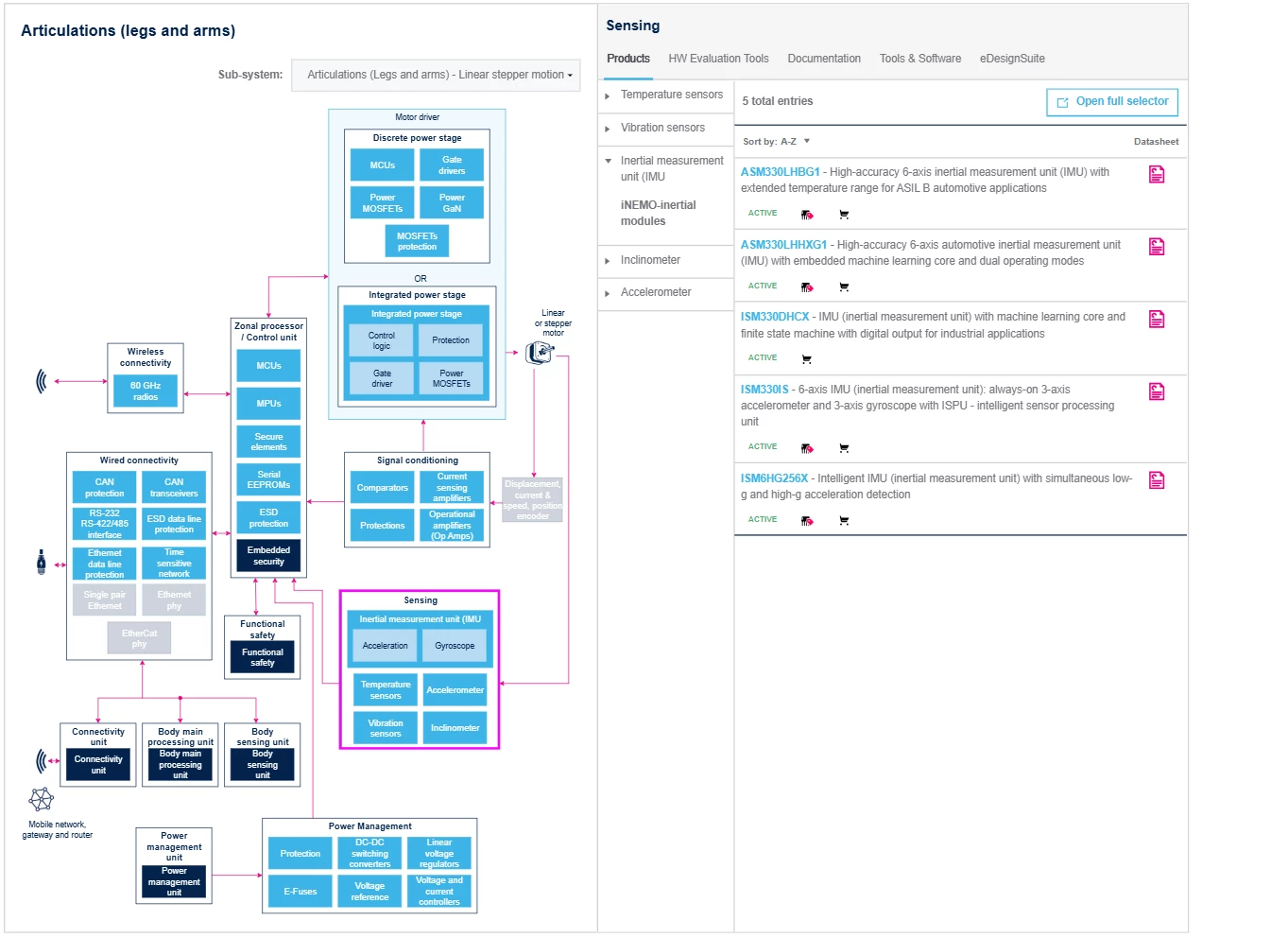

For example, in the Articulations (legs and arms) block diagram for humanoid robots, you can check the suggested devices in the Sensing block. This includes IMUs and other types of sensors.

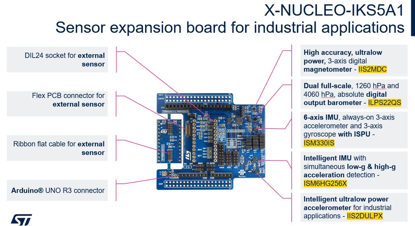

Tools and software are also suggested for the Sensing block of the diagram. One of the recommended boards for industrial robotics applications is the expansion board X-NUCLEO-IKS5A1, which enables development with STM32 Nucleo boards.
The X-NUCLEO-IKS5A1 board can be connected to various STM32 Nucleo boards.
This configuration reduces development effort and accelerates time to market.
Use the combined boards with the software included in the X-CUBE-MEMS1 package and MEMS Studio.

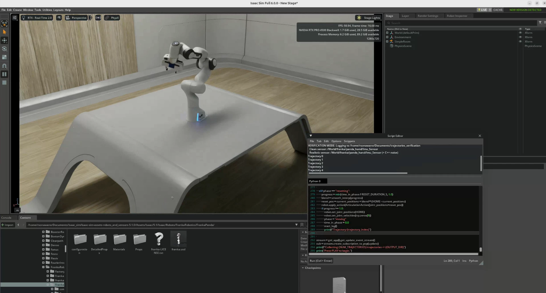

Isaac Sim provides a controlled virtual world where motion can be generated repeatedly and safely. Robot trajectories can be simulated by attaching virtual IMU sensors. The ideal motion can be studied in simulation, and the tool helps translate movements into inertial measurements.

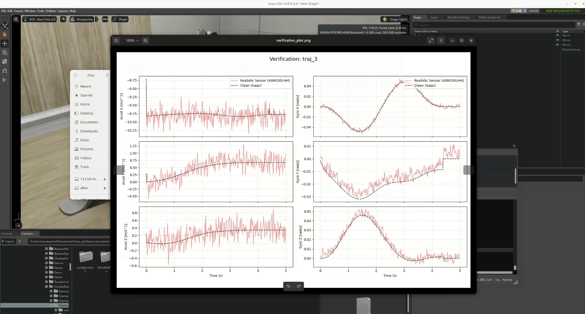

Ideal simulation alone is not enough. Real IMUs have noise, bias drift, vibration effects, temperature sensitivity, and device-specific behavior. The Sim2Real IMU model adds the missing sensor realism needed to bridge simulation and reality.
In simple terms, Isaac Sim provides the robotic motion environment, while the Sim2Real IMU model makes the inertial sensor behavior realistic. Together, this creates a practical workflow for generating synthetic IMU data, validating algorithms, and accelerating motion intelligence development before deployment on real systems.
After selecting the sensor model in the NVIDIA Isaac Sim software, when the robot executes trajectories in the simulation environment, the sensor output is immediately usable for downstream pipelines. Logging, analytics, and external streaming are some of the features available in the tool.
Robotics and perception teams can evaluate software stacks against more realistic inertial sensor behavior without requiring custom scripting each time a sensor is added to a scene.
