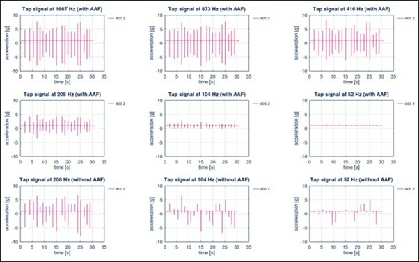

A typical use case is the tap/double-tap recognition in wearable devices​. On this purpose, the following picture shows multiple tap events collected at different ODR.  A tap is recognized each time a positive peak is followed by a negative one.​
Multiple tap events collected at different ODRMultiple tap events collected at different ODR
The first row shows the ODR, which has been lowered down to 416Hz with no significant information loss. 400Hz is the suggested ODR for tap and double tap do be correctly detected.
The second row shows that whilst the AAF is still active, the ODR has been further reduced. In such configuration, the signal dynamic is loss and detection thresholds should be lowered increasing the risk of false detection until the algorithm is unworkable.​
In the third row, the AAF is disabled and the consequent in-band folding compromises the information in the data stream that becomes unreliable (some negative peaks disappear).
