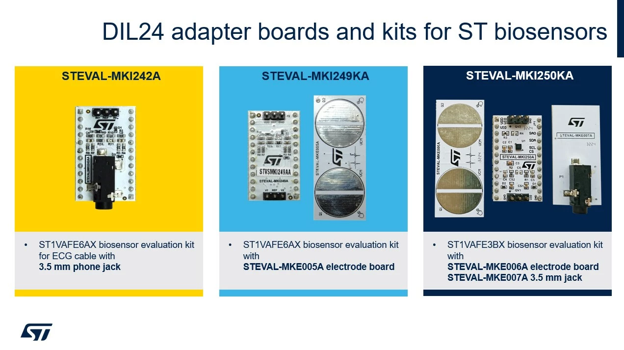

ST1VAFE3BX and ST1VAFE6AX are available in three different adapter boards to allow the evaluation with different type of electrodes.
  • STEVAL-MKI242A is a board for evaluating the 6-axis biosensor connecting a 3.5 mm jack for the electrodes.
  • STEVAL-MKI249KA is another evaluation kit for the 6-axis biosensor. It includes an electrode board (without jack in this case).
  • The last kit instead, called STEVAL-MKI250KA, contains the 3-axis biosensor ST1VAFE3BX, the jack connector, and the electrode board, so you can choose what kind of electrodes you want to use depending on the application.

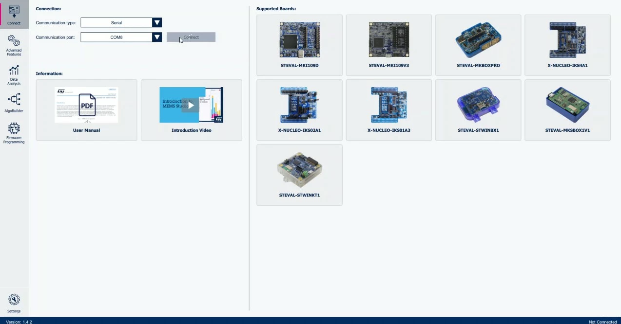

Download, install, and open MEMS-Studio software.
This software tool embeds a library for vital signs monitoring.
MEMS-Studio allows showing the biosensor outputs in a graphical user interface. It performs data logging and data analysis, and allows for easy sensor configuration setup or configuring the advanced features of the biosensors.
Figure 3: Connecting STEVAL-MKI109D to MEMS StudioFigure 3: Connecting STEVAL-MKI109D to MEMS Studio

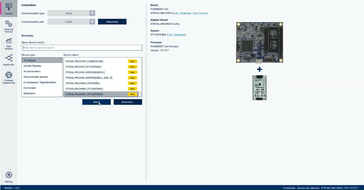

Once the professional MEMS tool board is connected to the PC, you can select the sensor you’re evaluating and configure it. Let’s use the ST1VAFE3BX as an example.
Figure 4: Selecting the biosensor you are evaluating in MEMS StudioFigure 4: Selecting the biosensor you are evaluating in MEMS Studio

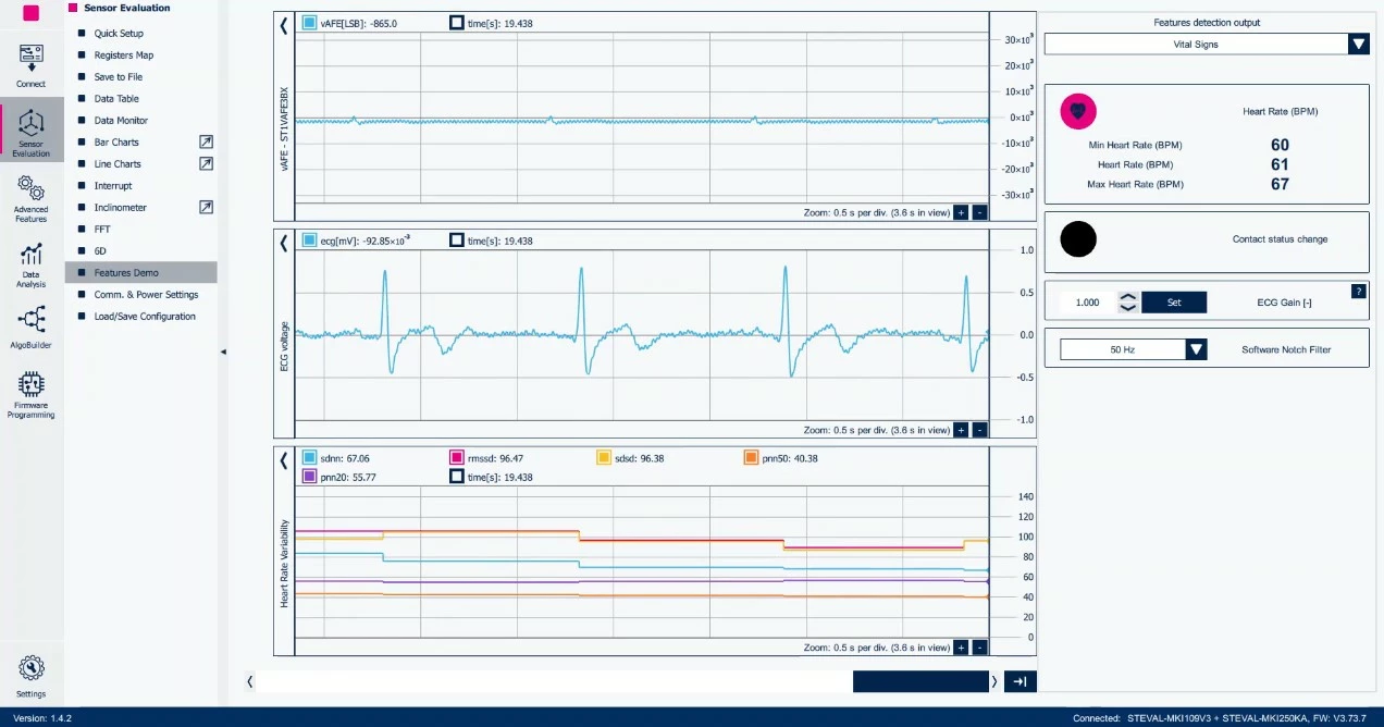

After concluding the initialization step, in the “Features Demo” section you can evaluate the vital sign algorithm using data coming from the biosensor.
Figure 5: MEMS Studio - Features Demo, Vital SignsFigure 5: MEMS Studio - Features Demo, Vital Signs
This vital signs monitoring library integrated in MEMS-Studio is called BioVSM.
BioVSM can detect the contact status change with respect to the exposed electrodes.
In fact, after an initialization phase with the fingers placed to the electrodes, the heart rate measurement will appear.
Three plots are available in this MEMS-Studio window:
  • vAFE signal read by the output registers of the sensor.
  • ECG voltage.
  • Heart rate variability computed by the "vital signs monitoring library".
