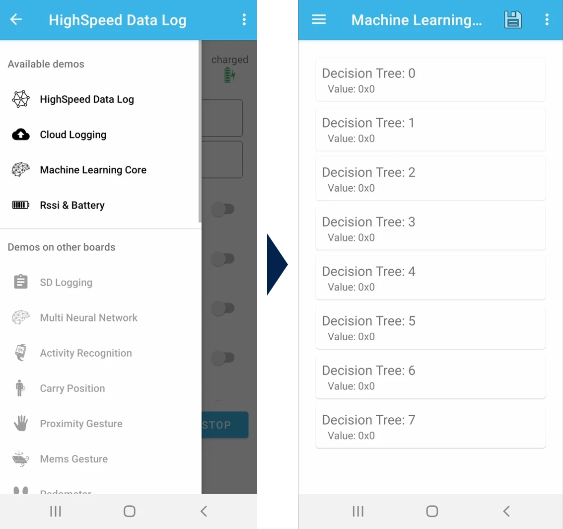

To check the outcome of the MLC in real-time, the user has to start an acquisition. Once the acquisition is started, by clicking the menu button in the top left corner it will find the "Machine Learning Core" menu.
Here, the user will find the real-time outcome of MLC, expressed as a value.
The user can verify that the numeric output of the decision tree corresponds to the working mode of the fan rack.
