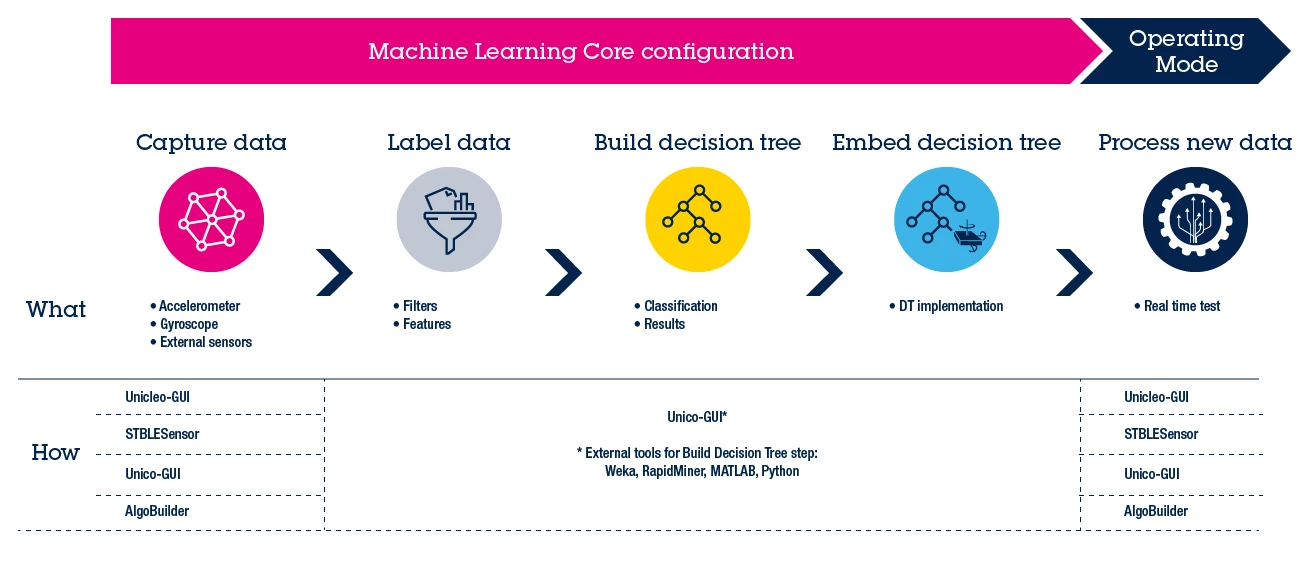

The picture below shows the workflow to implement the five steps above and the different software tools that can be used. For the example discussed here, STM32CubeProg, STBLE Sensor and Unico-GUI software tools will be used.
For more details on the software tools:
  • STBLESensor v4.8.0 (or higher) app for iOS/Android, used to acquire the sensor data, to program the MLC embedded in ISM330DHCX and to check its functionality in real time.
  • Unico-GUI v9.9.0 (or higher), used to generate the ISM330DHCX MLC configuration
  • STM32CubeProg v2.4.0 (or higher) an all-in-one multi-OS software tool for programming STM32 products.

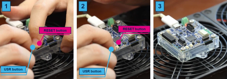

To flash the board, one has to launch the STM32CubeProgrammer software, connect the board to the PC and enable the DFU mode.
To enable the DFU mode, the user has to push both USR and RESET button found on STWIN board, then has to release only the RESET button while keeping the USR button pushed. After 5 seconds, the user can also release the USR button and the board will be initialized in DFU mode.
The user can now open STM32CubeProgrammer, select USB in the top right dropdown list and can click on the "refresh" icon. If a device appears in the "Port" dropdown list then the DFU mode entry has been performed correctly.

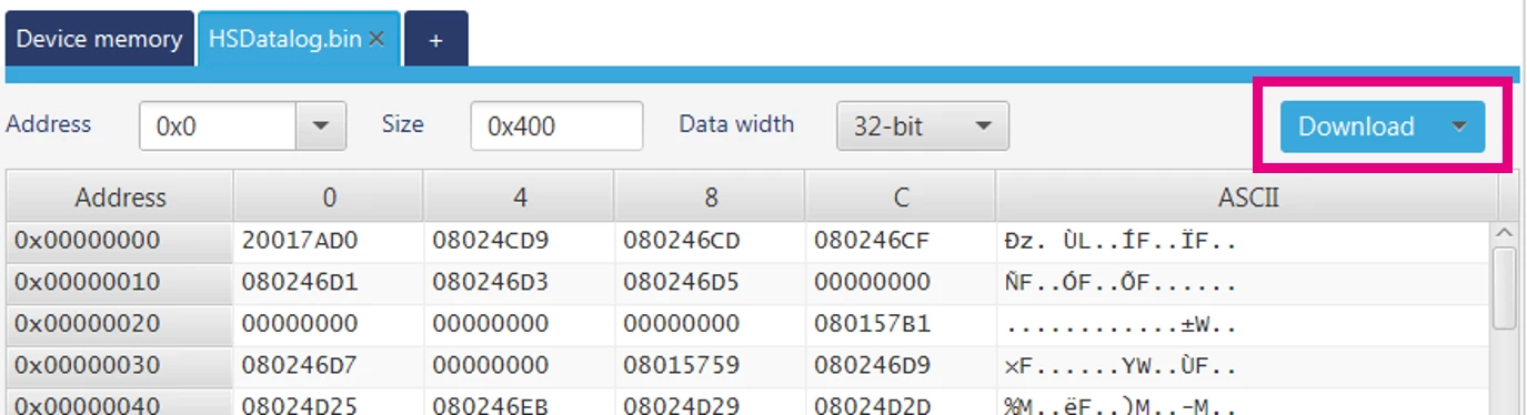

Now the user can click on the "Open file" tab, next to device memory, and will select the firmware downloaded in the previous step (default path .../FP-SNS-DATALOG1_V1.0.0/Projects/HSDatalog/Binary/HSDatalog.bin).
When the correct file is selected, one has to click on "Download" to upgrade the board firmware.
The user can now click the RESET button. The board will boot with the newly installed firmware running.

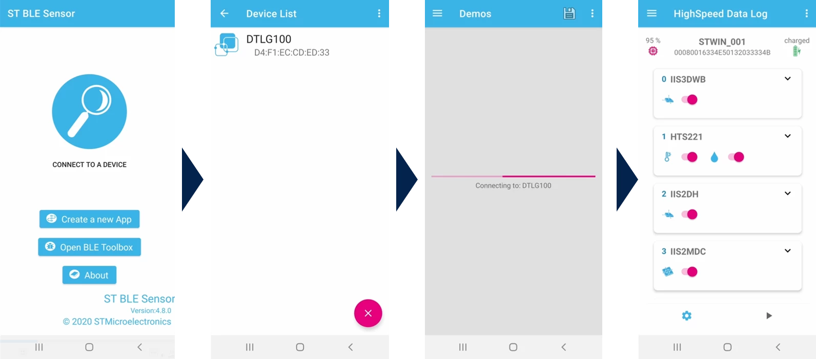

The user can now connect to STWIN using STBLESensor App (which can be downloaded from Google Play or Apple store). The app uses Bluetooth protocol to interact with the board, so make sure to enable Bluetooth on the phone before starting the app.
Once the app is loaded, the user can click on "Connect to a device" and a device named DTLG100 (default name of the board, it may differ) will show up. The user can select the active board by clicking and the app loads the board configuration.
In this tab the user can check all the sensors available on STWIN. For the application shown in this readme, any sensor needs to be selected but ISM330DHCX.
Once the user open the ISM330DHCX settings, it is able to select the full scale and the Output Data Rate of both Accelerometer and Gyroscope (referred as XL and Gyro from now-on). Since the goal is to use this data to train the MLC embedded in ISM330DHCX, and the MLC can't run to a frequency higher than 104Hz, the user needs to set both the ODRs to 104Hz. Regarding the full scale, the intensity of the movement that the sensor will acquire is limited so, selecting the lower full scale for both XL and Gyro (thus, 2g and 125dps) the user achieve the best performance.
By clicking on the play button in bottom right corner, the user will move to a different tab of the app. Here it is possible to specify the name of the acquisition and add a brief description of the test. The user can skip the SW_TAG settings. The user is now ready to start three different acquisitions of the sensor, one for every scenario of the fan rack.

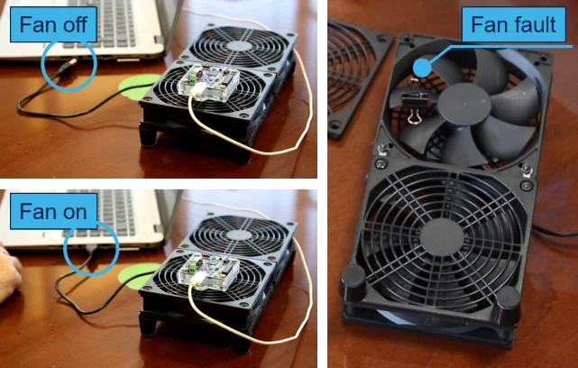

Before clicking Start it is necessary to place the STWIN on top of the fan rack and let the fan rack work in three different scenarios. To achieve the best performance, STWIN needs to be double side taped to the fan rack and placed at the center of one of the fans. Once it is placed, we can differentiate the three scenarios as below:
  • Fan_off: obtained by not supplying the fan rack
  • Fan_on: obtained by supplying the fan rack
  • Fan_fault: can be obtained in a disruptive way by breaking one of the fan fins or, in a non disruptive way, by applying a small weight (e.g. a metal spring paper clip) on one of the fins. Once turned on, the fan rack will vibrate in a different way and will tend to move around. A good idea is to use double-sided tape also to attach the fan rack to the table.
It is now time to log the sensor data. The user needs to create a different log file for every scenario (total of 3). The length of the acquisition should be of ~1 minute per log in order to achieve a good training result. The user has to avoid inducing any other form of vibration to the fan rack while logging; any vibration or movement induced in the sensor by an external source can potentially cause the non validity of the data set.
