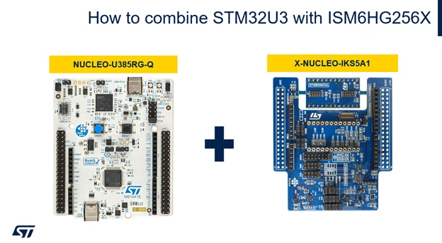

Let us consider the brand-new development platform that combines two powerful boards: the Nucleo-U385RG-Q and the X-NUCLEO-IKS5A1.
Figure 1: The boards NUCLEO-U385RG-Q and X-NUCLEO-IKS5A1Figure 1: The boards NUCLEO-U385RG-Q and X-NUCLEO-IKS5A1
This pairing brings together the STM32U3 MCU with the highly accurate ISM6HG256X inertial measurement unit.
With this platform, you can easily dive into advanced applications like asset tracking, condition monitoring, robotics, and more, all while benefiting from optimized power consumption and strong sensor performance.
Let us have a look at the two boards:
The Nucleo-U385RG-Q is a development board featuring the STM32U385RG microcontroller, providing an affordable and flexible platform for users to explore new concepts and build prototypes. Key features of the board include:
  • A USB Type-C® connector
  • An Arduino® Uno V3 expansion connector
  • An on-board STLINK-V3EC debugger/programmer

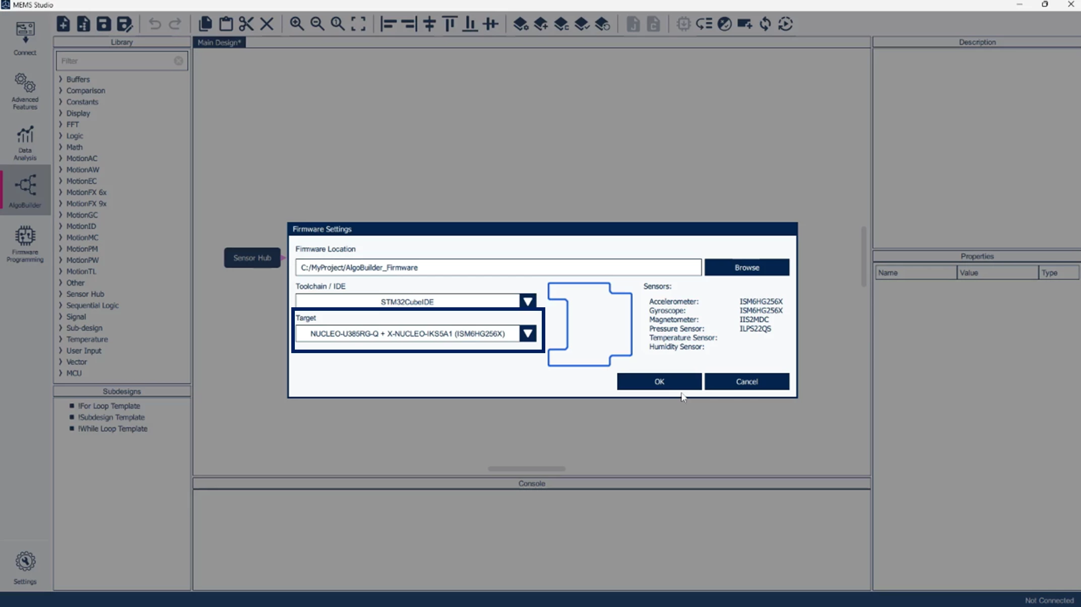

One of the tools inside MEMS Studio is AlgoBuilder, which allows to generate firmware for various evaluation boards with STM32 microcontrollers.
Figure 4: Firmware settings - TargetFigure 4: Firmware settings - Target
In this case, a Nucleo board with the STM32U3 inside is used, together with the sensor expansion board X-NUCLEO-IKS5A1, as shown in the following picture.

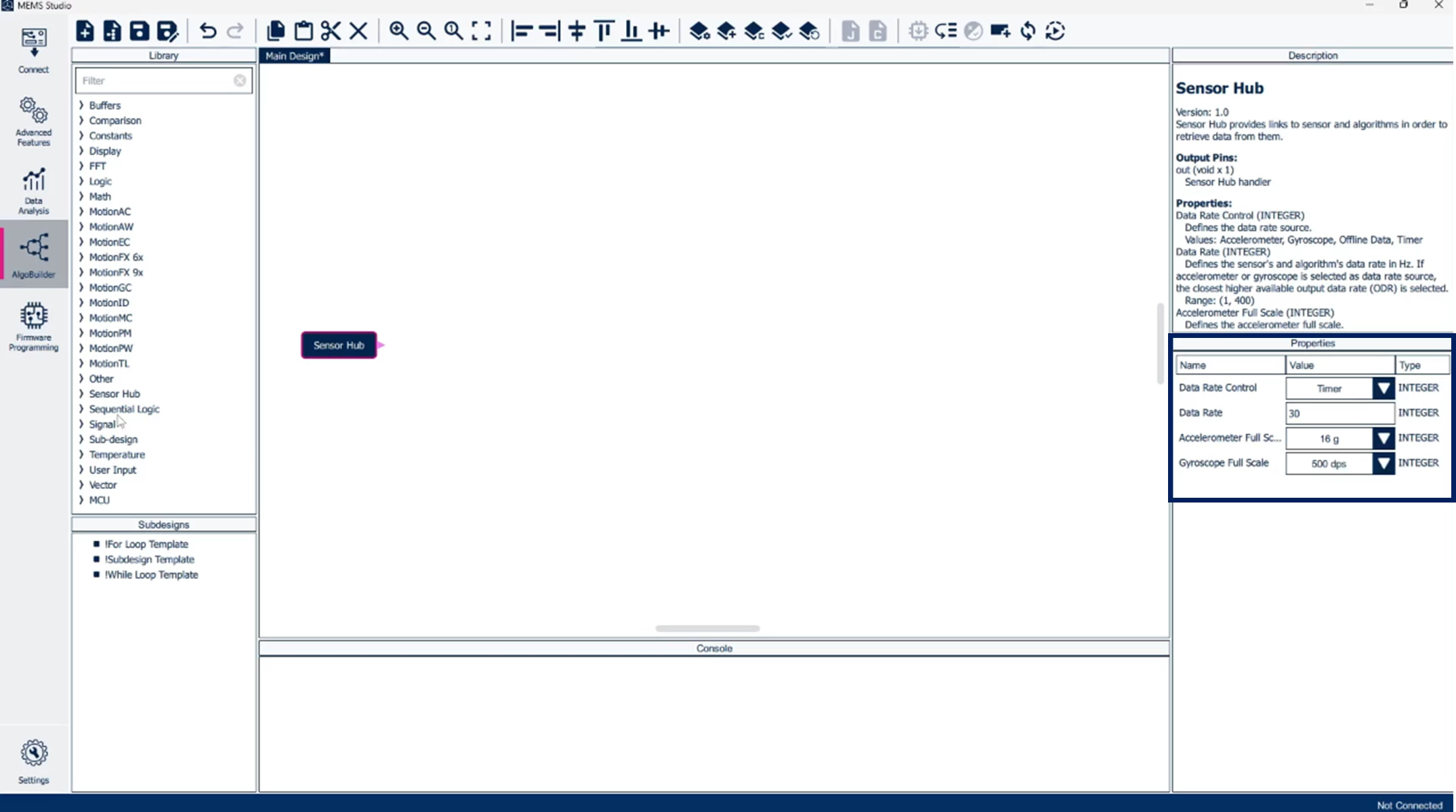

For the data logging, the following is needed:
  • Set the data rate, in this case 30 Hz.
  • Set the accelerometer full scale to 16 g, in this example only the accelerometer is used.
Figure 5: MEMS Studio - AlgoBuilder - Sensor Hub (properties)Figure 5: MEMS Studio - AlgoBuilder - Sensor Hub (properties)

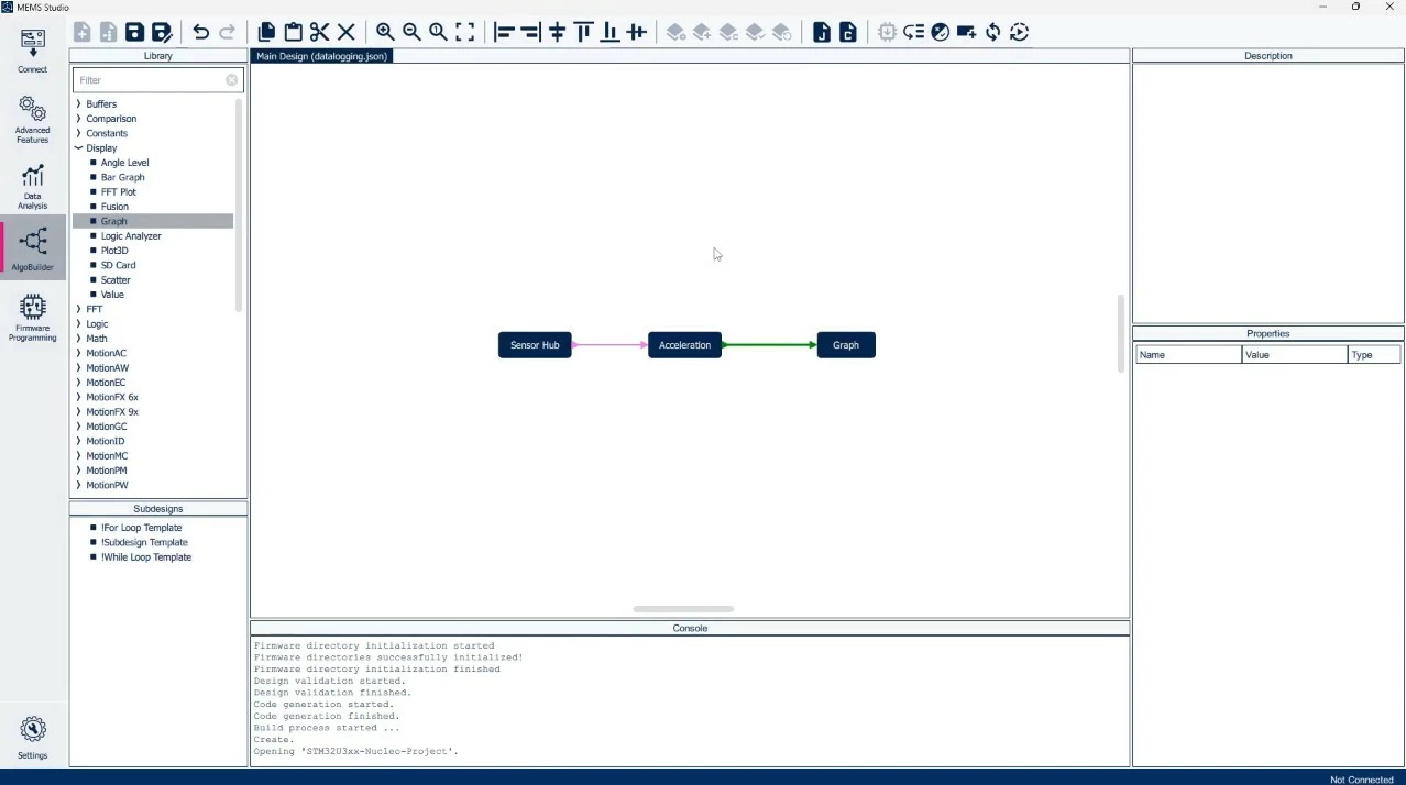

After adding the "Sensor Hub" block, add also the "Acceleration" and the "Graph" block, as shown in the following picture.
Figure 6: MEMS Studio - AlgoBuilder - BlocksFigure 6: MEMS Studio - AlgoBuilder - Blocks
Save the project and build it, invoking a compiler that was previously selected. When the compilation is done, flash the firmware to the MCU and then connect the board. Click the pink start button in the top left corner of MEMS Studio, and see the sensor data.

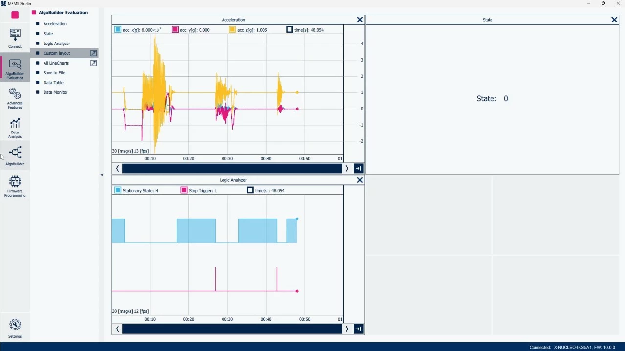

Figure 7: MEMS Studio - AlgoBuilder EvaluationFigure 7: MEMS Studio - AlgoBuilder Evaluation

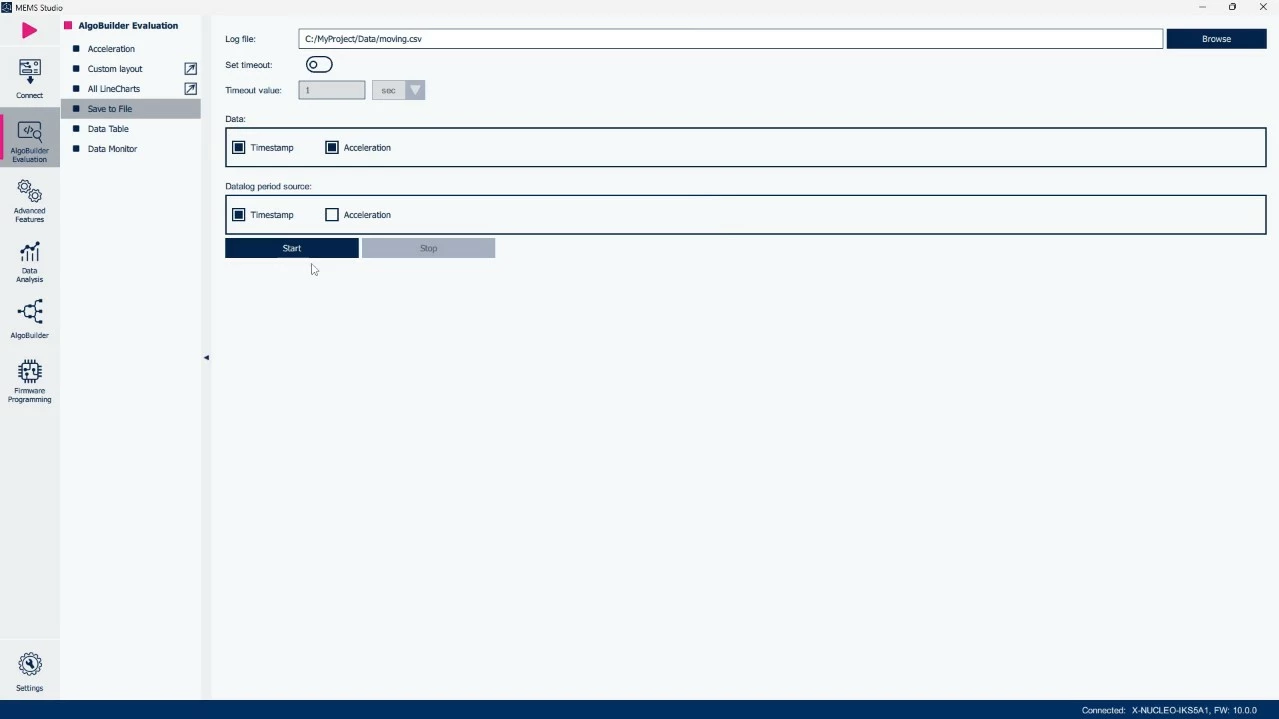

In the section “Save to File” you can perform data logging of the different classes that you want to recognize with the machine learning core. In our case: stationary, stationary not upright (which means that the package is rotated by 180 degrees), moving, and shaking.
Figure 8: MEMS Studio - AlgoBuilder Evaluation - Save to FileFigure 8: MEMS Studio - AlgoBuilder Evaluation - Save to File

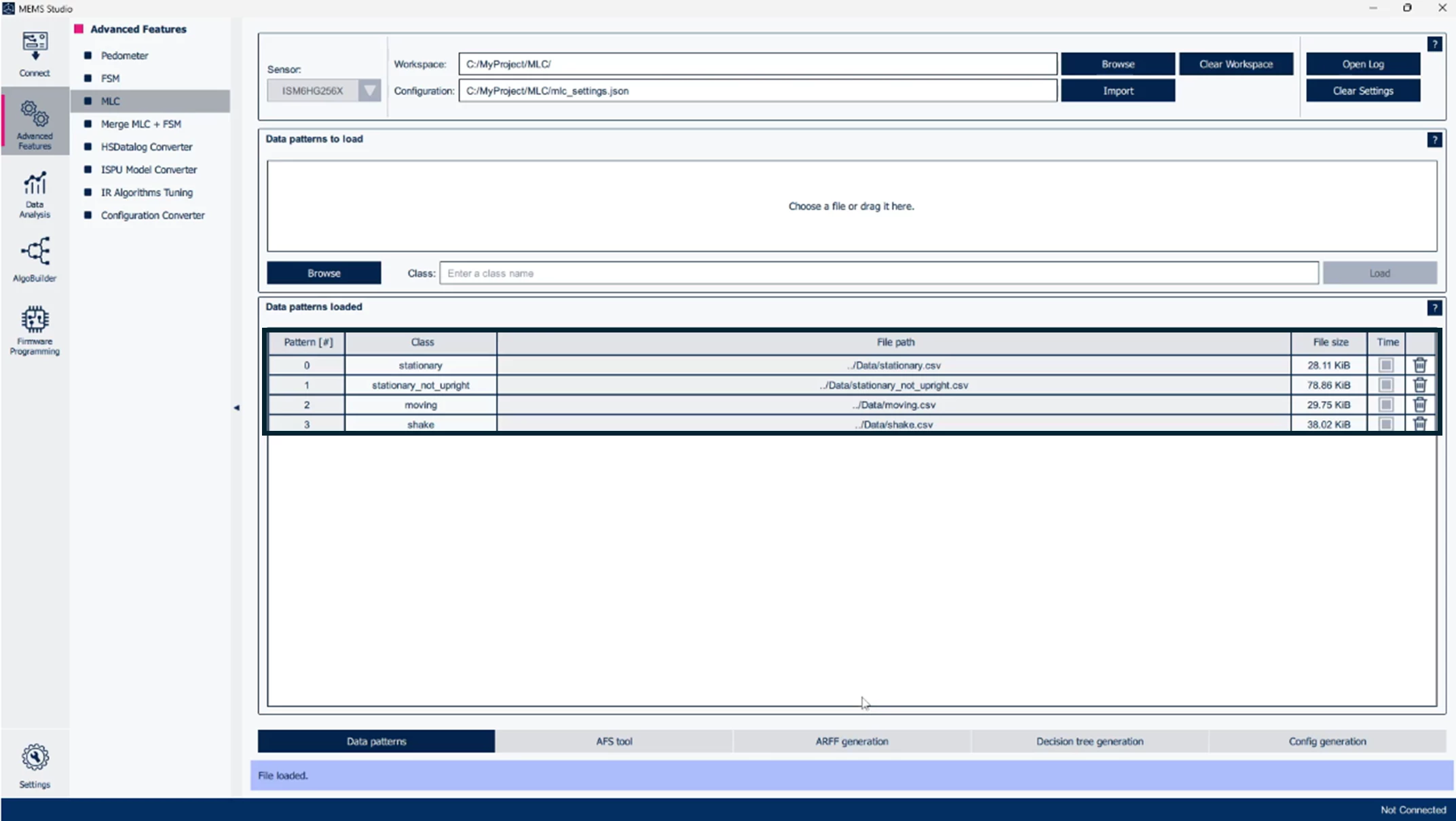

Once data logging has been completed, go to the MLC tool in the advanced features of MEMS Studio to create the MLC configuration, which will automatically detect different states.
In the MLC tool, you can import data logs previously acquired and assign a label corresponding to the class associated to the log.
Four classes are defined in this case:
  • “Stationary.”
  • “Stationary not upright” (which means that the package is rotated by 180 degrees.)
  • “Moving”, corresponding to slow movements.
  • And “Shaking”, corresponding to higher intensity movements.
Figure 9: MEMS Studio - Advanced Features - MLC - Data patternsFigure 9: MEMS Studio - Advanced Features - MLC - Data patterns

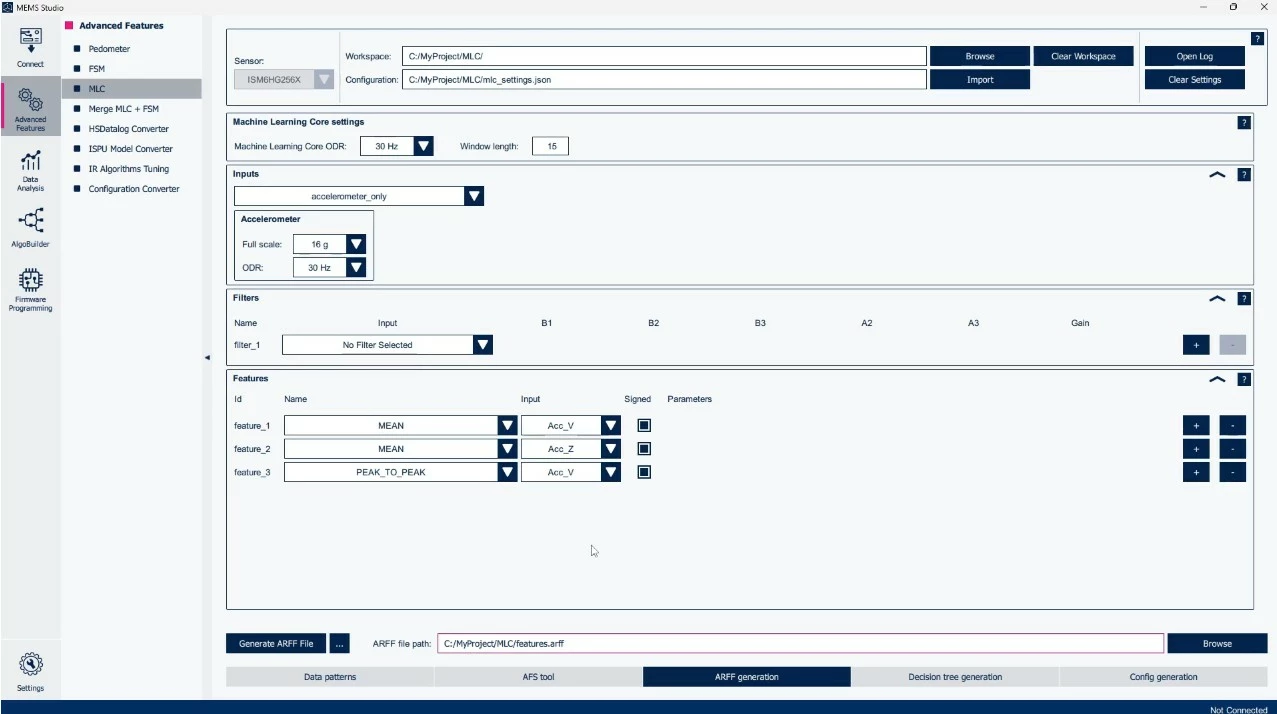

To proceed with the MLC configuration, in the “ARFF generation” tab you can manually select the sensor settings and the features to be used for the classification.
Features are manually selected here, based on previous experience with this particular use case.
Figure 10: MEMS Studio - Advanced Features - MLC - ARFF generationFigure 10: MEMS Studio - Advanced Features - MLC - ARFF generation
However, consider that you also have the possibility to perform this step automatically by using the AFS tool.

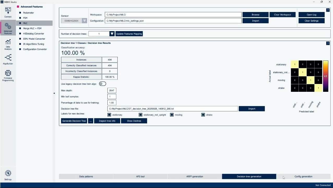

In the “Decision tree generation” tab, the decision tree model is generated, and the classification results are shown.
Figure 11: MEMS Studio - Advanced Features - MLC - Decision tree generationFigure 11: MEMS Studio - Advanced Features - MLC - Decision tree generation

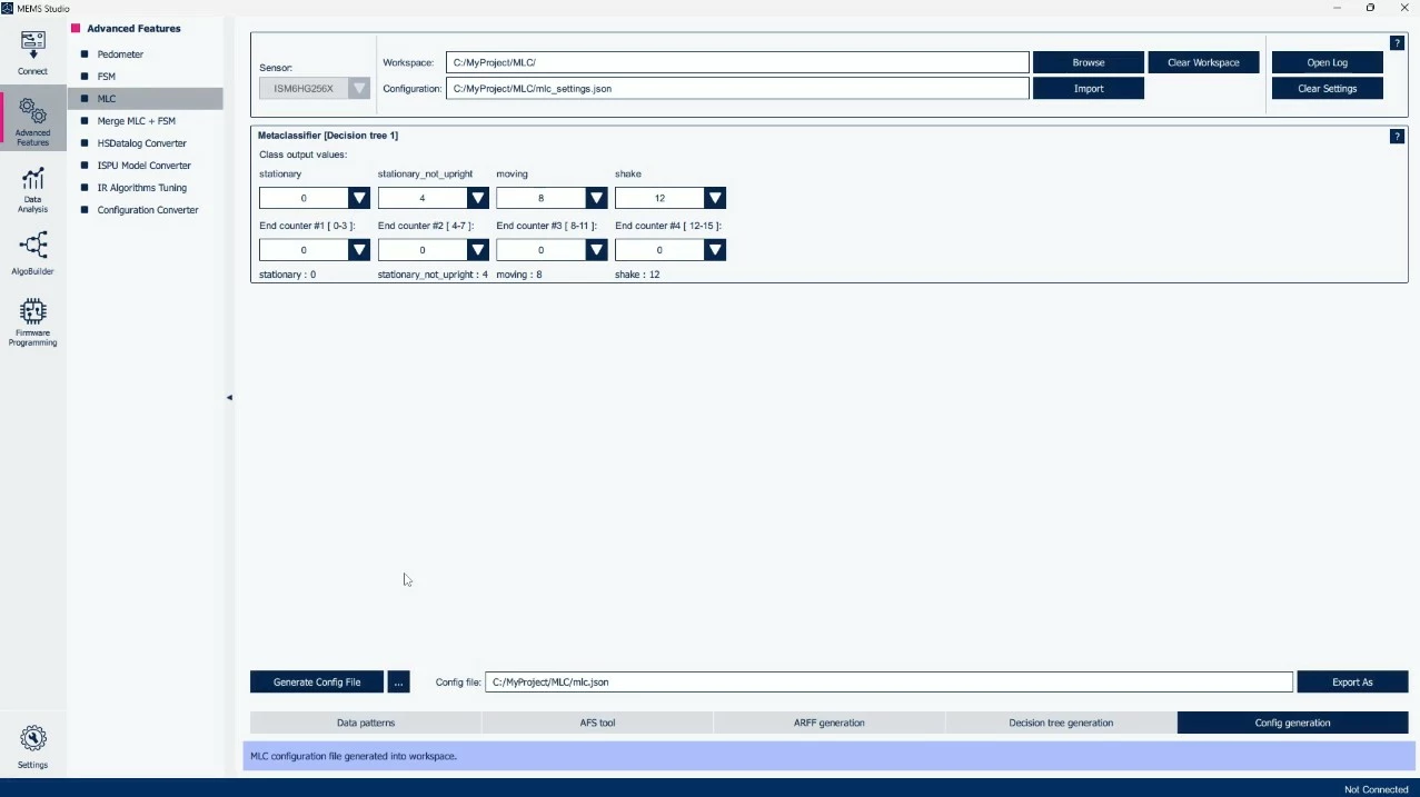

You can set values to the classes and get the configuration files for the sensor.
Figure 12: MEMS Studio - Advanced features - MLC - Config generationFigure 12: MEMS Studio - Advanced features - MLC - Config generation

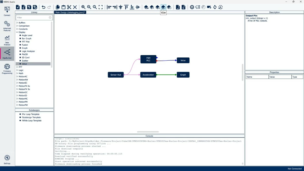

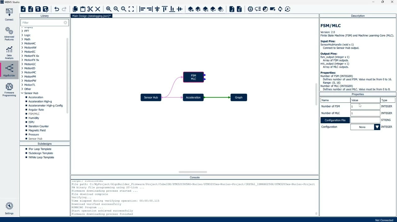

Going back to the AlgoBuilder project previously used for data logging, an additional branch can be added, called FSM and MLC, for setting the machine learning core configuration previously created.
Figure 14: AlgoBuilder - Adding FSM/MLC blocksFigure 14: AlgoBuilder - Adding FSM/MLC blocks
A .json file containing the MLC configuration should be specified, and a “Value” block should be added to visualize the different states or classes detected by the machine learning core.
Figure 15: AlgoBuilder - Adding Value blockFigure 15: AlgoBuilder - Adding Value block
The project is built again, and then new firmware is flashed on the STM32U3 of the Nucleo board.

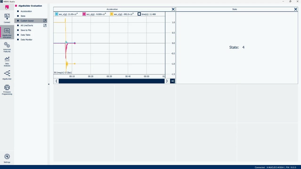

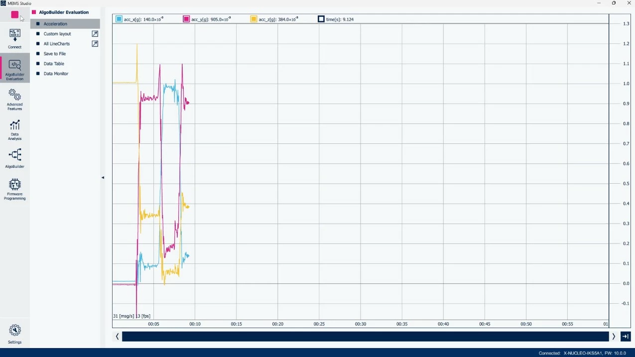

7. Step three: evaluation (asset tracking classification)

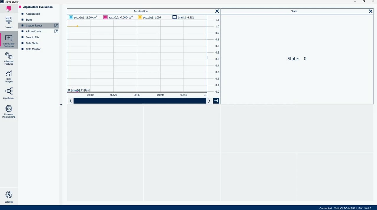

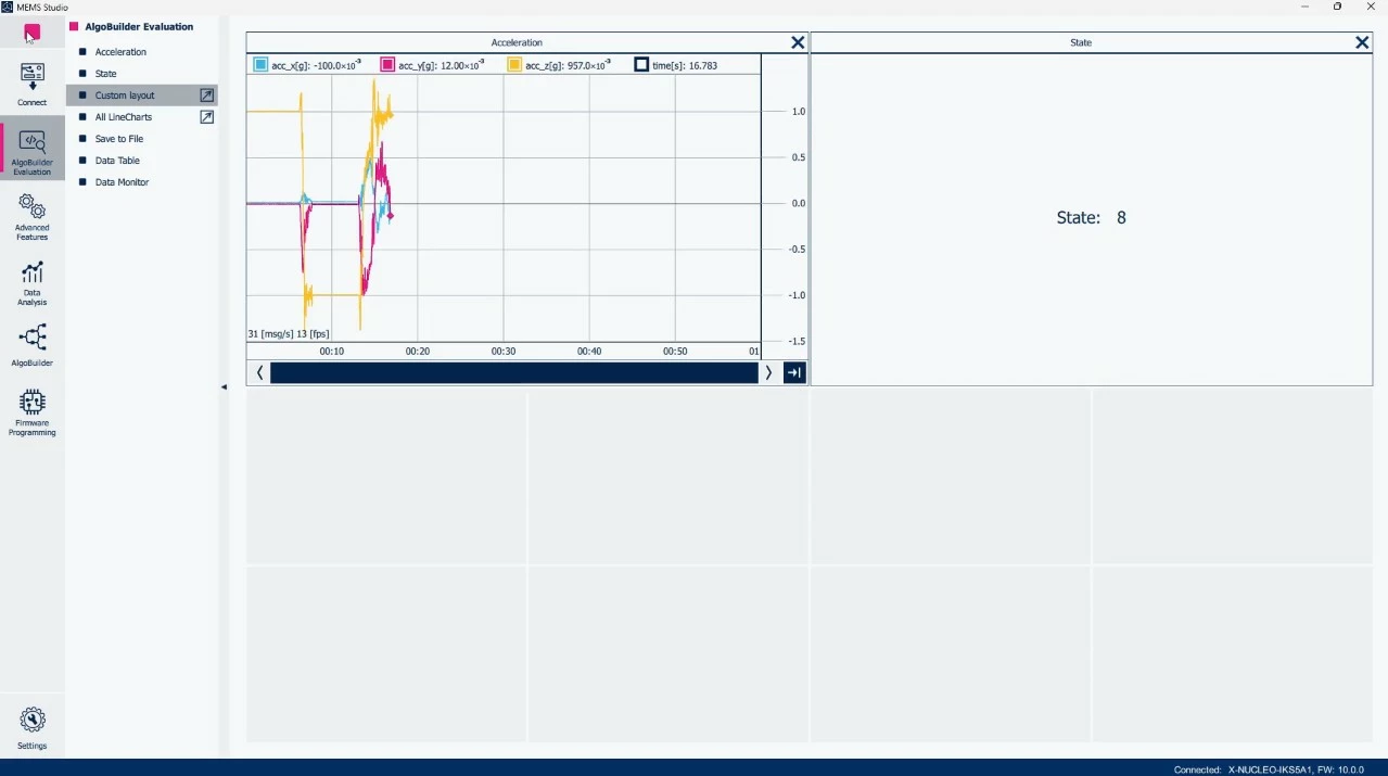

We are now ready to test the machine learning core configuration in the sensor ISM6HG256X visualizing the data read by STM32U3.
We can see the acceleration data in the plot, and the correspondent class detected by the machine learning core in the sensor, with the values:
  • 0 when the package is still.
Figure 16: MEMS Studio - AlgoBuilder Evaluation - The package is stillFigure 16: MEMS Studio - AlgoBuilder Evaluation - The package is still
  • 4 when it is not in an upright position.
Figure 17: MEMS Studio - AlgoBuilder Evaluation - The package is not in an upright positionFigure 17: MEMS Studio - AlgoBuilder Evaluation - The package is not in an upright position
  • 8 when it is moving.
Figure 18: MEMS Studio - AlgoBuilder Evaluation - The package is movingFigure 18: MEMS Studio - AlgoBuilder Evaluation - The package is moving

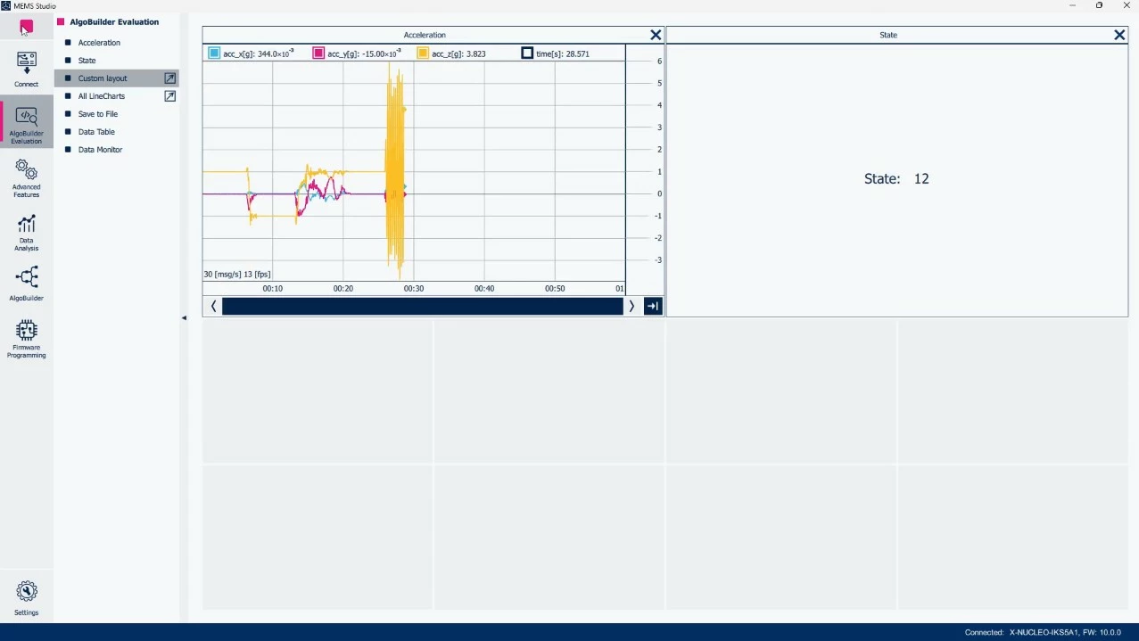

  • 12 when it is shaken.
Figure 19: MEMS Studio - AlgoBuilder Evaluation - The package is shakenFigure 19: MEMS Studio - AlgoBuilder Evaluation - The package is shaken

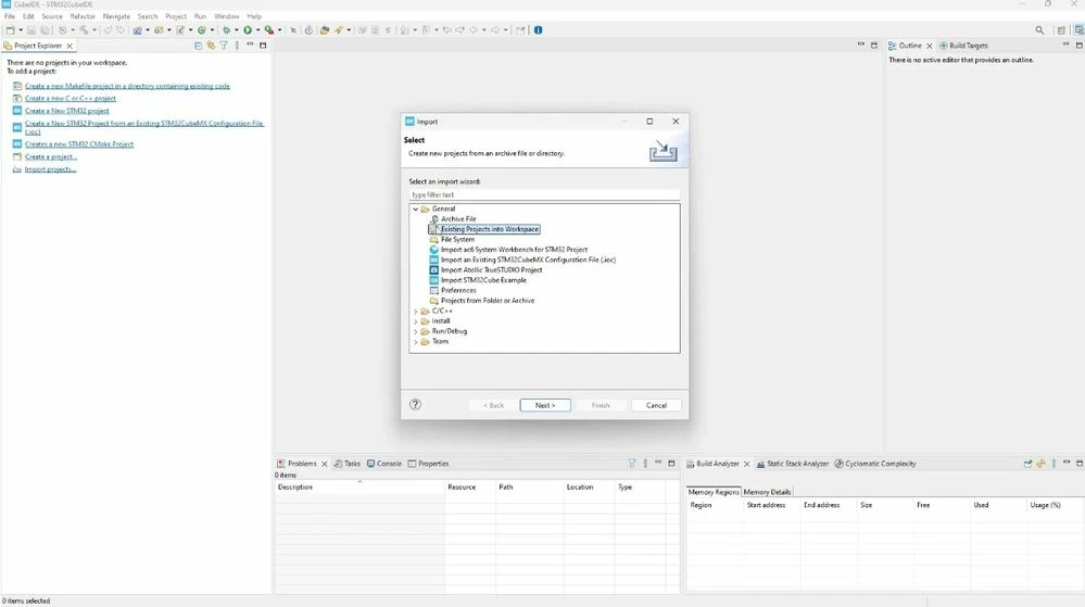

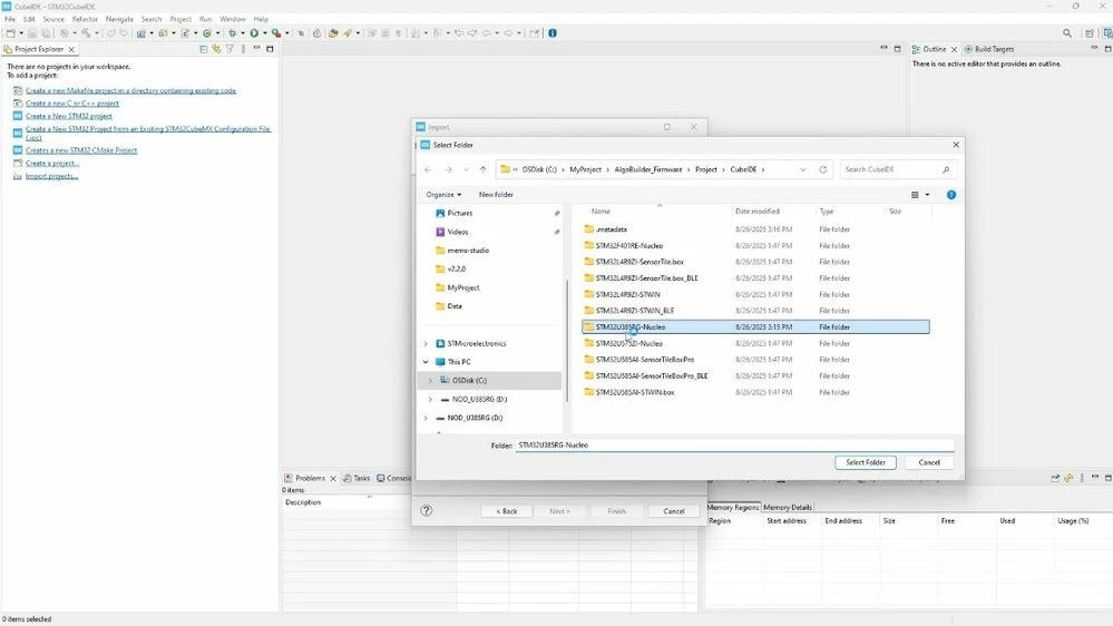

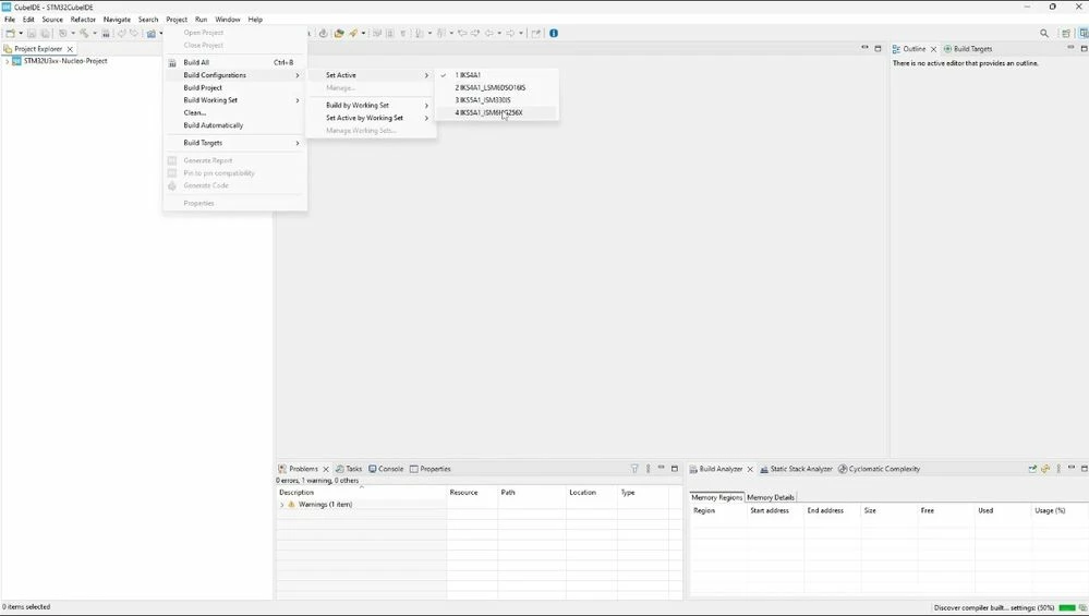

  • Or manually modifying the code generated by AlgoBuilder by opening the project with STM32CubeIDE.

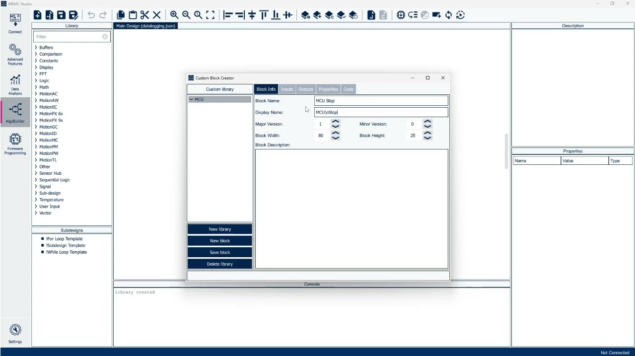

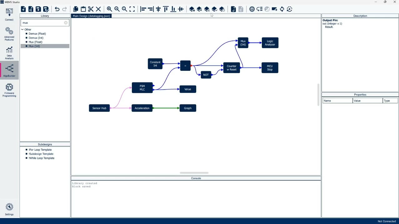

Back to the AlgoBuilder project, the stop mode is going to be introduced for the STM32U3.

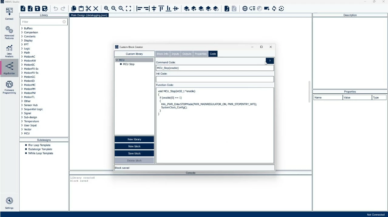

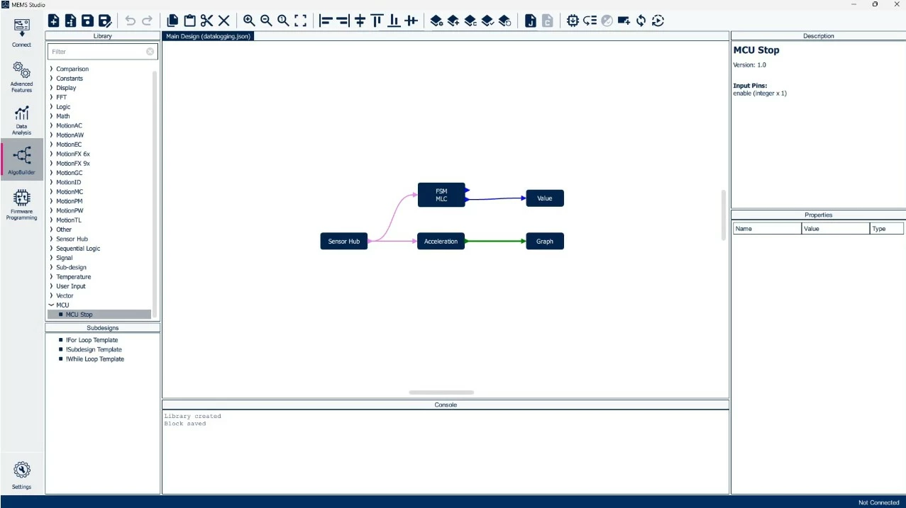

In AlgoBuilder you can create “Custom libraries” and “Custom blocks” to extend the functionality by your own code.
You can create a “Custom library” called “MCU”, and inside it a custom block called “MCU Stop”.
Figure 20: Create a “Custom library” called “MCU”, and inside it a custom block called “MCU Stop”Figure 20: Create a “Custom library” called “MCU”, and inside it a custom block called “MCU Stop”

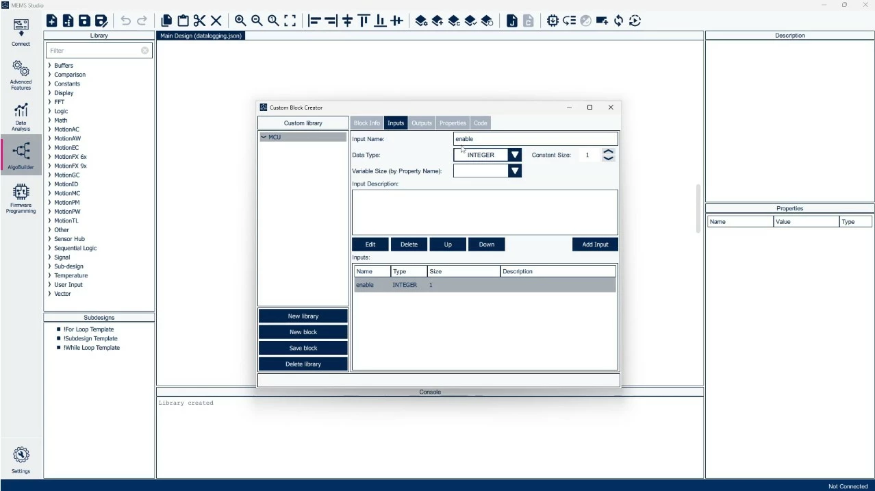

Then you need to set the required info, inputs, outputs, and the code to enable MCU stop, as shown in the following picture.
Figure 21: Set the required info, inputs, outputs, and the code to enable MCU stop blockFigure 21: Set the required info, inputs, outputs, and the code to enable MCU stop block
In this case, the function block has only one input to enable the stop mode, no output, and no property.
Simple C code can be written in the function block, to enable stop mode when the input of the function block is equal to 1 and recover clock settings after waking up.
Figure 22: Simple C code can be put in the function block, to enable stop modeFigure 22: Simple C code can be put in the function block, to enable stop mode
Once the block is created, it will appear in the MCU library as MCU Stop.
Figure 23: The MCU stop block appears inside the MCU libraryFigure 23: The MCU stop block appears inside the MCU library
Before adding the MCU stop block, let’s add some condition to enable it.
We want to set the STM32U3 in stop mode when there is a stationary condition, which means that the package is still in an upright position.
The stationary condition is verified when the output of the machine learning core of the sensor has a constant value 0.
When this condition is verified, the MCU stop can be enabled.
In this project the stop mode is enabled when the stationary condition is verified for 10 seconds (corresponding to 300 counts at a 30 Hz data rate.)
In the project you can see also a “Logic Analyzer” block that has been added to show the different states and distinguish the MCU stop mode.
After rebuilding the project and flashing the new firmware to the STM32U3 on the Nucleo board, you are ready to test it.
Figure 24: The block tree is completedFigure 24: The block tree is completed
Let’s reconnect the board.
Then going to “AlgoBuilder Evaluation”, in the “Custom layout” of MEMS Studio, plots can be added for:
  • Acceleration data.
  • MLC state to check the output of the machine learning core.
  • And a logic analyzer to understand when the STM32U3 is in stop mode. When the MCU is in run mode the communication is active.
When the MLC state becomes 0, after 10 seconds the MCU is set to stop mode, and thus does not send any data to the application.
The machine learning core generates an interrupt every time the output value changes.
Moving the package causes the machine learning core in the sensor to detect a new state, which triggers an interrupt on the GPIO pin to wake up the microcontroller.
Figure 25: AlgoBuilder Evaluation - Custom layoutFigure 25: AlgoBuilder Evaluation - Custom layout

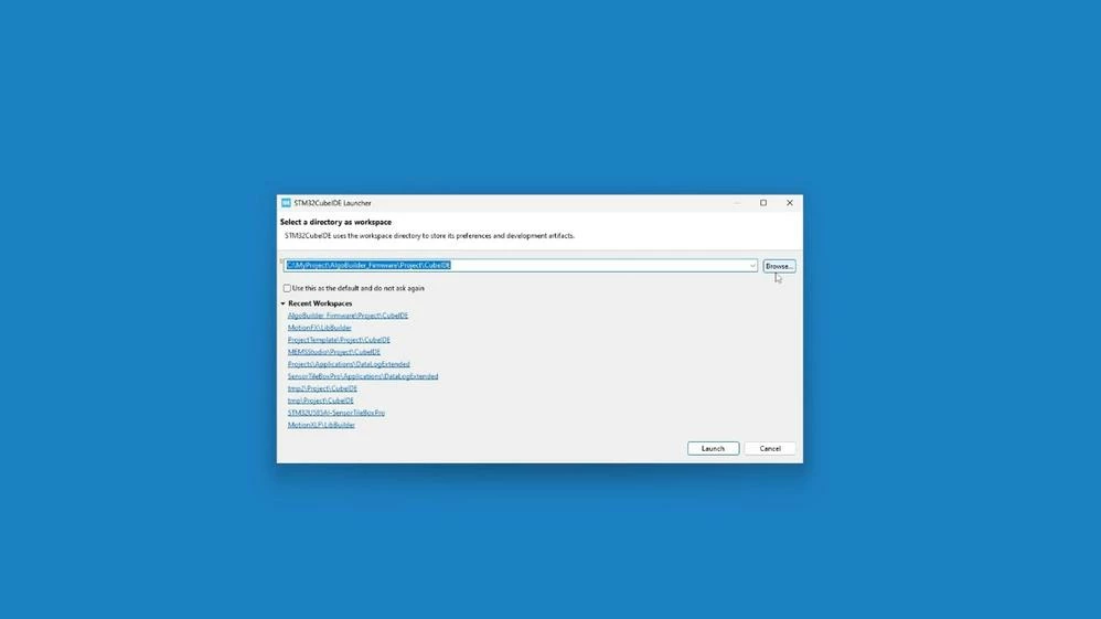

If you want to do further optimizations or modifications, you can still open the project with STM32CubeIDE.
To do this you need to:
  • Select the workspace to your firmware location.
Figure 26: Select the workspace to your firmware locationFigure 26: Select the workspace to your firmware location
  • Click on “Import project” to add an existing project into the workspace.
Figure 27: Import the project inside STM32CubeIDEFigure 27: Import the project inside STM32CubeIDE
  • Select the root directory to your STM32U3 firmware location.
Figure 28: Select root directory to your STM32U3 firmware locationFigure 28: Select root directory to your STM32U3 firmware location
  • Select the build configuration you want to use.
Figure 29: Select the build configuration you want to useFigure 29: Select the build configuration you want to use
