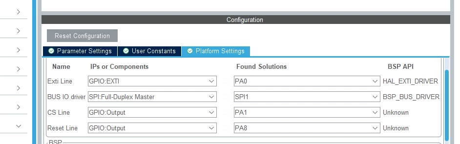

Hi, recently I got a X-NUCLEO-BNRG2A1 and I am trying to use it with NUCLEO-G070RB without success. I have created a project with STM32CubeMx assistance using SampleApp of X-CUBE-BLE2, mapping the pins of the expansion board to my nucleo board as follows:
RST - PA8
SPI_SCK - PA5
SPI_MOSI - PA7
SPI_MISO - PA6
CS - PA1
SPI_EXTI_IRQ - PA0

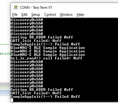

hi @PFuen.1​ did you resolved the issue? if yes can you help me out with the same. I too not able to even initiate the bnrg2a1, its getting stuck in one of the while loop after getting gatt init failed, bdarr failed.

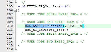

- You should check if "hci_tl_lowlevel_isr" is called in the external pin interrupt.

satyam9896
Dec 21, 2022 11:42 AM UTC
I'm attaching the ss for simpler changes which you said . i just wanted to know regarding hci_tl_lowlevel_isr that it is correct ay to call ?0693W00000WLX1gQAH.png

satyam9896
Dec 21, 2022 12:06 PM UTC
