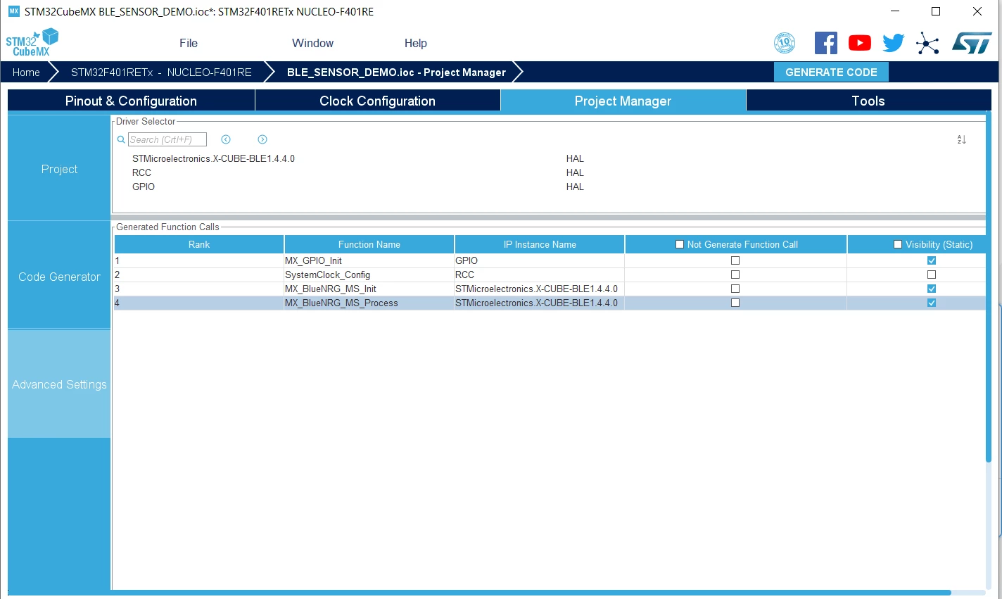

andreaspiezia9
Aug 14, 2019 5:49 PM UTC
Hi Antonio,
Thanks a lot for sharing the app note.
I've followed the step for SensorDemo application on Nucleo-F401RETx
6.2 Use of Expansion Software with sample applications
and all it's ok till the Advanced Settings tab config (fig 18) becouse in my CubeMX USART2 doesn't appear (see attached picture).
Do you have an idea why I don't see USART2 in my Advanced Setting tab?
Thank you very much.
I'using CubeMX 5.1.0 and X-CUBE-BLE1.4.4.0

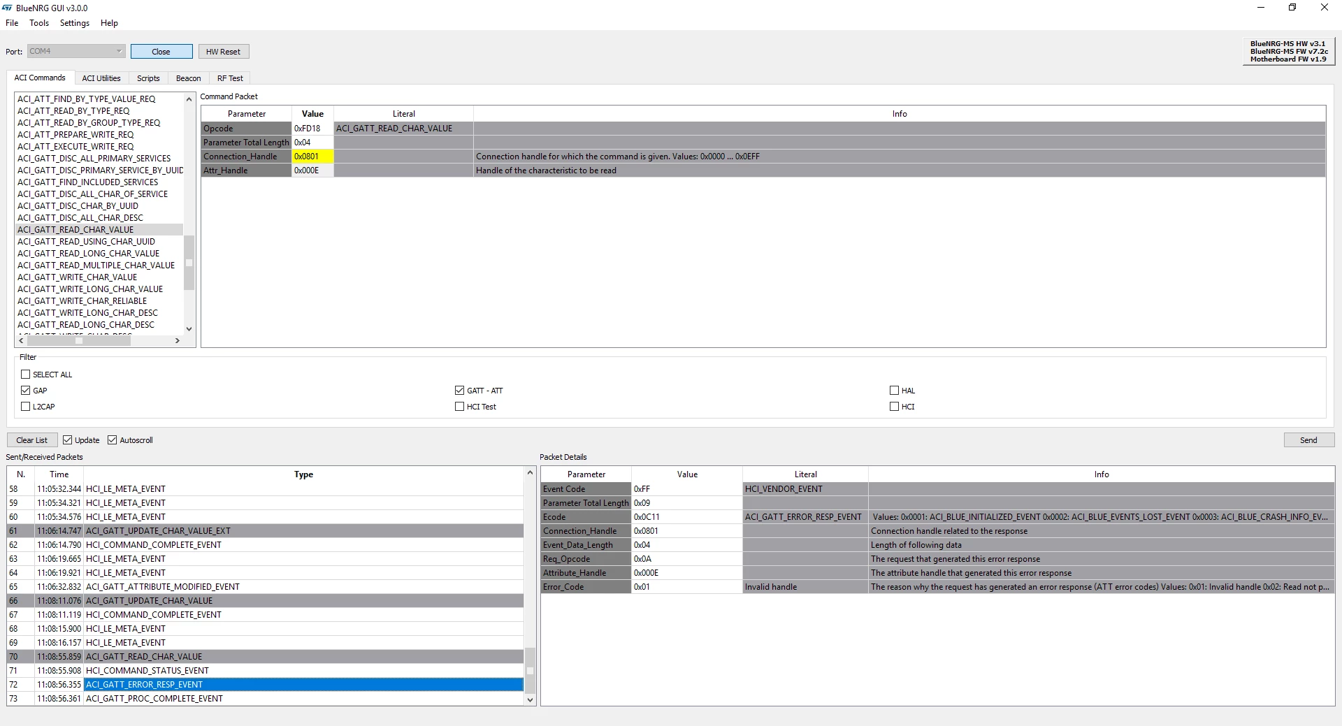

Oct 1, 2018 9:42 AM UTC
I connected the board with the app and send data from the board to the smartphone. I work with the BlueNRG GUI and that is running. Now I want to send data from the smartphone to the board and read it. Unfortunately a error is generating. I attached a screenshot where you can see it. I think the connection handle and the attr_handle are correct. The uuid from service and characteristic are 128 bit long, so they are unique. I tried following commands but the errors are the same:
ACI_GATT_READ_CHAR_VALUE
ACI_GATT_READ_USING_CHAR_UUID
ACI_READ_HANDLE_VALUE
