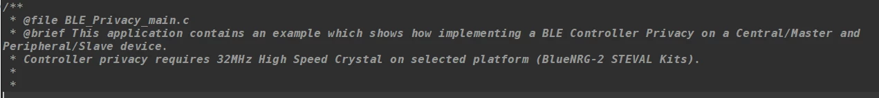

I noticed that Controller privacy requires 32MHz High Speed Crystal in BlueNRG-1_2 DK 3.2.3\Project\BLE_Examples\BLE_Privacy\src\BLE_Privacy_main.c, but I don't find any document about this.
Meanwhile, my platform has 16M high speed crystal, I modify HS_SPEED_XTAL_32MHZ to HS_SPEED_XTAL_16MHZ then flash this demo and can't scan the bluenrg1 device(the demo has name "pslave"). is there any workaround so that I can use Controller privacy with 16M high speed crystal?

This is right, privacy requires 32MHz xtal as more PIPS are required.
A 32MHz xtal is mandatory for such application. No workaround.

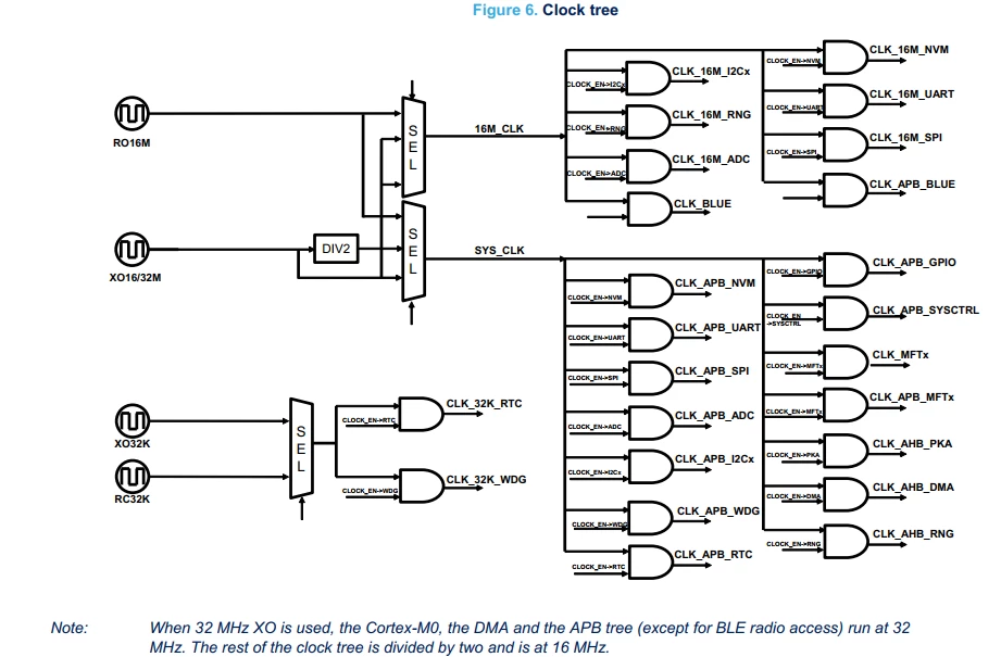

accroding to following clock tree, 32M XO can be devided with 2. Do you mean even if I use 32M XO then devided with 2, ADC and Controller privacy still can't work together?
meanwhile, Is there any method that I can enable bonding with 16M XO? I can't enable bonding using BlueNRG1 and android 13. Attachment is my code.
