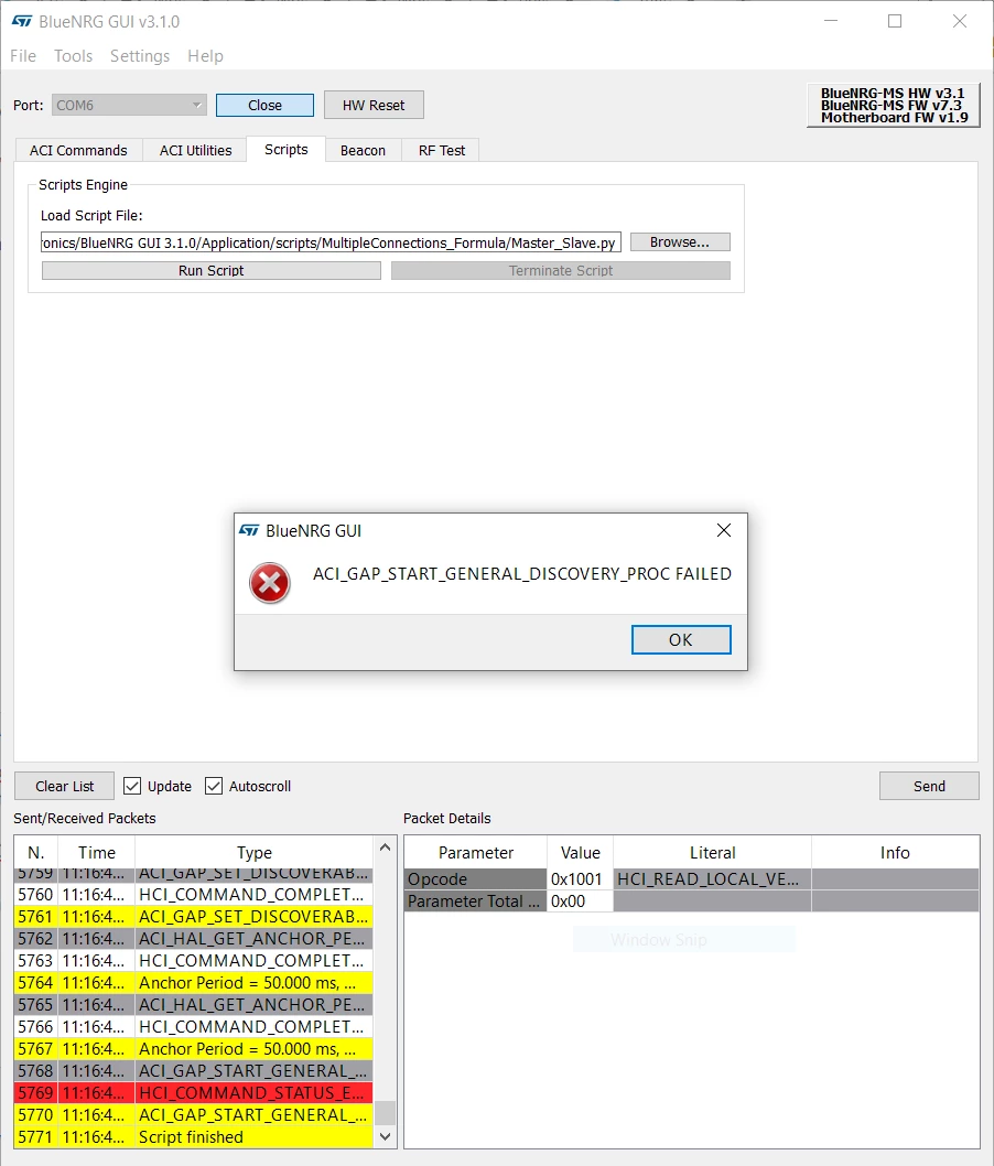

    I've discovered that there is a python script "C:/Program Files (x86)/STMicroelectronics/BlueNRG GUI 3.1.0/Application/scripts/MultipleConnections_Formula/Master_Slave.py" that seems to show exactly what I want to achieve.
    I found it because of this thread: https://community.st.com/s/question/0D50X0000B0vWmG/spbtle1s-connected-with-android-app-and-other-ble-device-on-same-time
    Unfortunately this script is not able to run successfully on my F401RE devkit, see attached error message.
    At the prompts I'm specifying: '2' masters, '0' slaves, '20' ms scan interval and '0' sleep time. I've tried it in stack modes 2, 3 and 4 (specified in "ACI Utilities --> Init Device").
    I think the reason for failing might be because the script is meant for BlueNRG-1 and 2, not the MS, but shouldn't MS be capable of the same as 1 and 2?

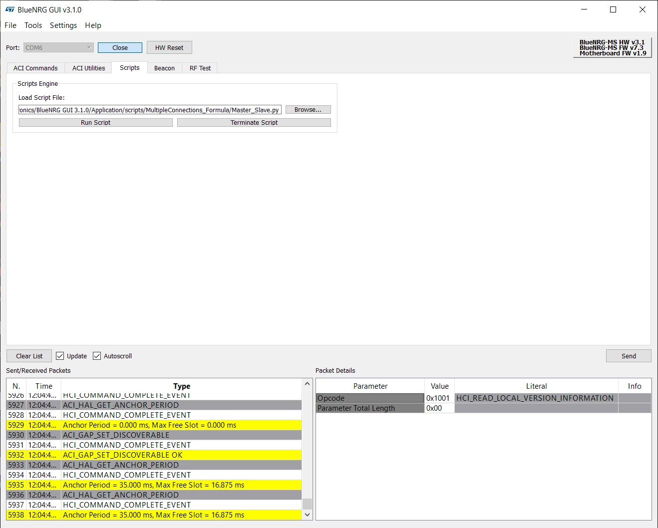

    Small update:
    I can uncomment these lines
    --- line 346 ---
     status = ACI_GAP_START_GENERAL_DISCOVERY_PROC(LE_Scan_Interval=Scan_Interval,
     LE_Scan_Window=Scan_Window)
    --- line 358 ---
    ## Starts discovery procedure
    if status!= 0x00:
     ERROR('ACI_GAP_START_GENERAL_DISCOVERY_PROC FAILED')
    else:
     disc_procedure_is_ongoing = True
    in the script file to make it run without the exception (basically making sure it doesn't check for or enter scanning mode, since I'm not interested in that anyway). This makes it respond with ACI_GAP_SET_DISCOVERABLE OK, but the device remains undiscoverable... See attached image. What do?
