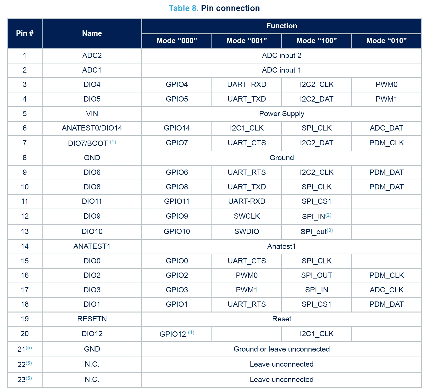

What Mode is the BLUENRG-M2SP module in when its comes from the factory?
We transitioned from BLUENRG-M0L to BLUENRG-M2SP. We did some basic application testing with the X-NUCLEO-BNRG2A1 platform, and we had the example application up and running seamlessly.
However, we’ve encountered an issue when integrating the BLUENRG-M2SP with our existing boards. I’m having trouble running the example application. The module and the main controller talk via SPI. While going through the data sheet, I discovered that the BLUENRG-M2SP module must be in Mode “100” pin configuration to be able to talk via SPI with our main controller.
Question:
Does the module come in “MODE 100” out of the package or is this something we must do at our end.
Any clarity on the topic would help us a lot.

BlueNRG-M0 is a network processor module.
It means it is delivered with a FW directly by ST.
BlueNRG-M2 is based on BlueNRG-2 SoC. BlueNRG-M2 is shipped by ST without any FW (opposite to BlueNRG-M0). It means  you can run either your own application, either use it in network processor mode.
If willing to use it as application processor, you will have to flash a specific FW called DTM. This FW can be found in BlueNRG-2 SoC SDK (link below)
https://www.st.com/en/embedded-software/stsw-bluenrg1-dk.html
You will find for example DTM_SPI_NOUPDATER_M2SP.bin pre complied binary that you can direcltly flashed inside your BlueNRG -M2SP so that it will act as netwrok processor over SPI.
Then DTM source code is also available here and you'll see inside how SPI is defined with the mode you mention.

Quick correction on my part - we are using BLUENRG-M2SA.
We were using the BLUENRG-M0L prior to BLUENRG-M2SA. TheBLUENRG-M0L module came out of the package talking SPI with our controller. Our boards are not currently equipped with separate header to flash the BLUENRG-M2SA module with program.
Our requirement:
We were looking for a Bluetooth module in network processor mode so we just talk to the application and not have to write the Bluetooth application.
So here are my questions:
1) Can we order the BLUENRG-M2 in Mode "100" from ST? With the FW already flashed at an additional cost?
2) Do you have any other part in your product portfolio that has a BLE 5.2 that is readily available in network processor mode?
3) If we decide to go back to BLUENRG-M0L, what is EOL for the part. Our product EOL is 10+ years. So we want to make a conscious choice on what we are picking.
Looking forward to hear from you.
Regards

Hello Laurent LOUAZON,
Thank you for the response. We are going to be try and add a header on the PCB to be able to program BLUENRG2 module.
I am trying to mock up a header to test this on our board before we do PCB changes. I have a quick question - do we need the reset line to be connected or is it enough to just have VDD, GND, CLK and SWDIO?
I am kind of new at this, I'm not sure what the STLINK does when flashing.
Thank you for all your support
Regards
Laurent LOUAZON
Apr 9, 2024 7:02 AM UTC
This is recommended to have reset pin.
Also note having an access to DIO7 can be useful. If a low power application is running inside BlueNRG-2/BlueNRG-M2,  DIO7 is needed to force bootloader (set DIO7 high before power on) and ensure SWD can be used.
See AN4872
No needed at first flash considering BlueNRG-M2 is not having any FW flashed.
