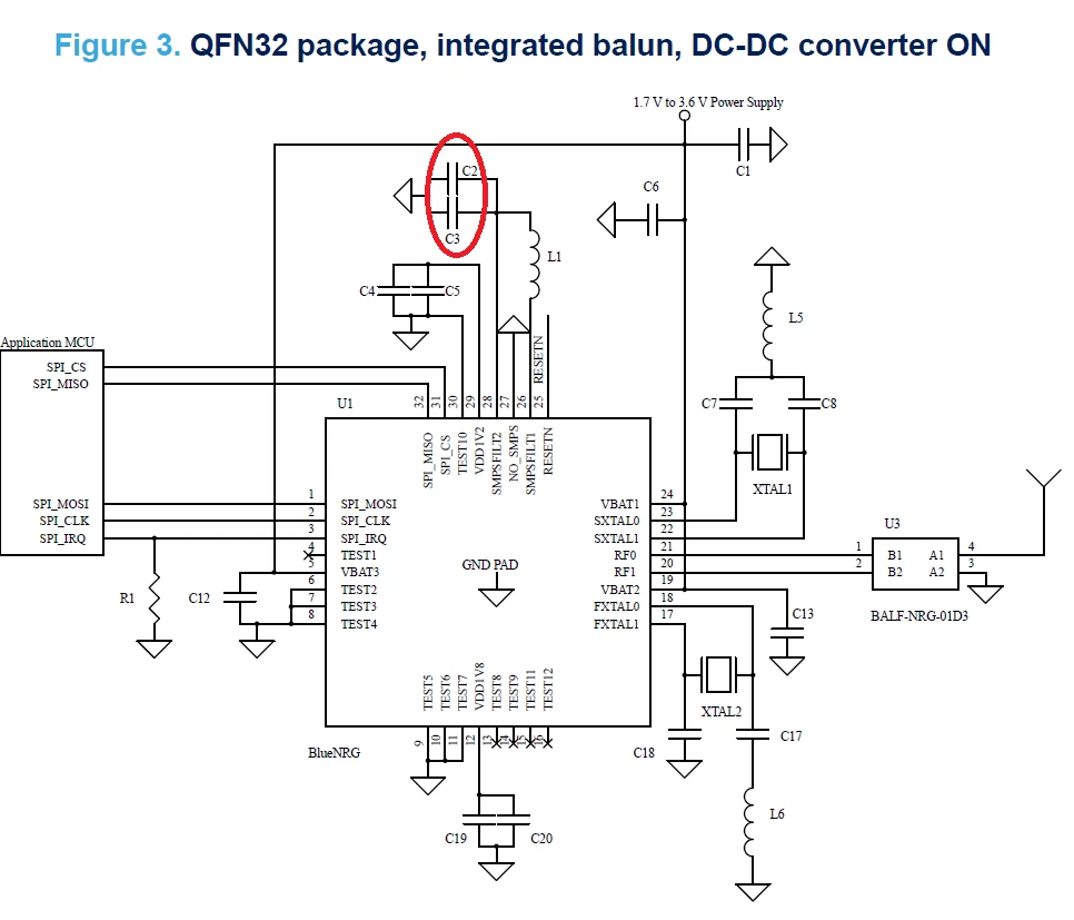

What are the recommended Filtering Capacitors for the BlueNRG?

I have also been searching for this information. The datasheet does not have it and I cant find it in any application notes.

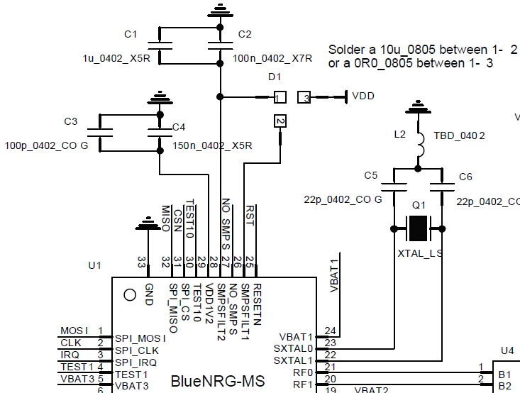

1uF and 100nF for the filtering capacitors.

Thanks, for the quick reply. Where did you find this information? What document?
Winfred LU
Jan 27, 2021 2:26 AM UTC
Data brief for STEVAL-IDB005V1 daughterboard.
Link below:
DB2585 Bluetooth low energy board based on the BlueNRG-MS network processor
