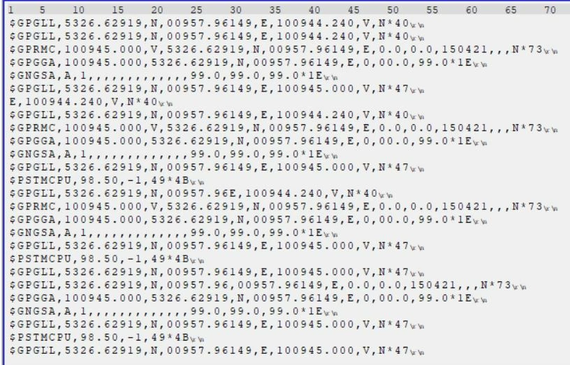

Using AEK-COM-GNSST31 board with the Teseo Liv3f GPS on. I have successfully accessed the data from the gps but I want to recieve only $GPGGA, $GPGLL and $GPRMC messages. How do I do this ?
I tried using the $PSTMNMEAREQUEST command setting only the bits for the 3 messages but I am still getting the periodic messages.
Thanks in Advance!

    Yes, the device is definitely responsive because it prints my requests and other data as seen in the photos below. Wiring, UART and checksumm are I suppose and CR,LF also present.
    • For checksumm I am using an online NMEA checksumm calculator.
    • Commands in my code are like this - for the GPGLL msg "$PSTMNMEAREQUEST,0x100000,0x0*7D\r\n"
    Here is the output of my code

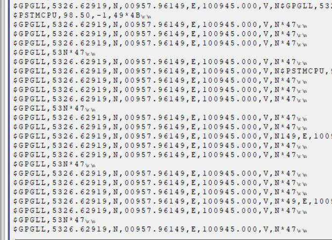

    0693W000008zfhUQAQ.jpgAs you can see it is responsive and the GPGLL is printed upon request, but every period it gives a lot of other data like in the next photo.
    Is there a way/command to stop any other message except the requested ones ?
    Thanks !
    Your buffering of the USART data appears borked.
    Shouldn't be missing characters and lines randomly.
    Perhaps implement an IRQ based buffering scheme, rather than polled, and have a deep enough buffer.
    Copy the data out of the live buffer (changing under IRQ) if you're storing a line at a time.
    G. Michael
    Apr 16, 2021 2:51 PM UTC
    Thank you for your help,
    I adjusted the buffer and the messages are not being Cut randomly.
    I solved the issue with the specific messages using the $PSTMCFGMSGL instead of $PSTMNMEAREQUEST.
