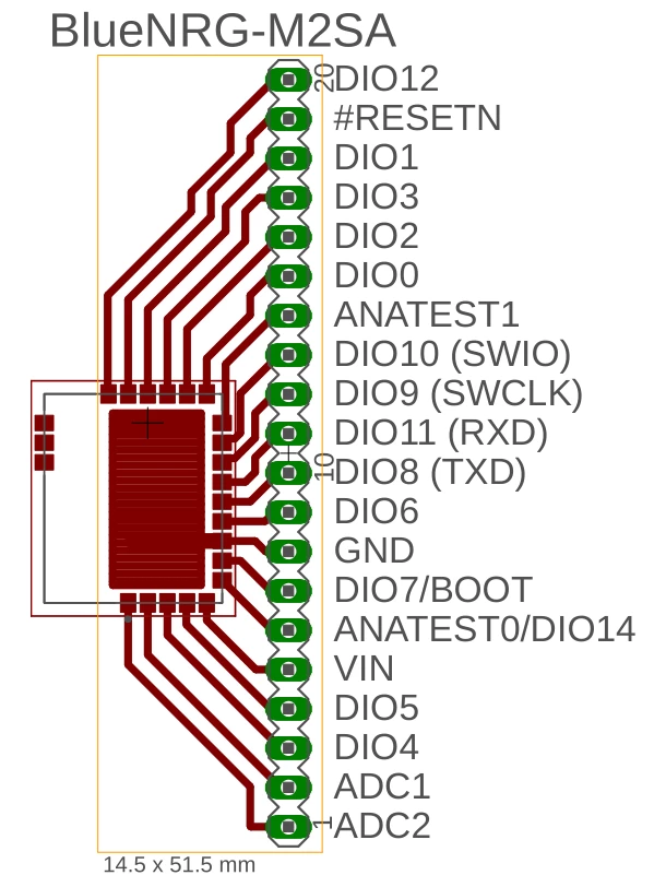

Hello, I would like to ask you for help with programming and debugging the BlueNRG-M2SA module.
I am just not able to get started and successfully connect to the module using ST-Link v2 over SWD. Neither using USB-UART chip (PL2303SA) to communicate with embedded bootloader.
I prepared this adaptor to DIP for the module to make it easier for breadboard tests:
When I try to connect to the target using BlueNRG-1 ST-Link Utility, after checking that VIN, GND, SWDIO, SWDCLK and #RESETN pins are connected correctly, I get this error messages in the trace.log file:

vrba.vojtech
January 12, 2020
I managed to get ST-Link working. The problem was I was using cheap chinese USB ST-Link, which didn't communicate with the module for whatever reason. I tried embedded ST-Link in Nucleo-F303RE and STM32F4-Discovery kit, both are working.
But the bootloader over UART isn't working anyway.
HGonz.1
Visitor II
April 24, 2020
I see in the BlueNRG-M2SA datasheet (DS13053) that the pin 21 has to be tied to GND, but the guidelines also recomend to place the antenna outside the main PCB, as you do in the development board X-NUCLEO-BNRG2A1 with the BLUENRG_M2SP. And I see that other products such as the SensiBLE 2.1 with the BlueNRG-M2SA module place it outside the PCB, leaving the pin 21 unconnected.
I am curious, did you solve the problem?
Thank you.
vrba.vojtech
May 8, 2020
​Hello, I haven't got the bootloader working. The pin 21 is internally connected with GND and the metal shielding, so I guess it can be left unconnected.
So I use the ST-Link solution with BlueNRG-1 ST-Link Utility (because flashing directly from Keil uVision also doesn't work for me).
