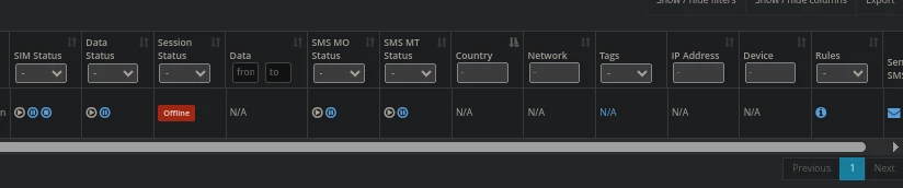

And at the truphone website sim managment section i see my sim status is offline. explain me what is that and how to i activate to it. i share to my screeen shot of that page.
Could you please assist me in diagnosing and resolving this issue?

I just want to clarify that my main goal is to understand whether there are any specific configuration steps needed to get the ST4SIM-200M eSIM working with the nRF9151 DK board and to connect to the network.
As I mentioned earlier, the eSIM is already activated — I’ve shared a screenshot from the Truphone portal showing successful activation.

Visitor II
Jul 21, 2025 1:17 PM UTC
Dear manoj_42,
I'm experiencing the same issue. When I run:
AT+CSQ +CSQ: 99,99
I get no signal.
I've already registered my eSIM at truphone.com, but still no network connection — even after testing with two separate boards and two different (BC660 and EC-01F) modems.
How did you manage to solve this problem? Any suggestions would be appreciated.
