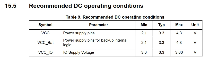

I would like to connect a TESEO LIV3F to an STM32 MCU that is powered using a 2.4v supply.
Im wondering if I can drive TESEO's Vcc_io with a 2.4v supply or if I should use a 3.3v according to the datasheet and put a level shifter between them both.
The first option is far the best for me ...

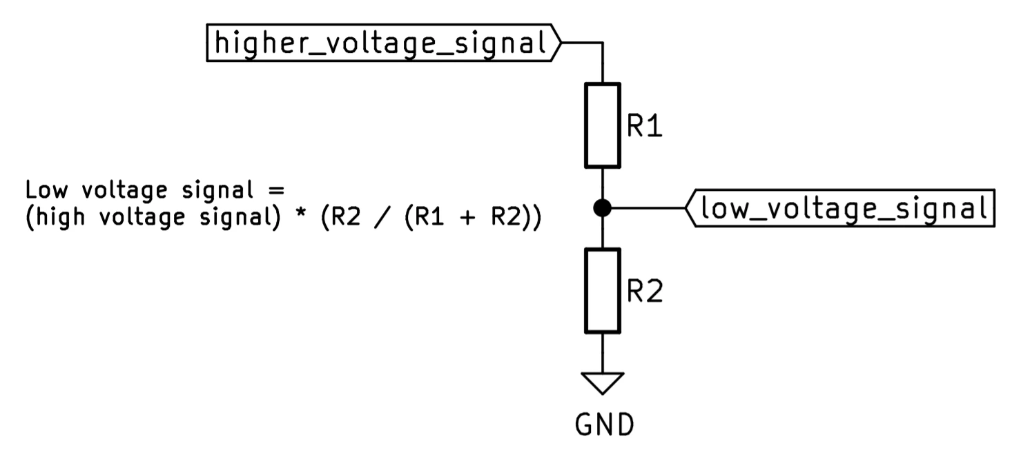

E0658944_level_shift_uartE0658944_level_shift_divider
Image sources: https://www.okdo.com/project/level-shifting/
AO3400 Gate Threshold Voltage: 1.45V and AO3401 Gate Threshold Voltage: 1.3V

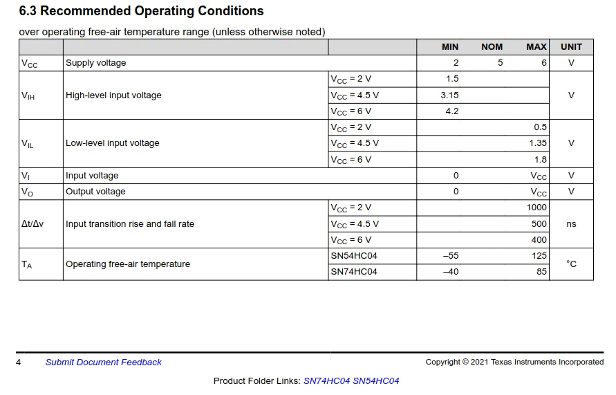

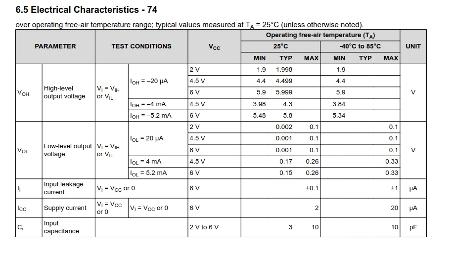

In fact, in the recommendations there is a different power range for the VCC_IO.
Manufacturers usually inform the values of VIH, VIL and VOH, VOL so that the user can confirm whether it will be possible to meet the parameters, but I did not find this, really weird. For example a datasheet of SN74HC04:

Thanks for your reply,
Since it's the same technology than the STM32, I assume that, for the TESEO LIV3F, the minimum voltage for HIGH level is 3.3 * 0.7 = 2.31V.
The STM32 that communicates with it outputs a voltage for HIGH lvl between 1.95v and 2.4v so It may not work sometimes.
I need to figure out if it's possible to connect it directly to 2.4v and operate the I/O pins correctly.

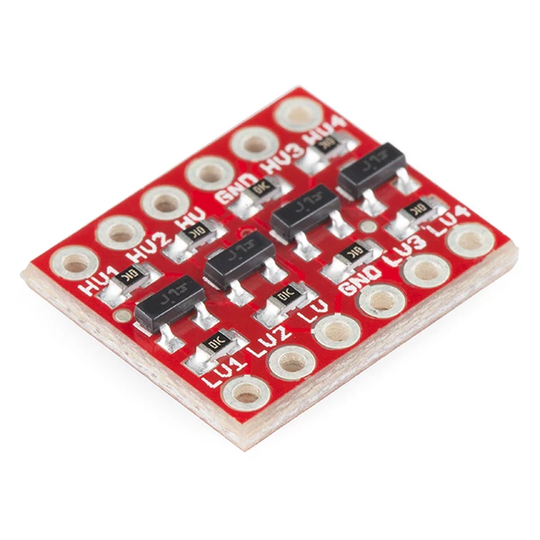

What type of data bus are you using? UART or I2C? It might be possible to implement the shift level using discrete components.
RhSilicon
RhSiliconBest answer
Lead
Jul 31, 2023 10:15 PM UTC
