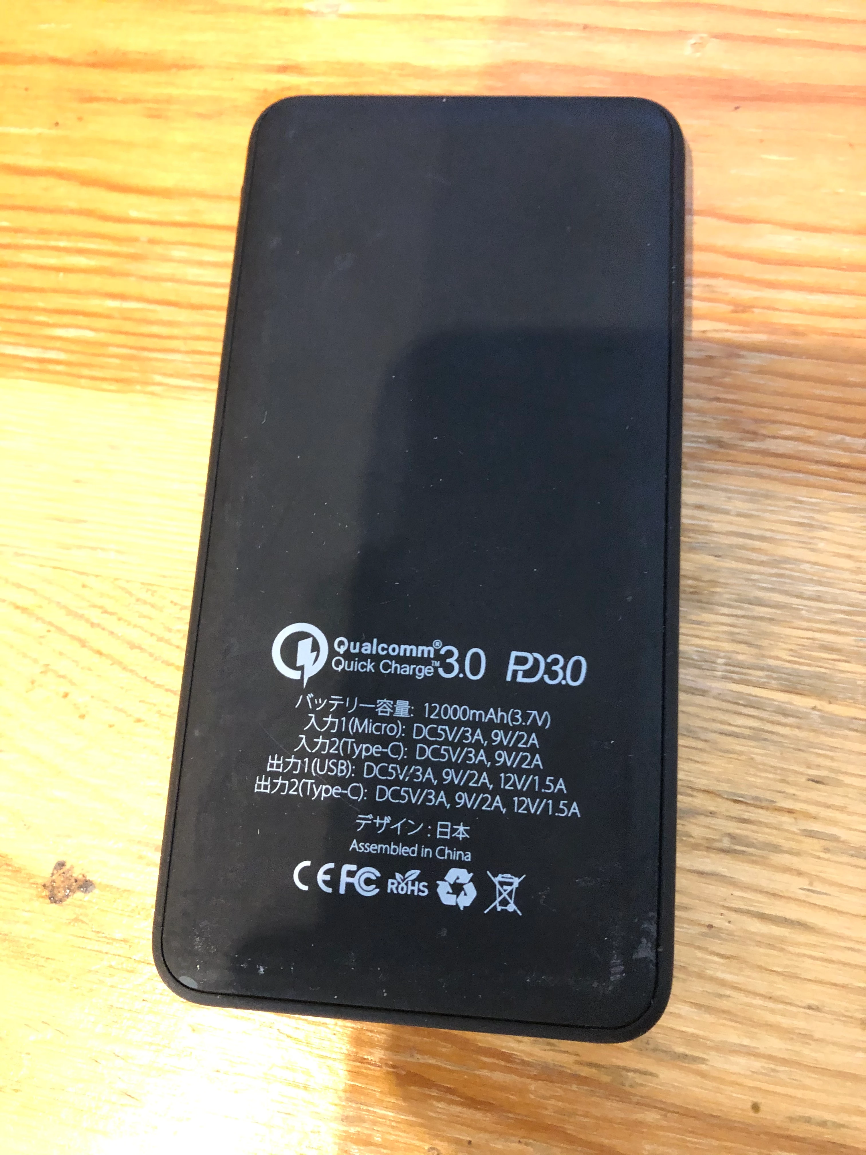

    Leo Tai
    Leo TaiAuthor
    Jan 17, 2020 3:30 AM UTC
    The above photo is the PD power bank I am using for testing. It support 9V/2A, 12V/1.5A. I tried to configure it to have 20V/1.5A, 12V/1.5A. The 12V/1.5A should be a valid PDO.

    Gregory Go.
    Senior III
    Jan 17, 2020 11:00 PM UTC
    Indeed the 12V profile should work with this power source.
    But this power source cannot provide the 20V profile.

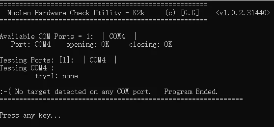

    Leo Tai
    Leo TaiAuthor
    Jan 18, 2020 8:12 AM UTC
    Hi, I used the new version of the GUI. It still cannot find the board. I used the HwCheckUtility.exe. The output log is capture in the above picture. Does it mean that there is a problem?

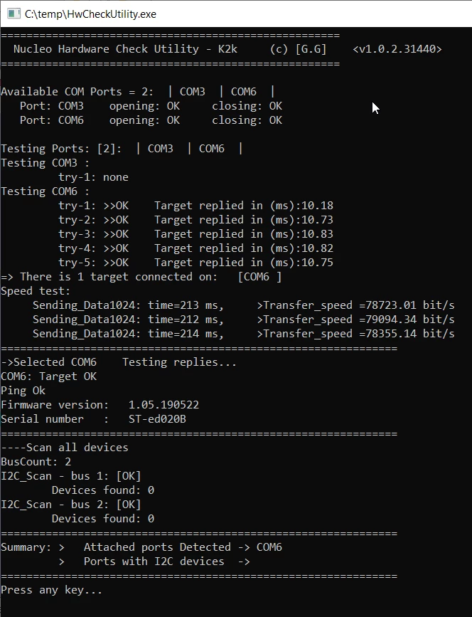

    Gregory Go.
    Senior III
    Jan 20, 2020 7:57 PM UTC
    The output of HwCheckUtility.exe shows that it cannot detect the Nucleo-Board. So there is indeed an issue.
    Even if the I2C chip is not connected, the utility should at least detect the Nucleo-Board.
    So it means the firmware is not flashed properly into the STM32 Nucleo-Board.
    When the firmware is running properly, the green LED (LD2) must be blinking.
    Here is an example of what you should get when the Nucleo board is detected:
